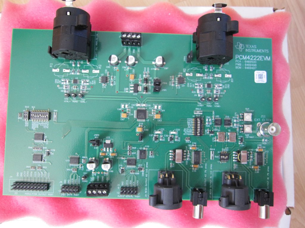

Oh cool. So, which ADC are you wanting to use? Did you want a separate thread for this? The PCM4222 looks great, but I'm not married to it...
http://www.ti.com/lit/ds/symlink/pcm4222.pdf
OPA1632 inputs looks good also.
I can help with a group buy or what ever.
AK5294A is what I' looking at.

The Audio Widget has most of what is needed. What remains to do is as follows:
1) use the USB module from Q N K T C USB-I2S Module and Analog Board
2) add ADC to the DAC (upgrade the DAC if needed)
3) add I2S isolation
4) add power supplies, not enough available from USB for this
I have worked out a number of the pieces and some is already in Borge's schematics. The rest is not really hard. Win interface would come from the ASIO effort, which would need an extension to work.
I must resist taking on this layout project for now. I'm too overbooked already. But I would be happy to provide the schematic pieces to assemble it.

The Emu 0404 uses the AK5394a, the best currently available DAC. The implementation needs help for measurements. And a well tuned clean system to work. It just barely works at 192KHz sample rate.
The XMOS driver is closed and expensive. The Via stuff doesn't work right yet. I'll look into the Amanero. The CMEDIA CM6631 works but is not really a DIY project either with NDA's around the firmware and driver.
The SDR Widget is already mostly done for what we are discussing.
Borge may be interested in making a board or device if we can get 40-50 people interested. Or you could buy a Lynx Hilo. . .

The akm is one of the best sigma-delta ADC, but is not really usable above 50khz.
A 18 bit r2r one would be more optimal if starting from scratch.
But I'm well fine as a start with improved emu or qa400.
You surely know more than me about driver status for usage in a custom project.
I have seen the via used in USB-i2s-spdif output interfaces and it is the best currently available jitter-wise. Do we care for jitter? Probably not. I'm curious to learn what problems there are with drivers.
Amanero could make some custom boards if the numbers are fine as he should be grateful to this forum for the many boards sold (i think close to 300).
The drivers are good, firmware is updated quick and the support is also great.
I2s is not isolated and we want to add that for an ADC.
The free asio driver for windows is utter crap, I wouldn't touch it with a 3ft pole.
E-mu drivers are gold compared to that.
