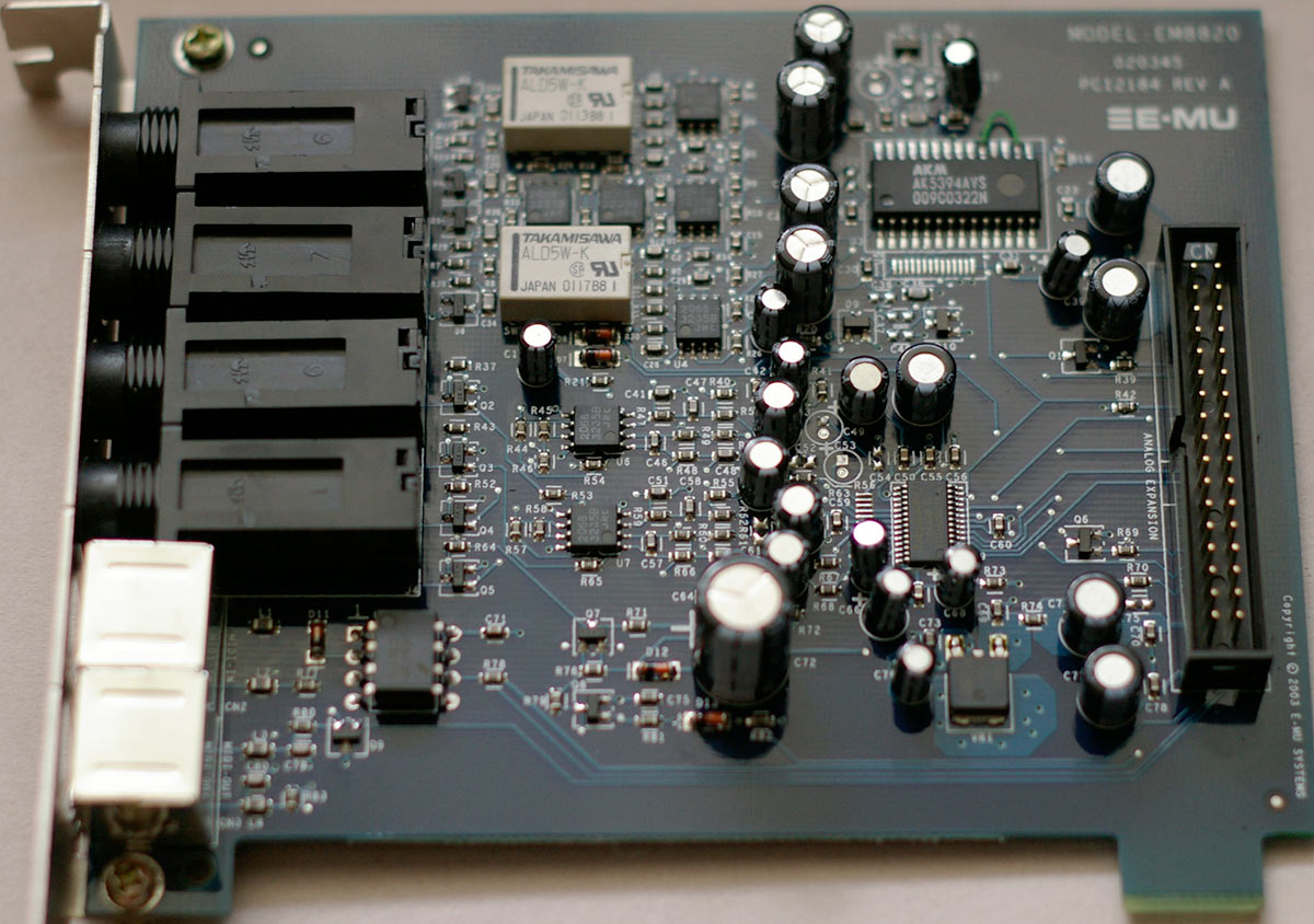

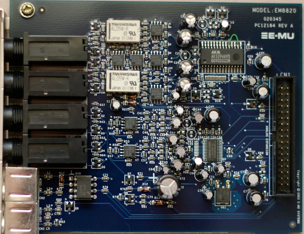

The problem was 1 broken muting transistor, for the channel that had lover output level.
The problem is solved simply with removing the transistor from the board. Nothing on the board is changed, so, finding a new transistors and soldering them to the board is possible.
There are some reports that removing muting transistors may positively impact the sound, so I removed all 4 output transistors (this is also considered as a mod for the card).
The other side of removing these transistors is slight "pop" on powering ON and OFF the PC, if the amplifier is turned ON.
The muting transistors are the transistors on the last photo I posted.
