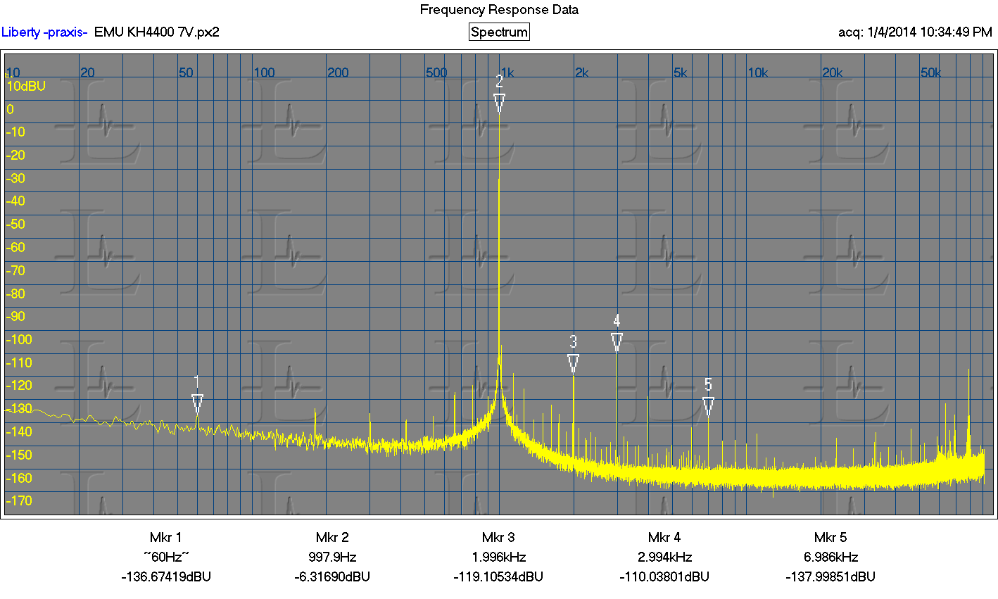

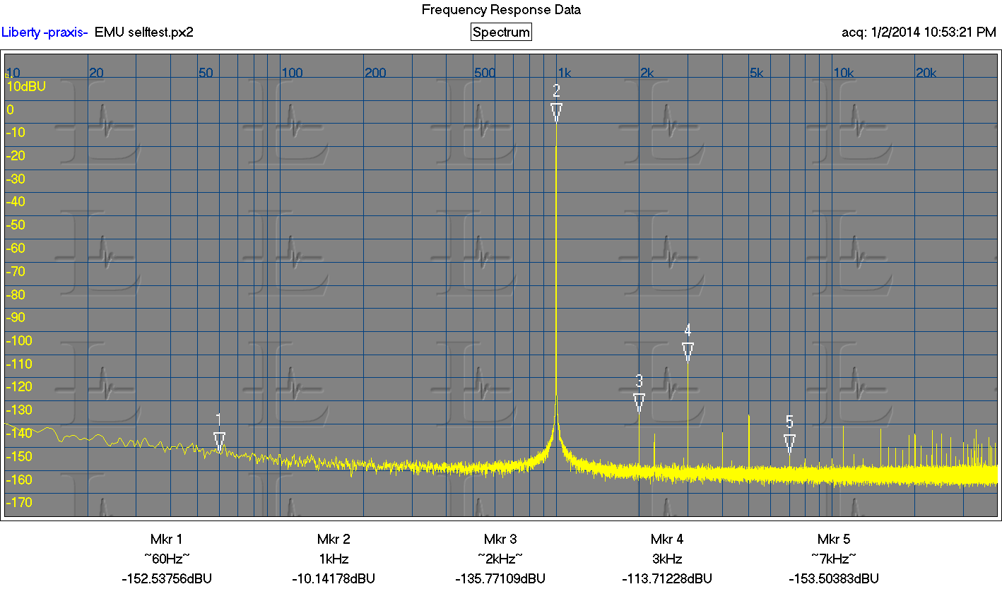

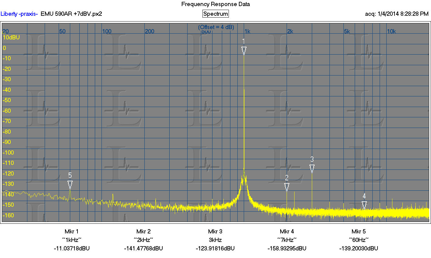

I just got an EMU 1212M for measurement purposes because it uses the AK5394A ADC. Here are some essential as received measurements.
They are all made in balanced mode at +4 level setting.
The performance is quite good but not as good as I get from the demo board.
The Third harmonic is exceptionally high. That is also high on the DAC as well. My guess is the odd JRC2058 opamps. They look like they are from an earlier technology node (to use the IC industry jargon).
Next step (after CES) will be to replace the JRC opamps with LME49720's to match what I'm using on the demo board. I'll document the process.
The drivers seem problematic. The Win XP system was really stable before I installed the card and has been locking up intermittently ever since. For my purposes the DSP manager interface is also very much in the way. Learning curve ahead.

I am getting very good results. Swapping the opamps may get the 3rd harmonic down a bunch. The LME49720's are cheap and worth a try.

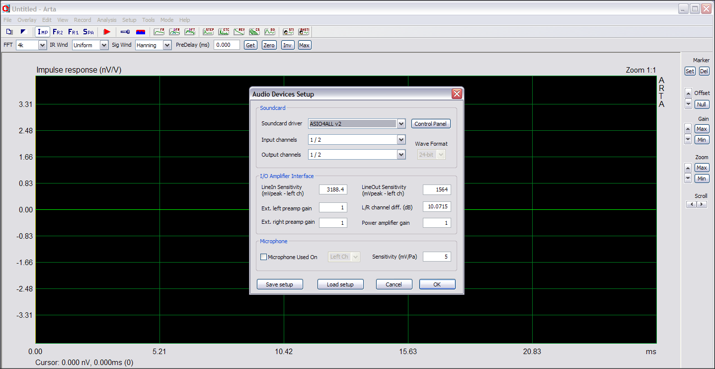

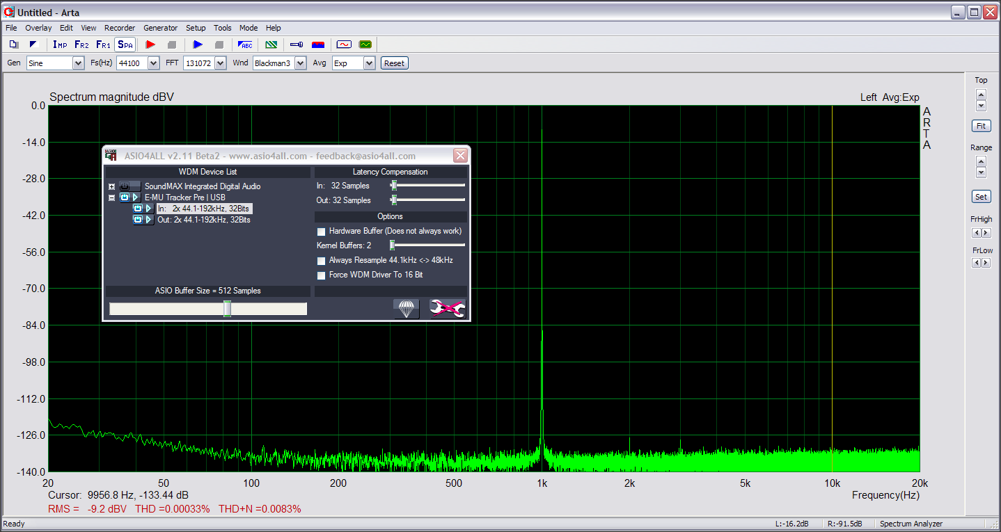

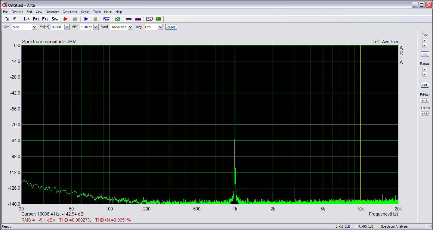

Asio4all works for my EMU Tracker Pre, but loses performance vs. WDM. Pictures are on XP. Alas, Win7 is a problem for any original Tracker's drivers.
So A4all comes to the rescue. Can you explain why it loses SNR performance on A4ALL by not supporting 48k? Skips some hardware bits maybe? Any better settings to propose on A4all for SNR?
I like the Tracker bcs very portable and I can use it with any measurement software. I think I can't do that with a QA400 which I would get for backup or just to have it installed ready for use on the bench when the EMU could be in the tools case. But it only runs on custom SW, right?

The noise may be some resampling in the background. I have a Tracker pre and a 0404. I have been able to make some complex acoustical measurements with them. Its the usual 1 day of prep and debug and 30 seconds for the measurement (ground plane frequency response of a speaker).

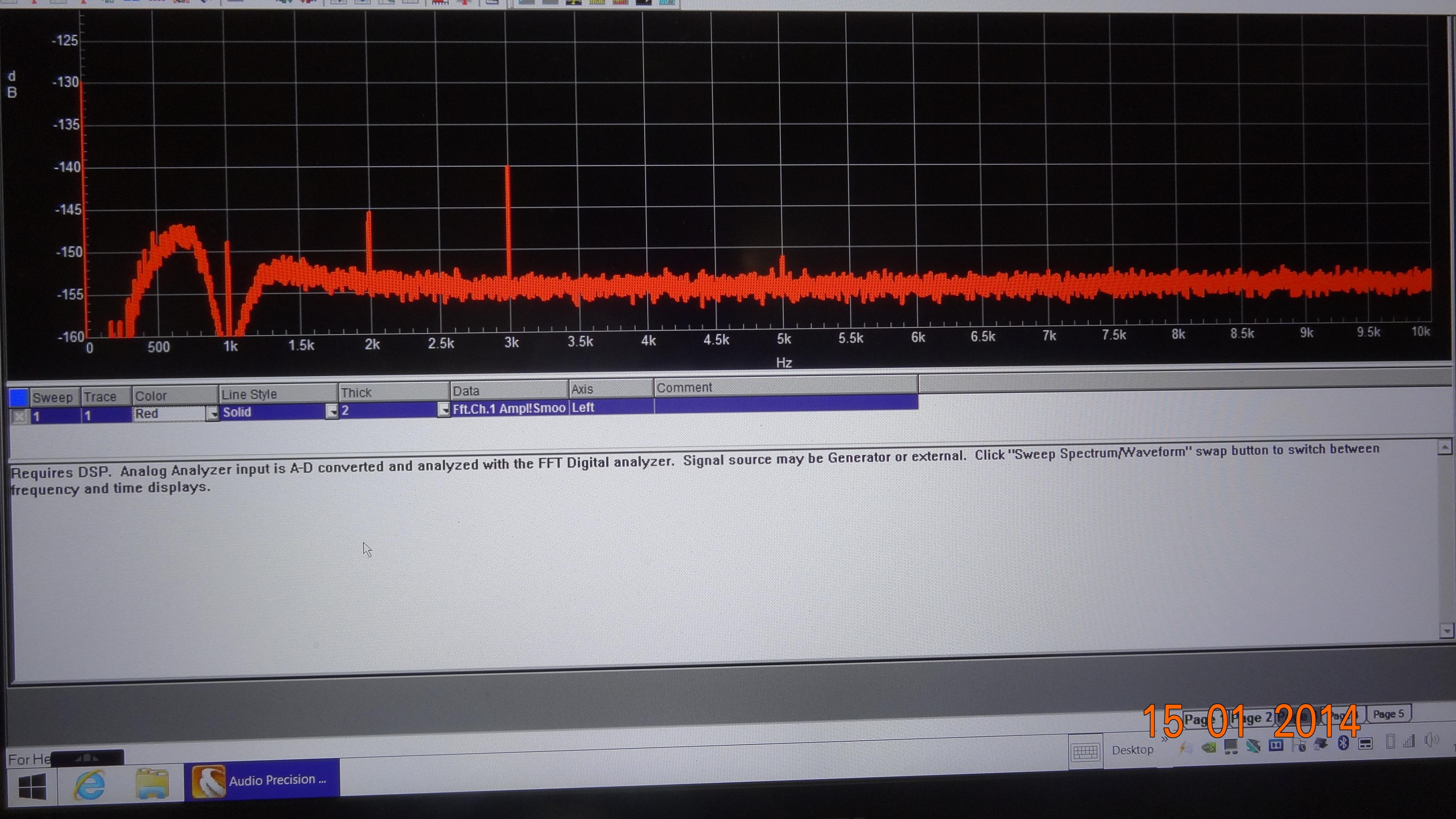

How accurate is the data near and below -100dB?? Same question to Salas, Chris.... and others with sound cards et al.
Here is ref. AP-2722
