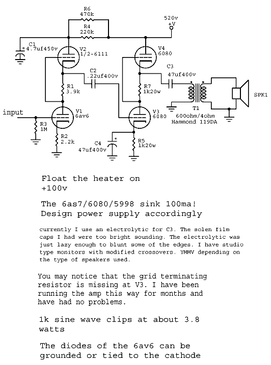

I have a FULL SRPP power amp! It has an input stage made up of 6av6 and a 6111 stacked on top of that. The output power tubes are SRPP 5998. This is by far a more authoritative sound than most amps out there. The only better thing than this is a big transmitter tube based unit such as SRPP 7403 or the like.
Take a look at the reviews of the VIPRE mic preamp. This is Mu-follower madness.
Stacked tube topologies have authority to there sound that is rarely matched, when done with the correct tubes.
I'd be interested in seeing a schematic if you can post it, or alternatively via email.
Cheers
frugal-phile™

And here is Robert's amp for all:

fdegrove said:
Robert,
I assume you lifted the heaters of the top half 6080 with respect to groung?
This sure looks like an interesting amp and reminds me of the Philips OTL.
Cheers,;)
I have all of the heaters running on one filament transformer. The 6as7 can take 300v plus or minus with respect to cathode. So a positive offset of 100v on the heater will keep the top 1/2 of the 6as7 happy along with the 6111.
Also an afterthought.
Either use a softstart B+ or don't power up the amp in a stand by mode ( use the filaments as a soft start) because the 6as7 will have a short life if B+ hits the tubes after filament warm-up.

TRUE
Actually that is valid for any tube,softstart is O.K but putting the out of standby does more damage than good.
Few people are aware of this.
I run monoblocks with 10 // 6AS7G that switched on directly.
It never caused any trouble since 15 years of use.
