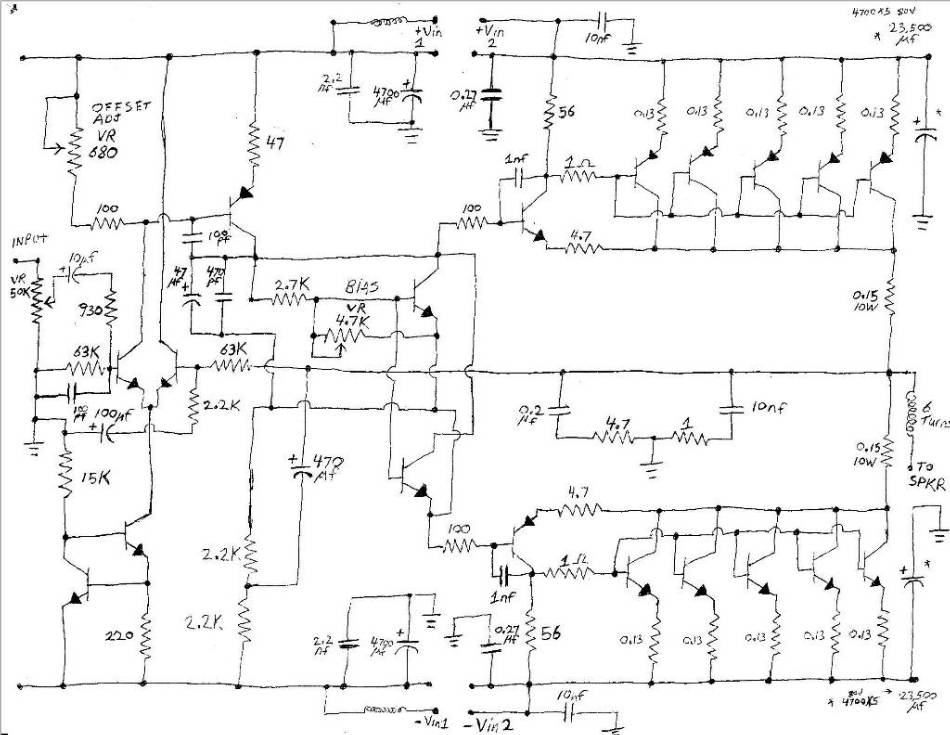

I have a question, being there's a lot of mixed views in here about the inductance of the wirewounds, and also you mentioned CFP.
My subwoofer amp I just built is CFP, but I'm using ceramic wirewounds because they are what I had, and are 0.15 ohm 10W which is perfect for a big amp with a 4 or 2 ohm load. Now while building this amp, I noticed I had stability issues when I didn't use resistors at all, but I changed that along with a few other things, and the amp seems really stable with the resistors. Haven't had any extra heat, or any biasing problems, and have run it to +/- 52V so for just testing.
Should I worry about having a CFP with ceramic wirewound output resistors, or is the low 0.15 ohm rating not going to make much inductance to worry about? Also, for the 10 outputs, they each have a compact, low inductance, wirewound 0.13 ohm 3W resistor, that's the size of a 1W film resistor.

AndrewT said:
Hi Eworkshop,
Why the extra RC leg in the Thiel network?
The parallel Vbe multipliers should not be nescesary unless you are monitoring two heatsinks. The voltage and therefore the power across the CE legs is very small and heating here is never a problem.
:D
The dual VBE is because I am monitoring 2 sinks, one for NPNs and one for PNPs. The bias doesn't change much once set, and is rather stable, hot or cold. I tested the amp at :hot: 350mA quiescent with +/- 52V and the sinks get hot, but the bias never runs away, or overcompensates. So far so good. I'll run it probably at around 100mA or less when finished.
Also, the extra 1 ohm resistor and 10nf cap in my Zobel is to bypass any other RF or HF signals that the other zobel may have missed. I want to make sure this thing never oscillates.

Hi EWorkshop,
nice idea a super vhf Thiel network. To make it effective the routing on the PCB MUST be low inductance (i.e. very short track lengths) and following those other replies the resistor must also be non inductive. A secondary function and some would say the most important function of the Thiel network is to attenuate RF signal coming back in through the output leads and entering the NFB loop striaght into the LTP amp. A second Zobel after the output inductor would assist this.
