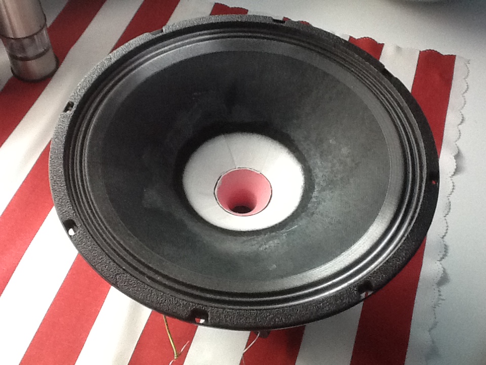

I have listened quickly using active crossover and only one speaker in mono. But there is one massive flaw with the Beta10CX that makes it non HI-FI in my opinion and that is that above 5kHz the on and off axis frequency responses are totally different! this is quite noticeable if you listen directly on axis with the speaker however over most listening situations the off axis response (thankfully) dominates. This apparently is due to a poor quality horn cone termination (big step). The 2.5KHz spike in the woofers response that looks huge on the data sheet is not much of a problem in reality.
Saying that everything else is good, the driver goes deep (40Hz) without needing an excessively big box, goes very loud, sounds quite nice and is one of the cheapest coaxials.
Designing a crossover was tricky! I ended up mainly using the off axis frequency response as this seems to be where to listen to the speaker and crossing 3rd order (accoustic) at 2KHz. Waiting on components to try this out.
I would hesitate to recommend this driver to those who are not specifically looking for a coaxial as I think that other coaxial drivers are going to be better (more even power response) but I don't know of anything apart from B&C and they are far too expensive.

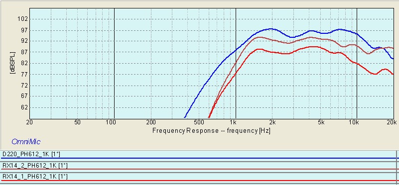

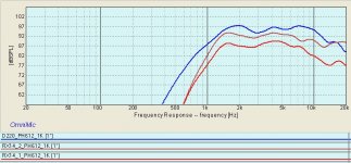

Just did some comparative tests on sensitivity. They are taken at much lower than 2.83V to preserve my sanity. Amplifier output is however constant for all three plots, so what we have is relative loudness. A Pyle PH612 horn was used throughout. Active crossover was set at 1kHz (18dB/oct).
The Red trace is my old RX14. The Brown trace is a brand new RX14 and the Blue trace is a new Selenium D220Ti.
Looks like the new RX14 is about 5dB louder than the old one. I don't really know why. Maybe it needs a new diaphragm. At least the responses of both of them are similar. I will be re-testing the my 10CX with the new RX14 for L-pads.
It's interesting to note the Selenium is even louder than the RX14. The response is also flatter from 1.5kHz - 10kHz.

I hoped that may be Peavey deliberately lowered the sensitivity for HF driver to match better with majority of woofers. But obviously that was just my wish. At least response is good when used with Beta 10CX. Inconsistency in sensitivity is irritating. I am interested in results with Selenium.
