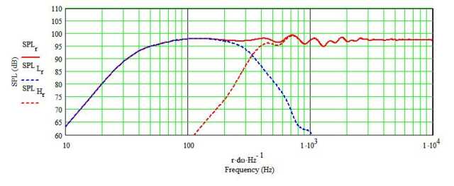

Here's the current state of my sim for two Jamo 20388's + Fe166E. The baffle is 25" x 40", low pass is 3.5 mH/0.36R + 250 uf, high pass 2 mH/1.18R + 33 uf. All three drivers centered 10" from the outside edge.
The bass rolls off a tad sooner than I see in MJK's Alpha 15/FE103 design, but more gently. Otherwise it looks pretty good to me. The bass won't be an issue if they wind up in the HT system with a sealed sub below 80 Hz.
Whether reality will match the sim, I'll know once I build them. That might be a while, I'm going in for surgery on my left eye next week, and that will have to heal before the sawdust can fly.
Any suggestions?

My guess - based on what I've done and seen - is that you are going to need a bigger inductor. But that really depends on what the actual Qts of the driver comes out to. I had my doubts about the published specs. The lower the Q, the bigger the inductor you'll need to get a good balance.

For information, these are the results of a quick study I did over the past couple of days comparing the Dayton and the Eminence drivers. I used John's preliminary baffle size (wings assumed to add width to the baffle) and a large series inductior for the Dayton drivers. For the Eminence, I used my standard 2nd order low pass filter. I assumed that Fostex drivers made up the rest of the system.
http://www.quarter-wave.com/Study_Results.pdf
Note, for the single Eminence driver case I increased the input to 2 watts so the system SPL curves achieved the same dB level on the first page. This was only done for the one plot. Everything else uses 1 W input.
