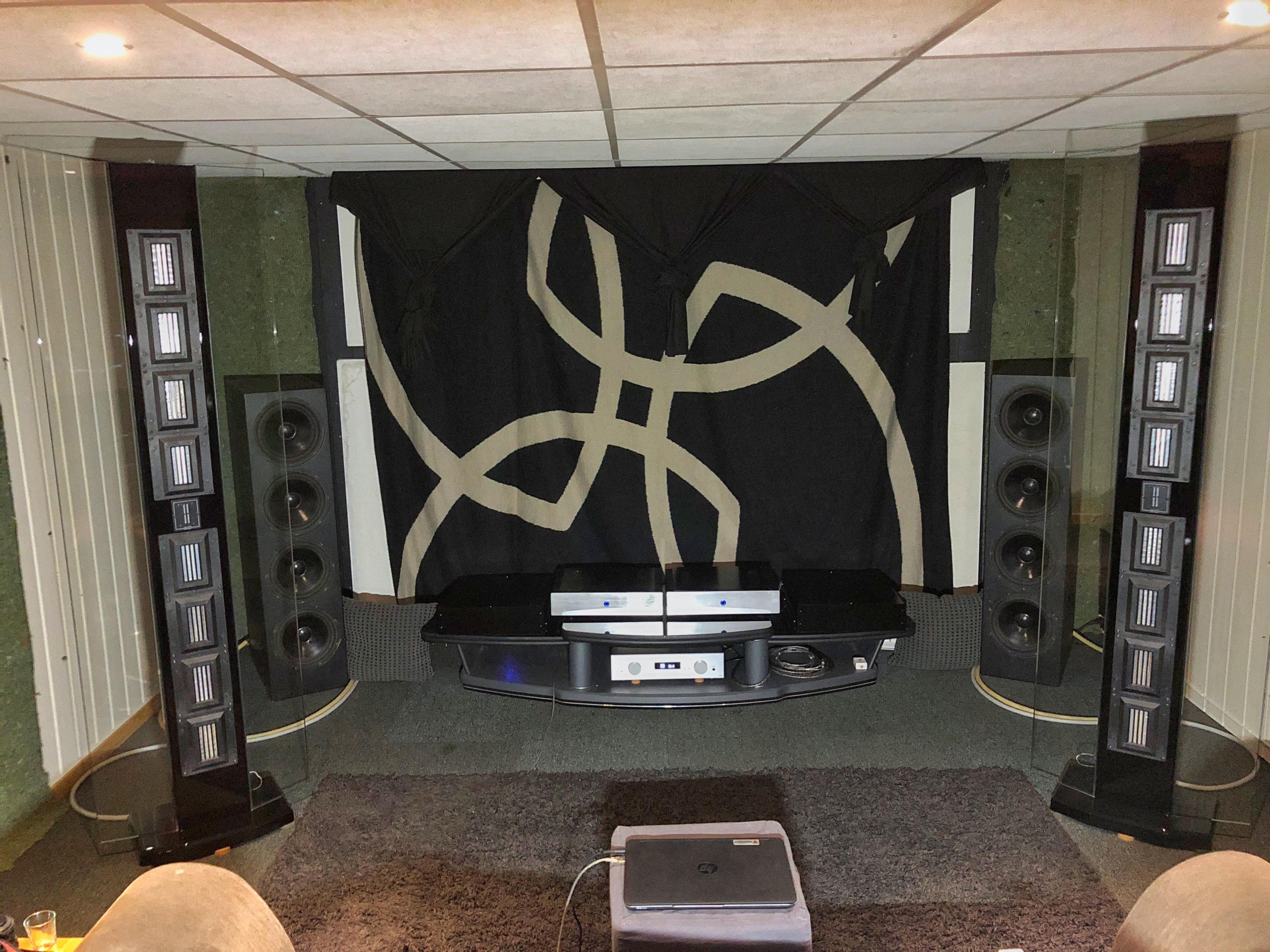

Emim tower baffle.
Here is a picture with the midbass system with 6 pcs of 10" Infinity polyprop bullet woofer in dipol baffels on each side. I want to complete the system with dipole woofers for the lower end as vel. I now use the 8 10" back there in closed boxes. Crossovers are set in DBX driverack PA. Mid bas is cut around 50hz going up to around 250hz to meet the Emims.
It sounds wery good :)
