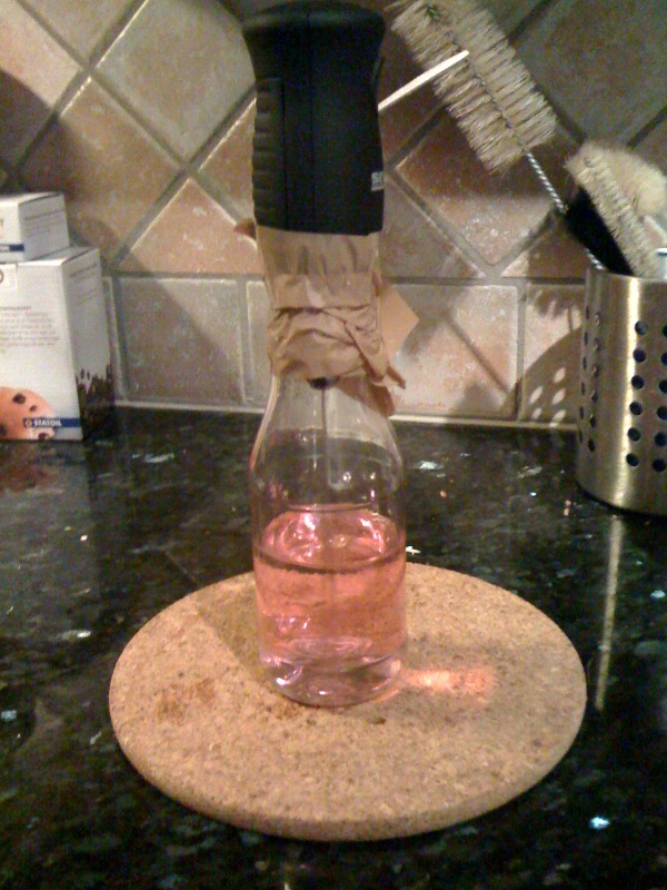

I have created a batch of Elvamide solution an was a bit surprised to see the result.
I measured 7.9 grams of Elvamide to 1dl of denaturated alcohol 98% and mixed for 50 minutes at 60 deg c (Used a milk foamer/frother worked perfectly)
The result was a sligthly pink fluid as the denaturated alcohol is coloured with a red/pink colour
But, the next morning the substance had turned into a pink jello/soapy substanse which is not liquid anymore.
Is this normal? I guess i need to dilute the "goo" before usage but was not expecting this pink "jam"
Regards
Bent

I can't say whether it's normal or not, but I had a similar experience. As I recall, I didn't have much trouble getting things back into solution once I warmed it up a bit. I expect that you could also dilute the solution to keep it out of the gel stage, but I haven't done any resistivity measurements so I can't say whether a more dilute solution would work well.

If you look at http://www2.dupont.com/Plastics/en_US/assets/downloads/processing/302061a.pdf
you will find gel time specs - which means is ought to go to the gel state.
Alex
