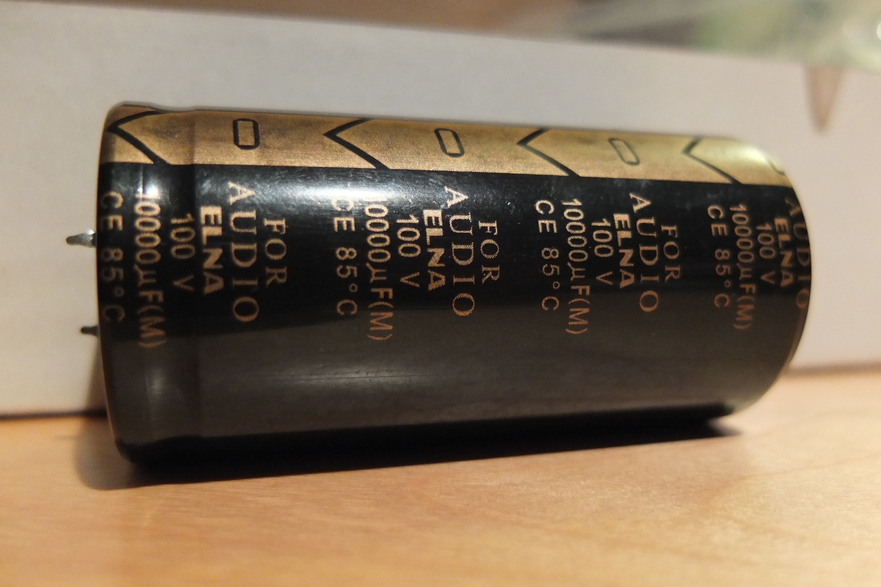

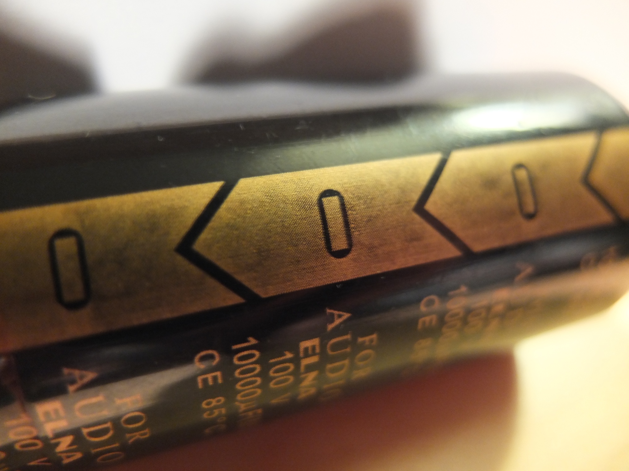

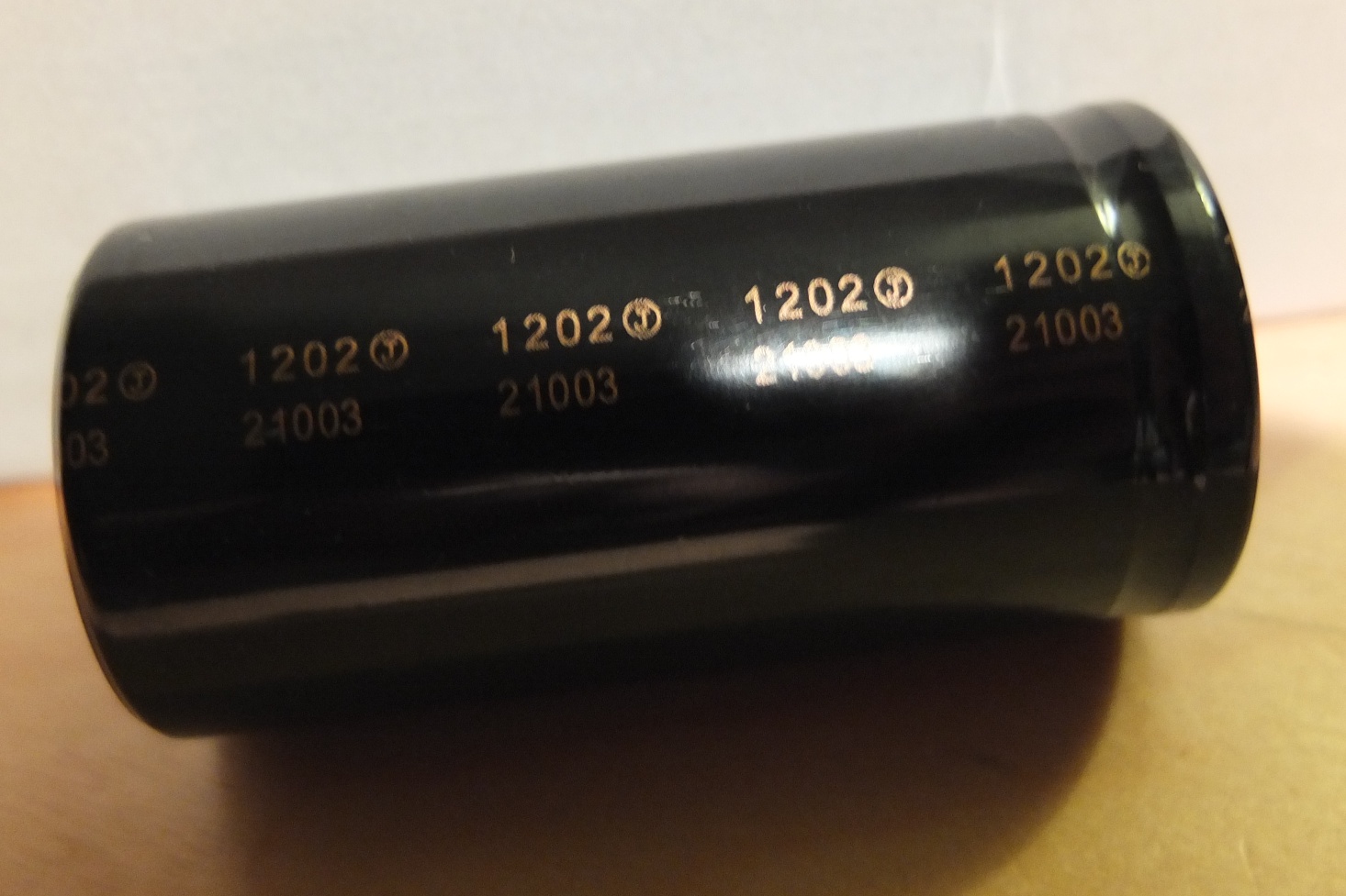

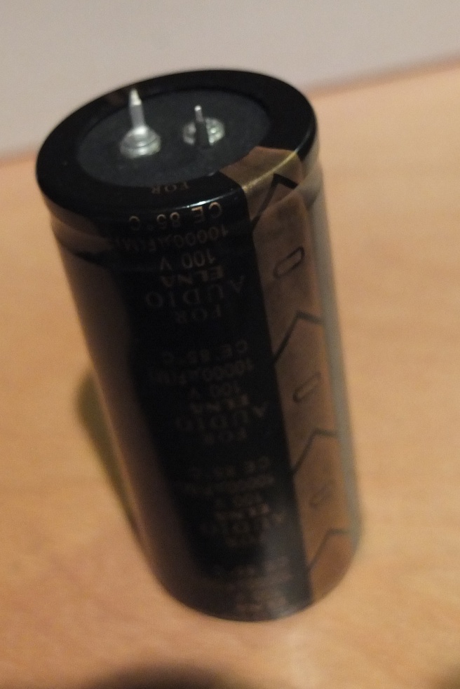

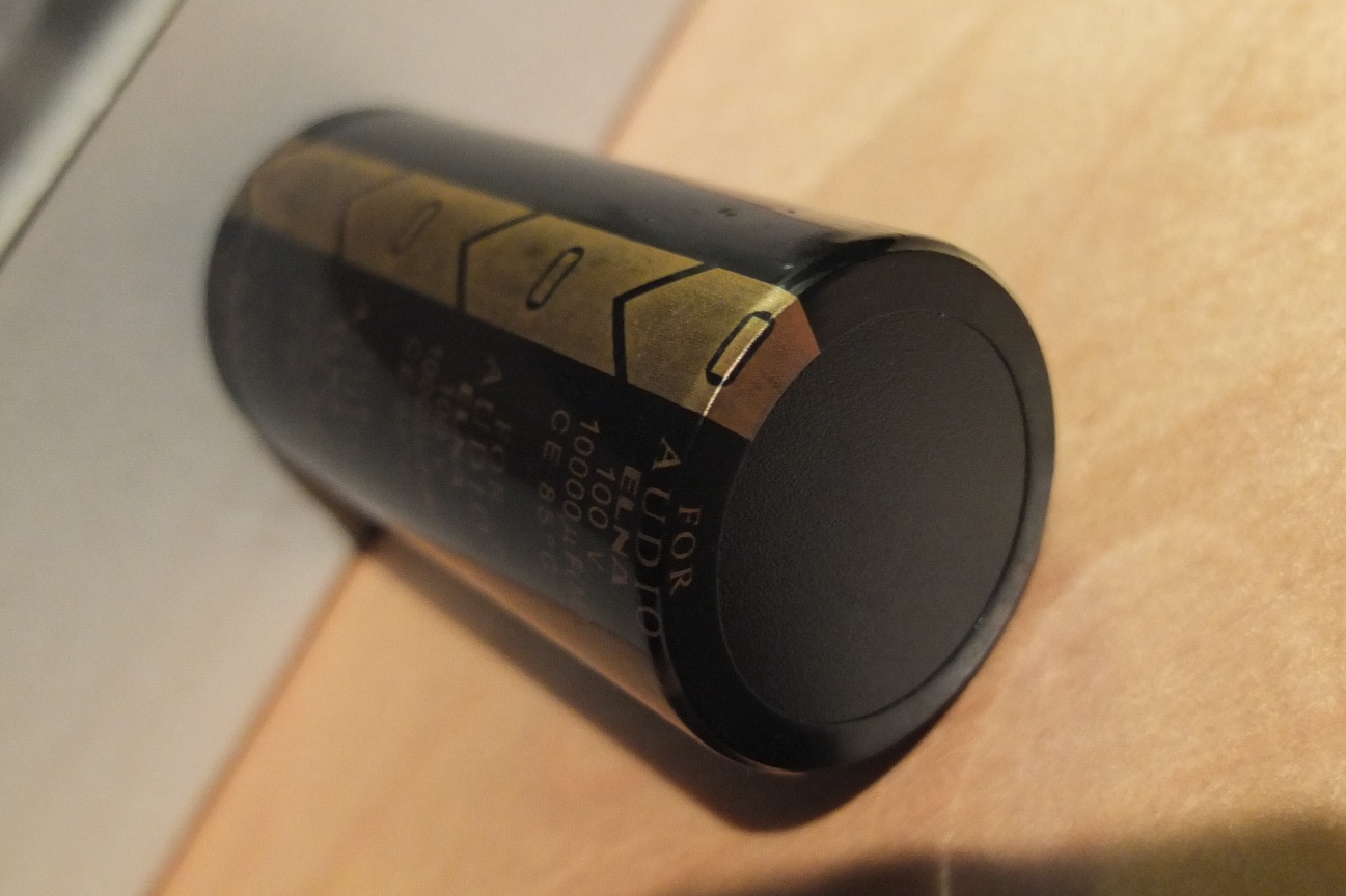

Hi, In my naivety i also purchased 8 so called Elna For Audio caps.
These came from a HK ebay seller that assured me they where !00% Authentic Elna.
Judge for yourself?
