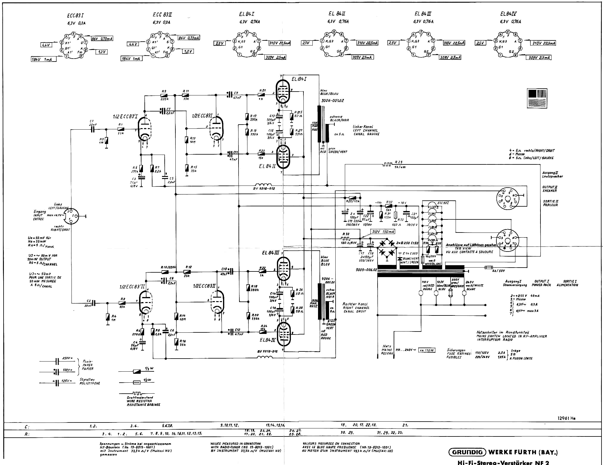

50w would take an awful lot of ELL80 in parallel. An ELL80 can be thot of as 2 EL93 in one envelope.

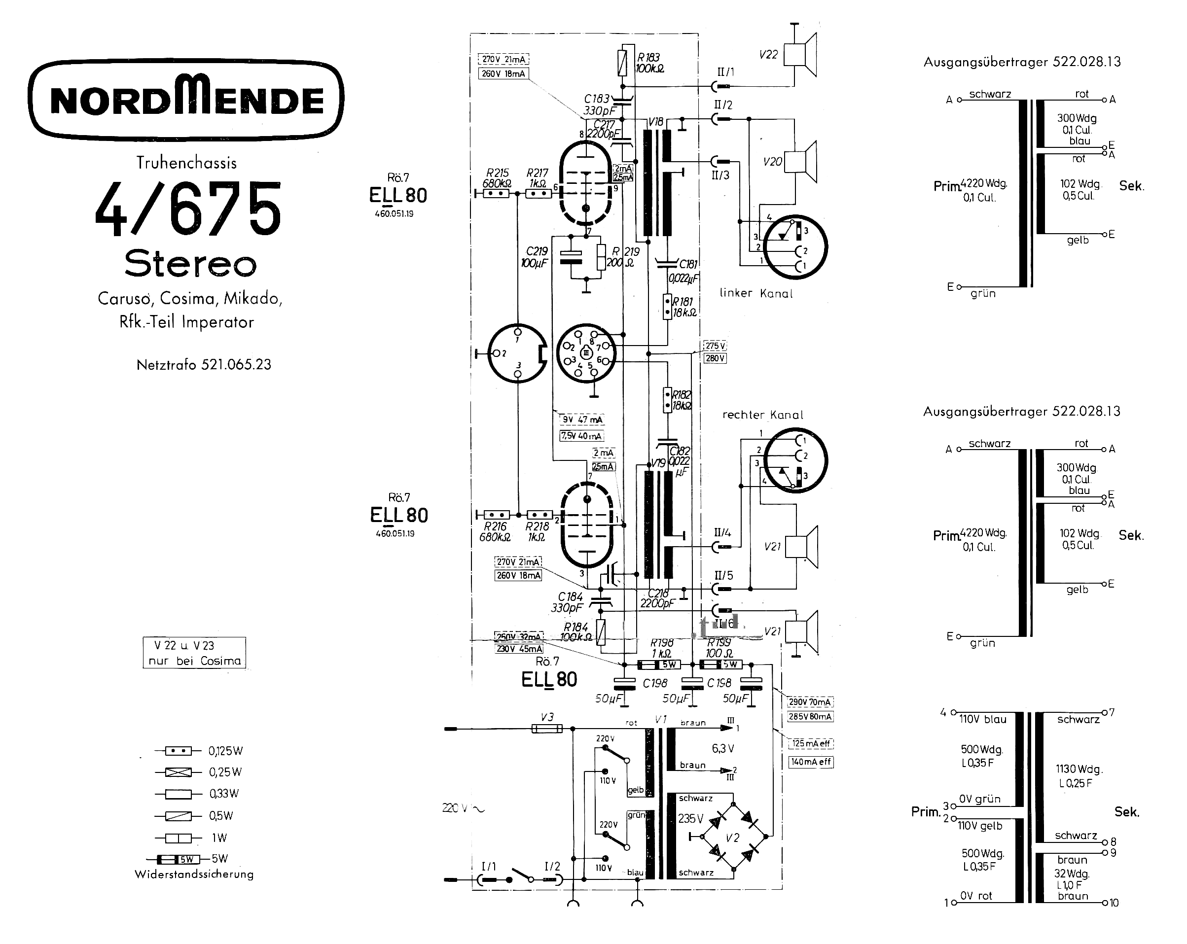

An SE amp good for about 3W by Nordmende:
attachment.php

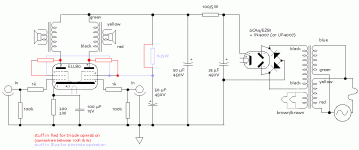

A Push-Pull Grundig, might make 10W:
attachment.php
dave

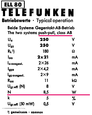

> ell80 as power tube. ....for a 50 watt
Datasheet says ELL80 can do 8.5 Watts one bottle push-pull.
50W means six bottles working into 1.8K (an uncommon load).
This tube is VERY rare.
I'm seeing prices of $80 and no stock in hand.
Six bottles is $480. For stereo, call it a thousand bucks with shipping.
Unknown how long it will take to source twelve good ELL80.

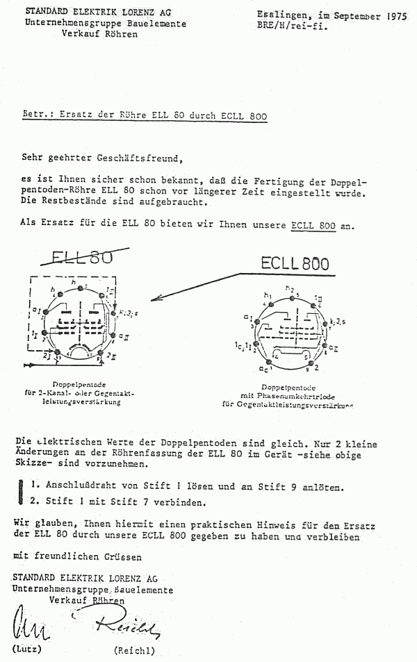

The ELL80 was a popular tube on early german stereo receivers because it allowed to fit a stereo design in the same footprint and cost of earlier mono designs. There are no 50w amplifers based on ELL80 because it is a small tube totally unsuited for this job. QQE03/12 is indeed a popular substitute for ELL80, but socket connections are different and electrical parameters aren't the same. A perfect substitute on most instances is the ECLL800. It can be exchanged for the ELL80 with a single rewire of pin 1 at the socket or a tube adapter. The catch is that on the ECLL800 both screen grids are tied toghether, while on ELL80 are separate. There is even a official Lorenz technical note dated september 1975 with the wiring details. Today a NOS ECLL800 has unfortunately almost the same cost of the ELL80.
Most ECLL800 amplifiers are push-pull because the special unit-gain phase inverter triode of the ECLL800 made this arrangement very simple and effective. The best example in english language has been published by Practical Wireless in the march 1964 issue at page 1024. The full issue is on the American Radio History website.
I have several German ECLL800 based radios on my collection and also a small stash of NOS ECLL800 tubes, and sometimes I feel the urge to build a ECLL800 amplifier. The issue with the recreation of ECLL800 based amplifiers is the weird output transformer needed. Back at the time there were two kind of transformers for ECLL800, almost identical for any manufacturer. Maybe the transformer design was a Lorenz specification, but I was unable to trace a source. The transformer for single ended confguration was usually fitted on standard 3w+3w receivers and portable tape recorders. Primary impedence is 10K, secondary 4 ohms. The transformer for push-pull operation is rated 9W (class AB), it does have the same size and 11k a-a impedence. There is a separate winding for the NFB and it is usually gapped. I believe that the air gap was there to compensate for any mismatch between sections of the tube, or maybe is simply a cost-cutting measure to reuse the same core of the vastly more popular SE transformer. Both vintage transformer types are readily available on the usual web sites, but the low frequency response is limited because they were paired with bookshelf-style speakers. For a modern day Hi-Fi experience a bigger transformer would be needed, but then the cost of the build will skyrocket and better tubes would be the logical choice.
Altough a parallel ELL80 push pull is higly impractical, maybe a QQE03/12 parallel push pull is possible, but I don't know what primary impedence would be optimal and if the tube will actually sounds good.
