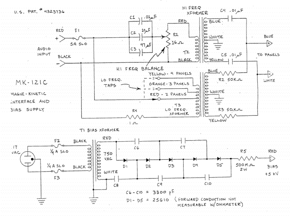

I've looked all over the net and haven't managed to find any relevant info on how amplifier malfunction can affect electrostatic speakers
couple of questions
1) DC offset - how does it affect the electrostatic speakers? will the membrane be off center when DC offset is present?
2) Clipping, what does clipping do to the membrane? am I correct that since the cooling is different for an electrostatic that nothing bad can occur?
3) What will amplifier osculation (sub and super sonic) do to the electrostatic speakers? This third question is something i'm really interested in
Thanks to anyone that can provide answers

Now as far as I know, electrostatics as we think of them (large panels like the Quads) always use a transformer to step the audio signal from the amp up to a much higher voltage that can deflect the diaphragm. The transformer means that DC offset can not be passed to the diaphragm which means that a DC offset has no effect.
Edit... I'm referring to a normal steady state DC offset. An offset that appears abruptly such as an amplifier stage suddenly applying say 30 or 50 volts DC could well cause damage as that would pass through the transformer as a pulse and move the diaphragm abruptly.
Clipping I'm not sure about. What I think has to be avoided is excess movement of the diaphragm so that there is no possibility of flashover, which would happen if it moved far enough to touch the other fixed high voltage plate. So I would imagine that clipping in itself isn't a problem as long as the applied clipped signal didn't move the diaphragm to far.
High frequency oscillation I think is a non issue, and if the amplitude of the oscillation were high enough to cause problems then I think the amp would be smoking before the speaker suffered.
Genuine low frequency oscillation is rare in solid state gear but if present and of high enough amplitude then it could cause excess movement of the diaphragm.
Those are my best guesses as to what may or may not happen.
The Acoustat 121 interfaces have been seen here minny times......the low frc tranfourmer has a one ohm on the neg side of the input.....an two 50k before the panels as you can see.....
Thes partes well get vary hot befor the transfourmer fails.................but it can fail....
These parts can get hot with amps... with nom low DC offset on there outputs when driven hard.......so it would led me to think if these parts were not there....any transfourmer would Sharate....with clipping an higher DC on the outputs............
Also if panels bias is low....or if high humidity get to the panels...
the partes well get hot an can fail if driven hard....
but how dose this affect the panel sound .....roll of the topend an has less output........
Tranfourmers crossover at 200-300hz I never heard any diff in sound of the panels.....long as the bias is up.....ML work fine an any other ESl I have owned..........
all just one mans findings.....after owen 10 are more pr of Acoustats...........an 30 are more panels......
Now we all know to keep clipping high DC offset amps off any speaker....if we can...good luck

Regarding dc-offset; audiotransformers don't like high amounts of low frequency; they will tend to saturate / distort. Any dc-offset will stress the transformer. Luckily most amps will have a very low (millivolt range) offset. If there is an input capacitor at the ESL, any DC voltage will be blocked anyway and is irrelevant. So, it won´t affect the mebrane, but the transformer.
The membrane of the ESL won´t suffer from clipping. In dynamic multiway systems, the tweeter has much lower power handling. If the amp distorts, large amounts of high freq. distortion products may be generated, blowing up the small tweeter. The same thing for oscillation.
