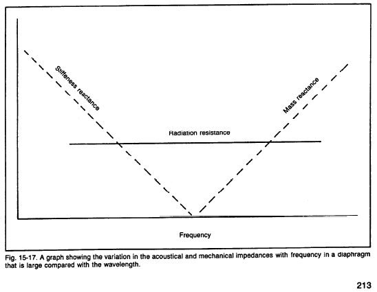

Also can we assume glass will be operating in stiffness mode across the entire frequency range? I have tried to bounce a glass of the door and it seems to resonate somewhere in the low midrange.

My experiments with ESLs(speakers, not microphones :) ) showed that if membrane thickness is more than about 8-10 microns top end will be dropping.
So perhaps the same model cannot be applied to both ribbons and ESLs or it cannot be "reversed".
Also in the paper "Wide-range electrostatic loudspeaker" by Walker there is an interesting graph showing effects of stiffness, mass and radiation resistance vs frequency although no actual values.

Well we must also consider the fact an ESL diaphragm is almost completely transparent to sound, at least in mid and treble where membrane stiffness can be ignored altogether. So it's motion would simply follow motion of air??
So it should not be uniform across the area, causing induced voltage to cancel out and drop with increasing frequency.
Lukas.
