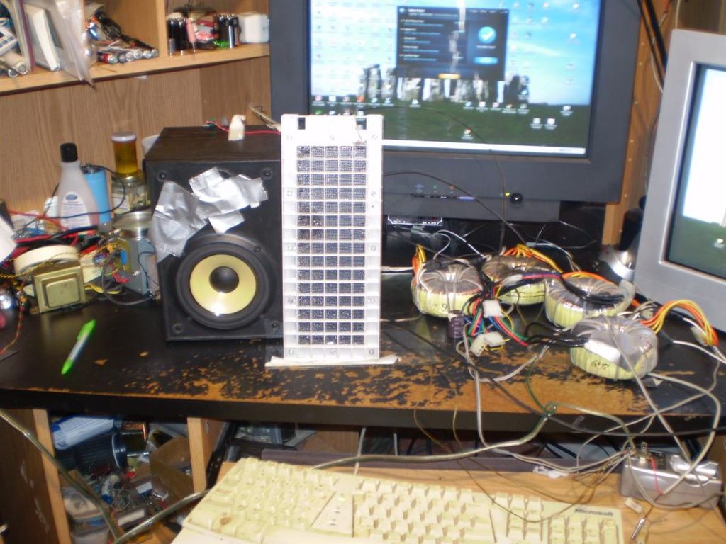

Many of us use a pair of toroidal powers transformer in reverse to drive them in a hybrid system using a woofer to handle everything below the 200hz to 500hz range.

I like building little desktop models with a 3" wide diaphragm about 12" or so tall.

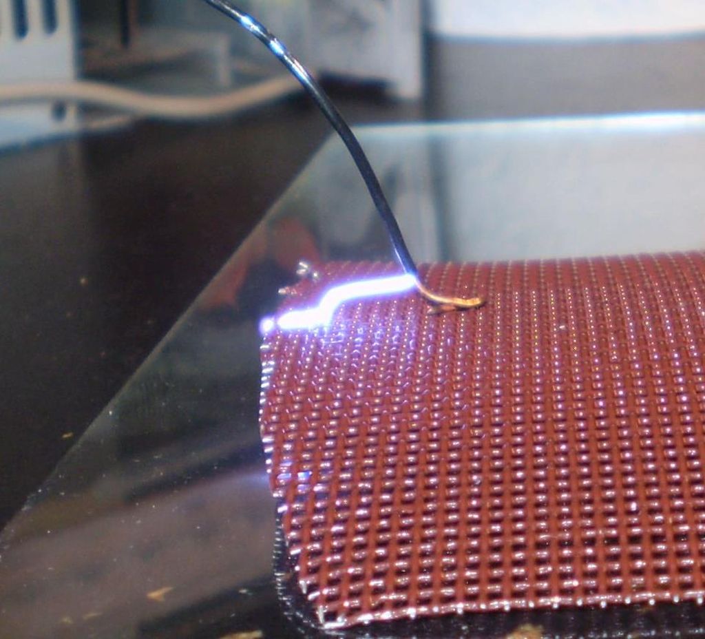

here are some pictures of my little panel and a test of a coating using common acrylic enamel spray paint at 13.8kv.
That little panel would do in excess of 100db!!
Sadly I pushed to hard and the stator coating gave out and burned it up.
So a new one is being made as we speak.
I made that little panel back in 2003 and have enjoyed for a very long time.
