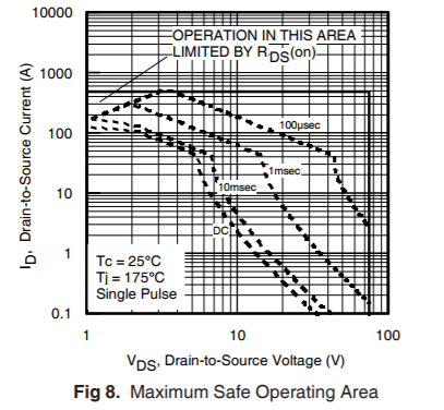

The SOAR looks OK, though, and as it is a post-2000 datasheet, any Spirito instability should be in the SOAR graph. (In the late-1990's, power MOSFET manufacturers had increased the transconductances enough to cause the Spirito stability problem, but they didn't show it in the datasheets because they were unaware of it themselves.)
I've attached the SOAR graphs of the C2M1000170D and of the IRFB3307ZPbF datasheet, which has clear Spirito instability.

It would be really stupid if they deliberately published unrealistic SOAR curves, though. When a company deliberately publishes SOAR graphs without the effect of Spirito instability while their MOSFETs suffer severely from Spirito instability, they are lying about the performance of their MOSFETs. Chances are that their customers will then sue them when they find out.
EDIT: I just realized something.
Look at that graph again: not even "DC" is mentioned on their SOA graphs (in other parts too), which means that the larger area is 100ms as stated, NOT DC and the upper area is cropped and limited to 10μs as too short pulses can also create hotspots!
100 ms is long compared to the thermal time constants in the thermal transient impedance graph that is to the left of the SOAR graph in the datasheet, so the 100 ms SOAR should be pretty close to the DC SOAR - except that the overall power must be derated a bit further for DC.

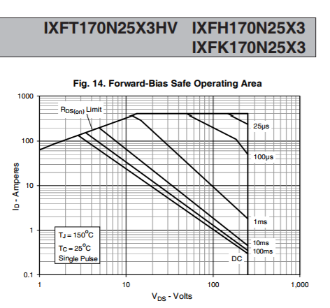

I just read that application note that Jan Didden dug up. I find it strange, because in that application note IXYS claims that the SOAR graphs they publish for their switching transistors don't include the Spirito instability issue and are therefore way too optimistic on the bottom right part. It is very unusual for a company to write in a public document that their specifications are complete and utter lies.
However, when I look at the SOAR graph of a random IXYS transistor with very low on resistance (very low on resistances usually indicate trouble), the allowable current does drop faster than inversely proportionally with increasing current. So apparently the datasheet graph does include the Spirito issue, as it should, even though their application note claims otherwise. Change in company policy, maybe?
LIfe experience dictates that there is a lot of gray areas in law and marketing, and a lot of risk designing something, so if one wants to be on the safe side, he should better avoid those gray areas and as much risk as possible.
WolfSpeed for example doesn't lie, they never mentioned DC operation. You can't sue them for something they don't claim.
It seems close to DC, yet the company does not mention DC for a reason, despite they want to sell more parts.
That's more likely than assume they didn't mention DC because they didn't care. Besides, you have all indications that support this, from the device's parameters I mentioned previously that suggest a switching-only device, to the company's exclusive switching orientation and total lack of mentioning "DC" and "linear" about their mosfets in contrast to other companies.
Many companies admit/warn in various documents that in general the SOA graphs are -or were at least up until recently, overestimatiing their parts capabilities. Again it's a matter of keeping a safe margin, starting at least from what they explicitly state, rather than from assumptions.

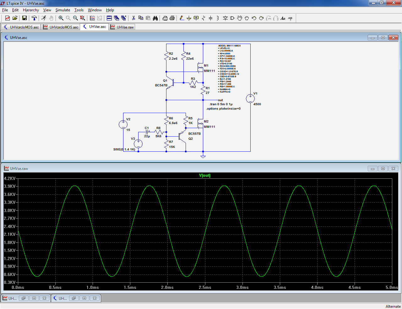

Elvee came up with some interesting design [picture]
Same approach, but very different.
Although I'm trying to move to quasi complementary for better performance.
..but I keep turning back for improvements.
-What is the distortion at 1Khz and 20Khz?
-What current does it draw?
-What is the frequency response?
(measured with a capacitive load of course)
-Are the mosfets "real"?
-Do they include the input capacitance?
(I have manually added the input capacitance to be sure as I suspect it is not included, although the models are official)
I haven't tried the above design, but I can tell that it obviously suffers from many "diseases", like excessive distortion, inadequate power bandwidth, etc.
I have personally put a lot of work to reach and further lower the previously mentioned 0.025% -by using different techniques.
But I recently came up with a quasi-complementary design with the following current specs: 0.004% THD with reduced high-order harmonics at up to 20KHZ, full power bandwidth of 1.4KV (from 1500V power supply) , 250pf load, mosfets with 1400pf input capacitance (instead of 200pf of the previously mentioned Cree one) and clean square-wave response. In LTspice of course, not real-life yet.
Still I have a lot to do, from making it a dual-supply one, to lowering it further to <0.001%, to ensuring perfect stability in all conditions etc.
