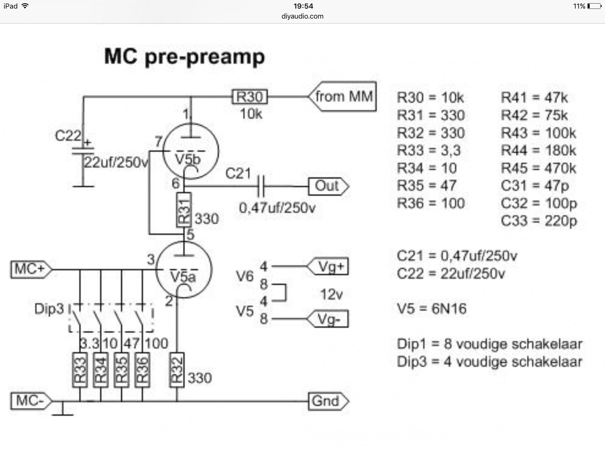

I have been using a jfet phono amp for a long time that include MC input. Recently, I am looking forward to build a tube phono amp but most of them are for high output MM cartridges. Is there something call electronic phono MC step up module in the market? I believe there must be but I just couldn't find it.

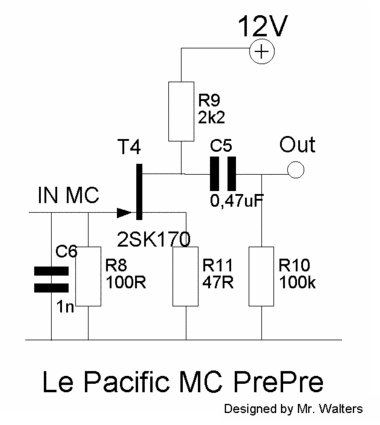

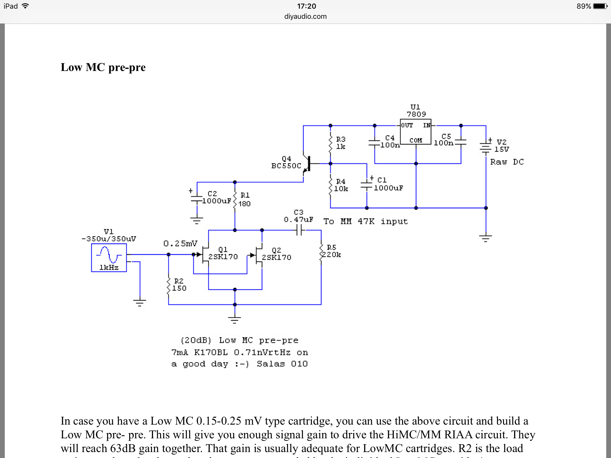

The jfet pre-pre looks interesting since I have a few hundred of 2SK170 with me unused. What is the gain and what IDSS should I use?
This also brings up an idea that can I use the jfet pre-pre section for the anticipated tube phono? I will post the schematic later tonight when I'm home.

The Pacific pre-pre is simple and it could be one of the alternatives.

Moving Coil's very low resistance gets down in the Universal Voltage Hiss of most amplifying devices. Until recently, BJT gave lower hiss. Recent JFETs matched BJTs, but have become harder to find. The classic BJT designs are, IMHO, more likely to work well without careful procurement and selection.
