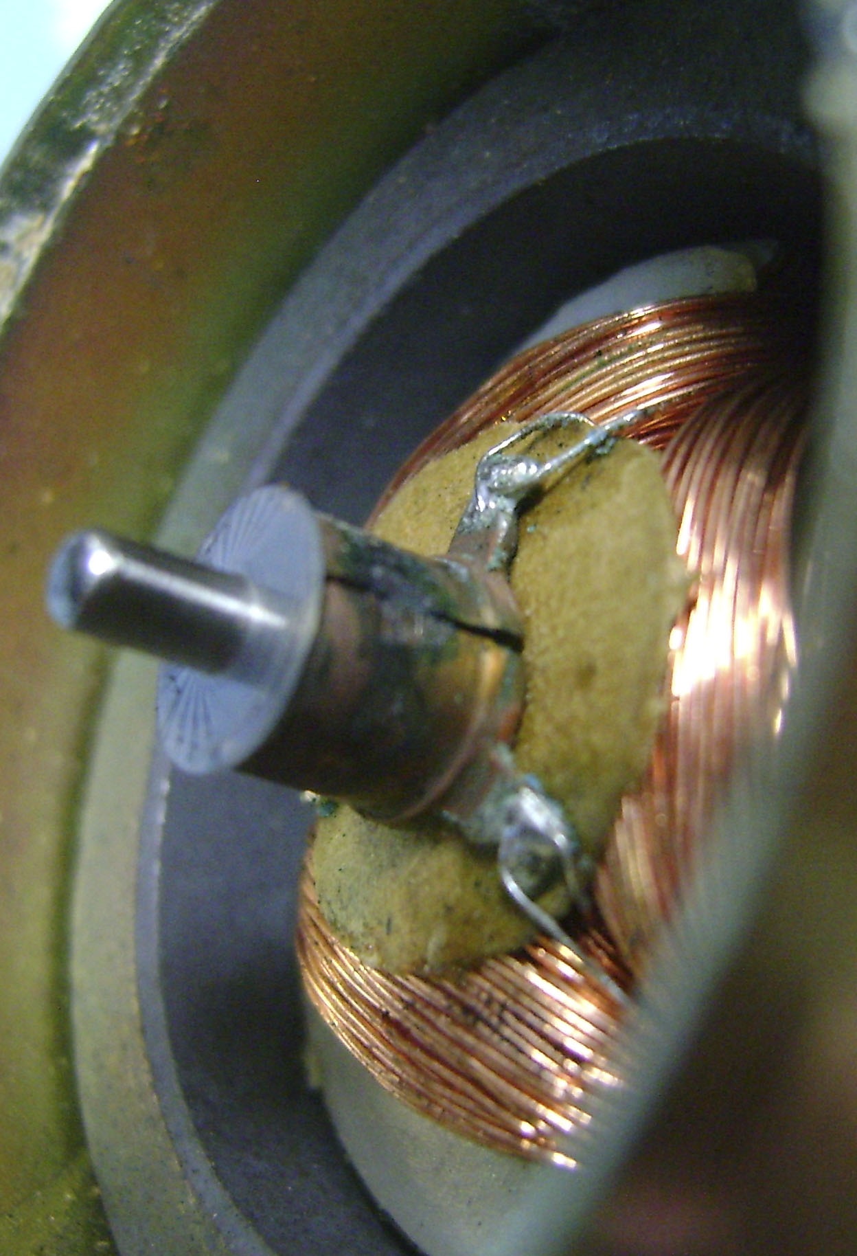

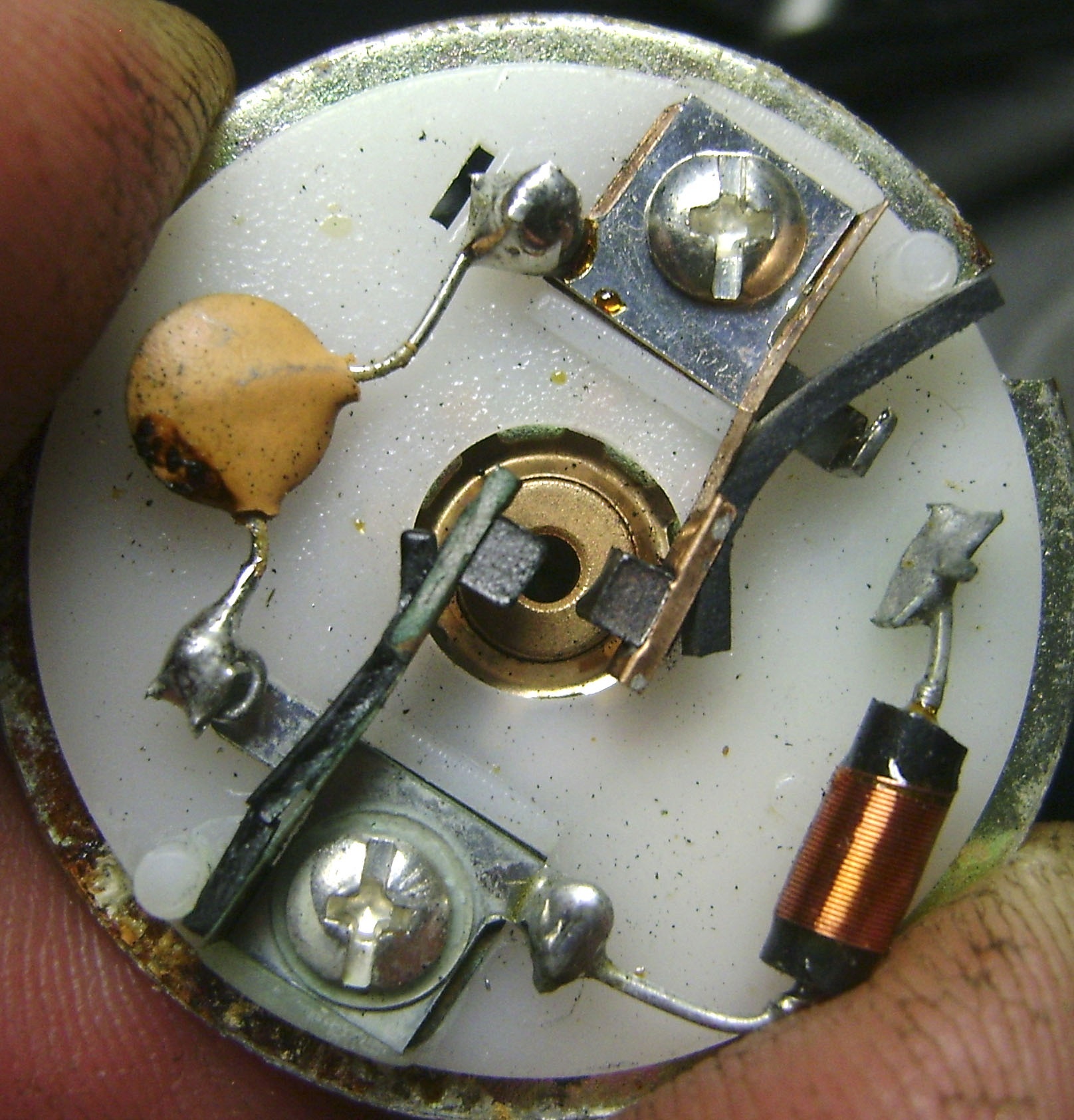

Progress: drilled out previous repairer's pop rivets, and will replace with screws. Insides appear fairly clean and undamaged, except for a little corrosion here and there, mainly on power socket. Removed latter, cleaned and refitted. Secured loose batteries. Now it charges nicely. Pump does not work, despite 10v on motor (with battery on charge). Removed motor end cover exposing worn and corroded commutator but surprisingly un-worn brushes. (See photos.). Plan now to remove armature and skim commutator. Question for D Cameron or anyone else: Is eccentric secured just on a press fit?

Progress again: Eccentric is only a press fit. By clamping eccentric between soft (aluminium) jaws, motor shaft can be pressed or gently tapped out. With commutator skimmed and reassembled, motor works fine now.

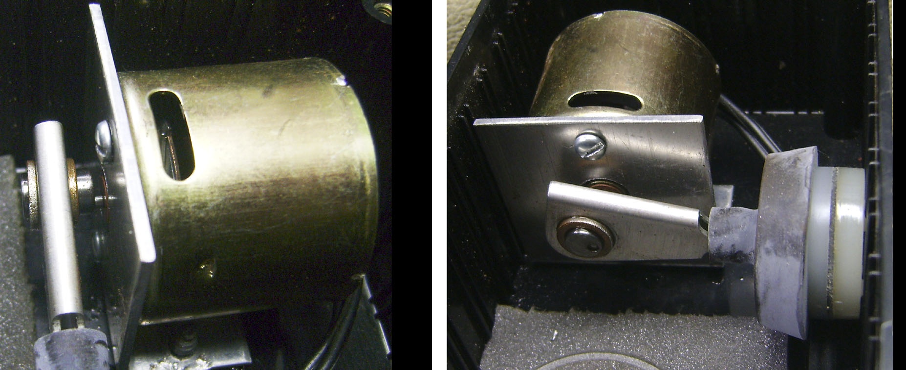

It would be good to see some more photos of this pump
Greetings again. I have been occupied with other things recently.

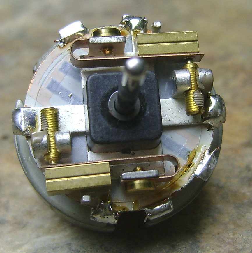

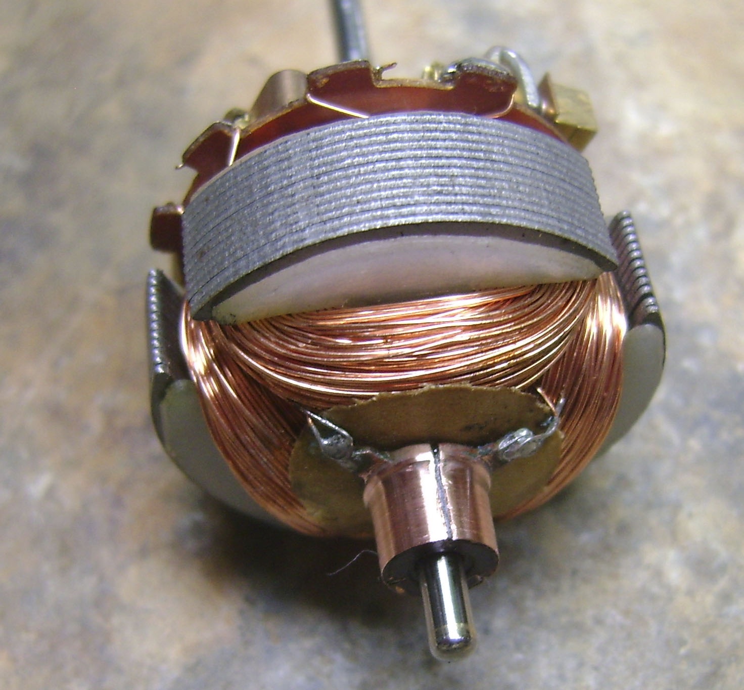

The pump motor armature looks from the commutator end just like millions of other little permanent magnet motors, but at the other end is this delightful centrifugal governor. Thinking about the CO2 sensor indicates the importance of a constant gas flow rate, and this is presumably the reason for the governor.
The eccentric is basic and straightforward. It could have been designed with much lighter components, and would have resulted in a quieter and smoother running piece of equipment.

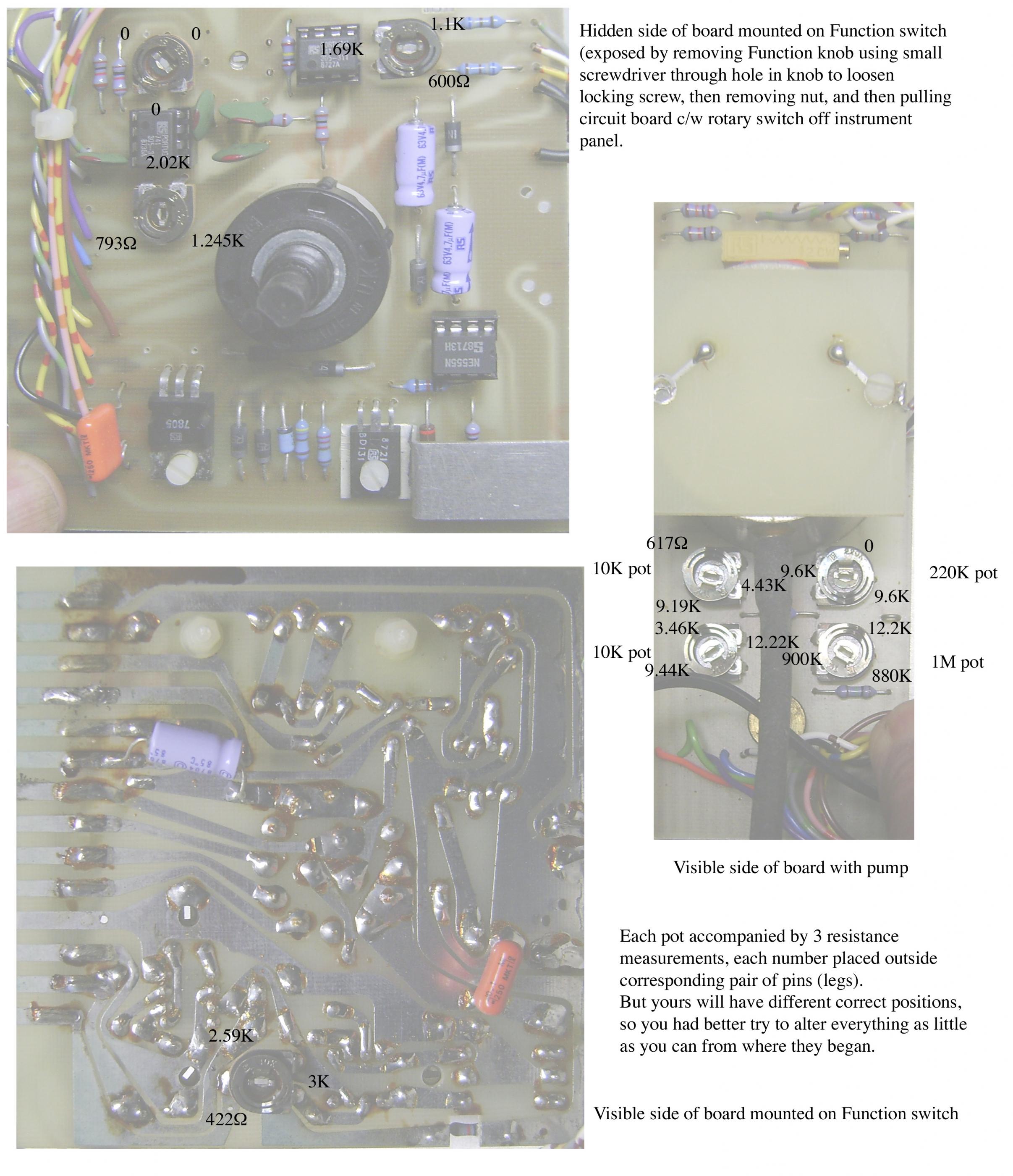

potentiometer (trimmer) notes
Here is my record of the trimmers (8 in all), none of which I have adjusted. All I have done is to measure their resistances between each pair of legs, to assure myself that they are all in order (particularly conducting between the track and wiper).
While doing this I tried to assure myself that the ICs were making good contact in their sockets. If I had felt dubious I would have removed the sockets and soldered the ICs straight into the board, but they look fine at the moment.
