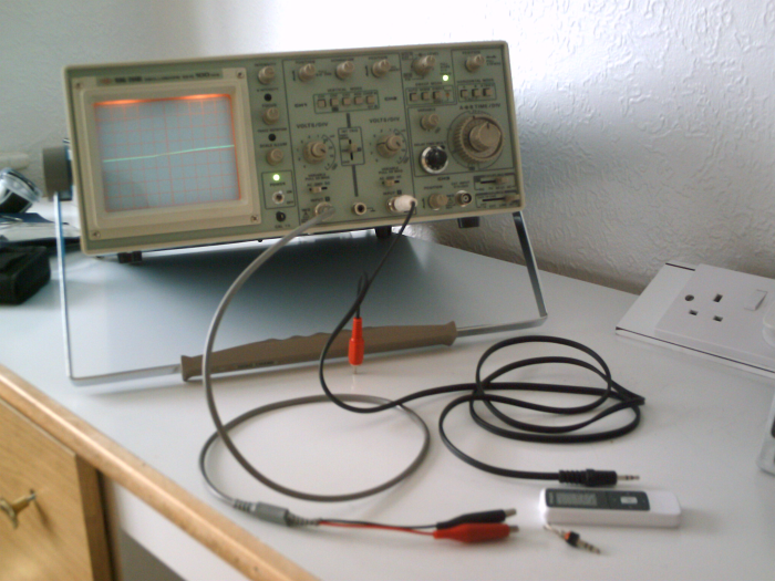

Test track 1 WAV and Test track 1 MP3 are 10 seconds at 440Hz and then 2m 50s at 7.81 Hz. Same track but different formats.
My MP3 players would not reproduce the low frequency at all. A laptop would but with visible noise. You could burn these files to a CDR/CDRW which should be pretty much perfect.

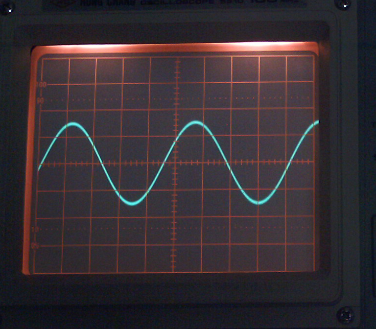

The pictures shows the 440 Hz generator derived signal. Its super clean but if you look carefully at the sine tips you will see there is a slight discontinuity and that is audible as distortion. It adds a slight harshness to an otherwise pure tone.

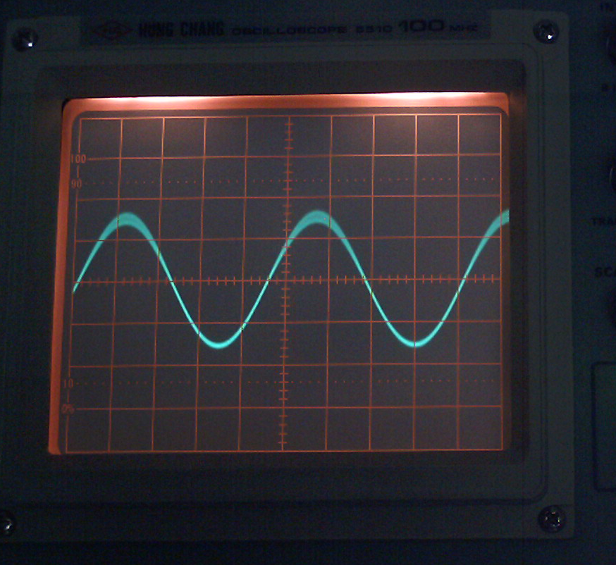

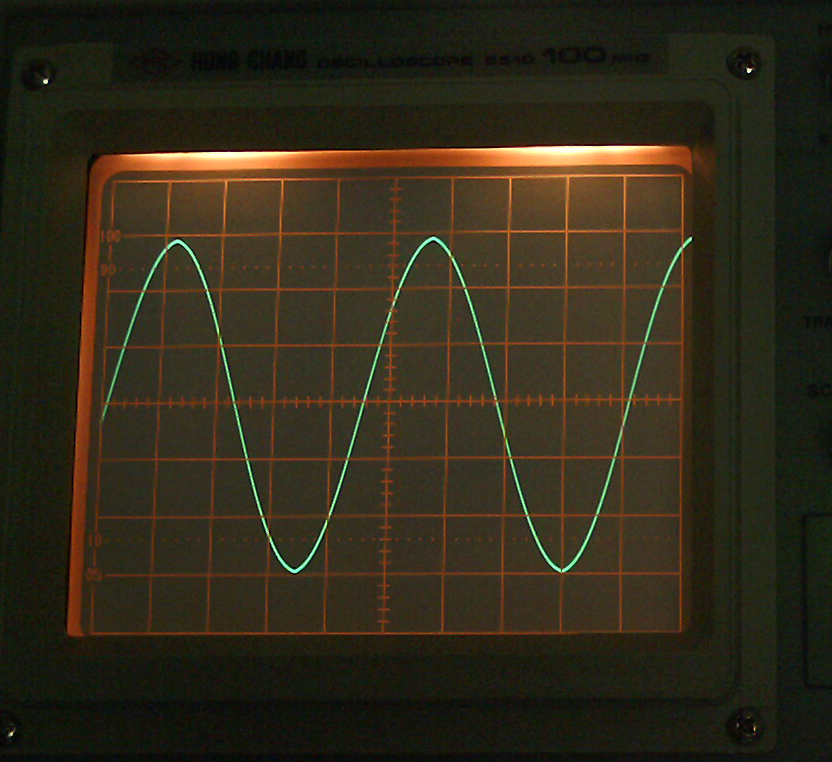

The next two pictures (this is where it didn't go to plan) show the problems of connecting a portable device and then using it as a high quality line source (rather than using headphones as intended). The only difference in these last two are the lead connecting to the scope. The first is a proper audio lead, the second a BNC test lead. The only difference is in the capacitive loading each presents and as you can see the audio lead upset the laptop output feed with the presence of HF oscillation and noise on the top part of the sine. Adding a load resistor of 1k or so cleaned things up.
So this really does seem to confirm that many players really do 'use' the headphone loading as part of the output filter/network and that running unterminated can cause an issue. Final picture are the leads.
So I would say 'everything' depends on the quality of the player used and that you must confirm with a scope that all is well. Don't assume it is.

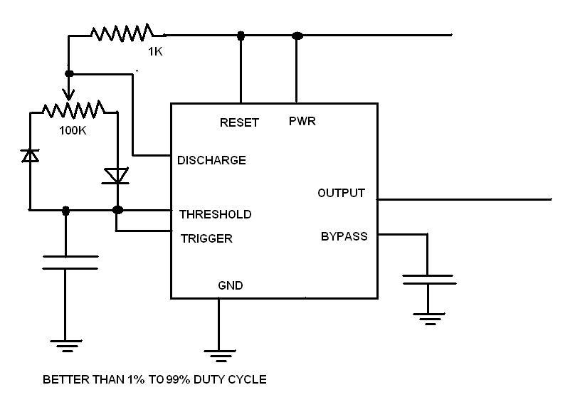

50 percent duty cycle pulse is not possible with 555.
Gajanan Phadte
I disagree.
