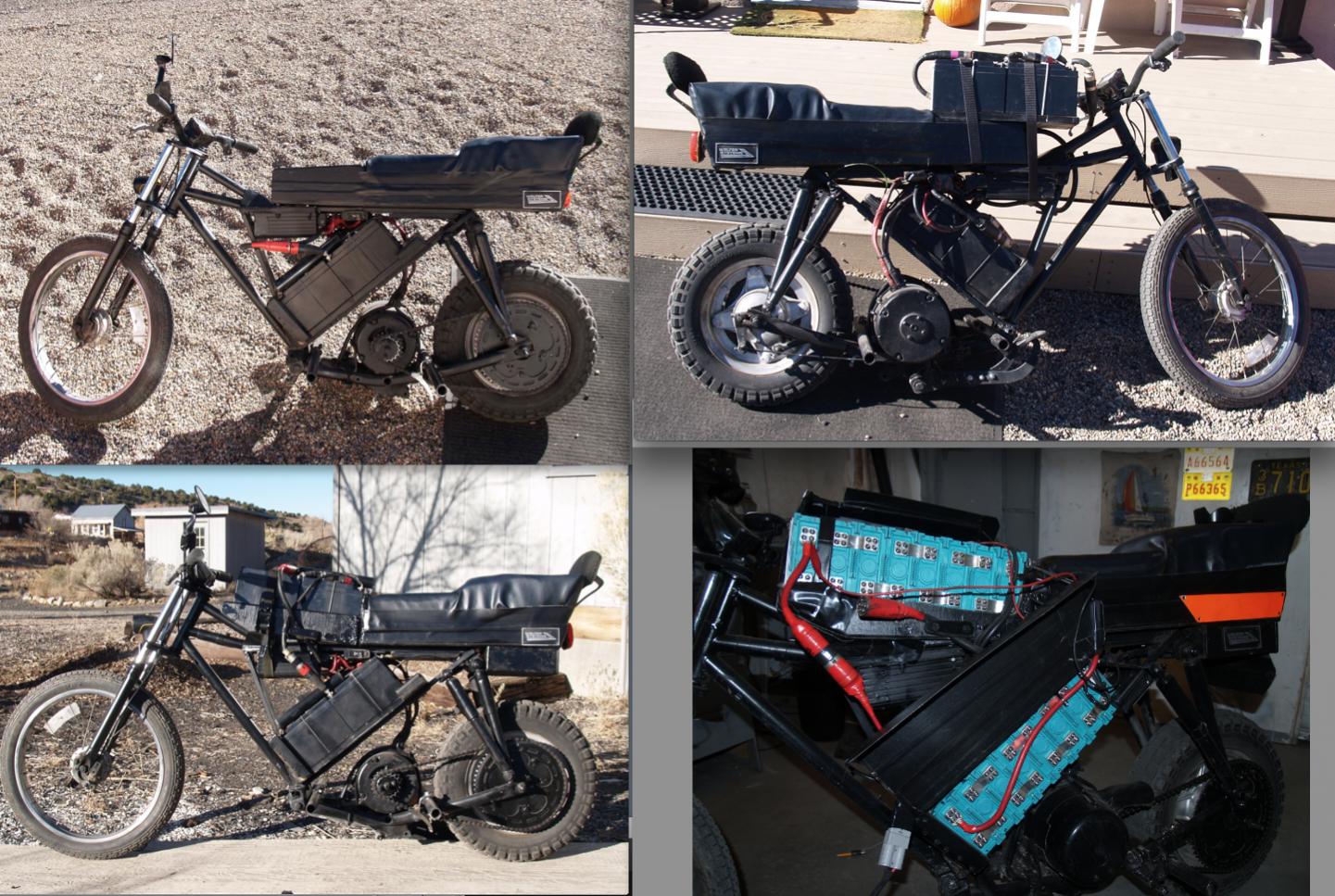

I overstated the speed of my electric moped, 46mph was downhill, about 35mph is the maximum for short distance without popping the 50amp breaker and/or overheating the motor, 25 MPH requires about 600 watts, the rated motor power for continuous operation. A fully faired recumbent bike could probably do 25mph with less than 150watts.
