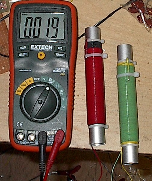

Here is a link to an inductor calculator that I have used several times. To make efficient inductors, the size varies and the winding is important. The idea is to maximize the inductance for the least amount of wire. Centre hole, height and overall diameter are important.
In the end though, 1mH is still 1mH, even if you use twice as much wire to get it.
MJL21193 said:Ever hear of a bifilar wound coil? It has next to no inductance, because of the way it is wound.
I have now ... but I'm not sure what it's good for. A coil with no inductance is a ..... ?
Its the way that non-inductive resitors are made. Its also the way that hearing aid transducers are wound.
Self made, non-inductive high power resistors:
