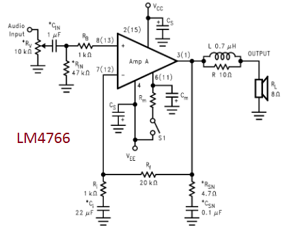

The output resistor is in parallel with an inductor BUT I will have to check the emitter resistors. Hmmm, think I may have made a mistake I'll open it up and check later.
I bet I measured it with my multimeter, when I should have used the DATS Multimeter wont measure resistances that low.

Thinking about it whilst looking around Tescos, I only assumed they were emitter resistors because they are around 2.5 to 3watt and are well off the circuit board (they look like the output resistors, only a different value).

Just took the lid off my other CA AM1 and the "Emitter or whatever they are" resistors are 4.7R. Can't be bothered to remove them from the board but the colours are, Yellow, Purple, Black, Silver, Brown. And the output resistors are Brown, Black, Black, Gold, Brown (10R).

The 10R is output resistor in parallel with a coil (as you have correctly noted).
The 4.7R is a zobel. It is in series with 100n cap.
Don't know why I didn't spot that on the datasheet
