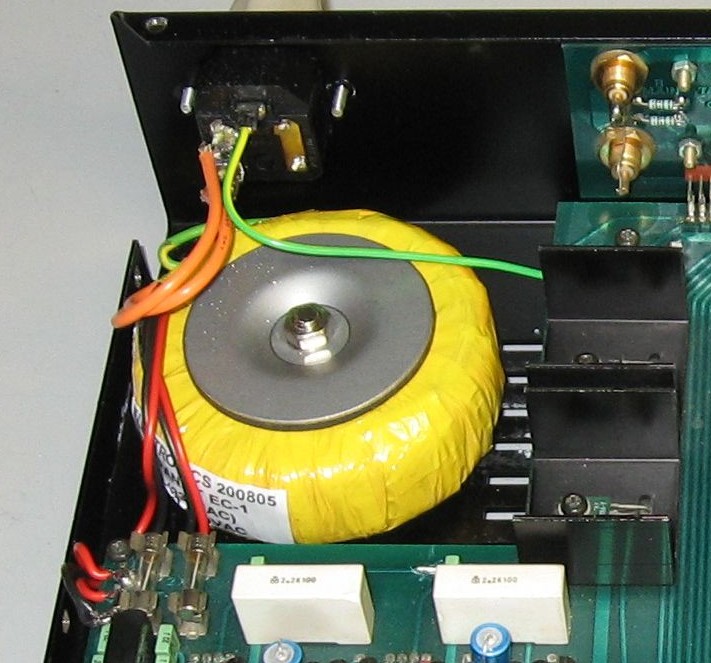

Hello surstommig,
The EC-1 does not originally have an outboard power supply.
So perhaps sometime in the past there was a problem with the original transformer and someone replaced this by an external one.
I had an EC-1 without a transformer (someone put a very small 2x 24VAC transformer in it, but that did obviously not work.
I bought a small toroid transformer of the correct size and removed the secondary winding. Then I rewound it by hand till I got 2x 43VAC. That is about the correct value. 2x 45VAC will do also.
The EC-1 certainly is sensitive to transformer hum, so had to orientate it to obtain minimum hum.
I suppose for the very same reason a former owner built the transformer externally.
Is it not possible to rewound the defective transformer? You can reasonably easy do it by hand. Winding wire can be bought in all diameters.
Just count the number of turns you unwind, and measure the diameter of the wire accurately and you are fit to go.
Success, Jac
Success, Jac

I used a 50 VA transformer for it.
You can measure the space available and compare that with available transformer sizes.

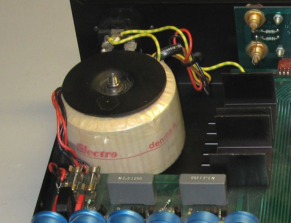

Please find attached a photo of an original transformer and a photo of the one I wound.
If you want to keep the transformer outboard, you are not restrained by a maximum size.
A bit larger in the VA-rating will never hurt.
Regards, Jac
Regards, Jac

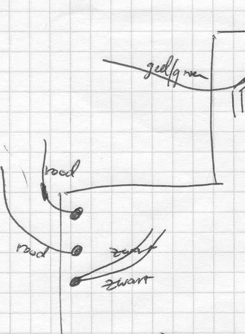

Hej Jac!
Thanks, you are saving me so much time! I'll go and look out for a transformer. I'll probably stay with the outboard solution, since the available room is tiny and I don't want to drill a hole into the chassis, since there is none where you mounted your transformer.
Please excuse my amateurish (stupid) question: Did I get this right, that you soldered the two black secondary leads together on the power input board?
No the secondary leads are not connected in parallel.
Only two wires of the 2 secondaries are connected, so that in fact you have a 90VAC center tapped winding.
The rectifiers and regulators on the pcb of the amp make approx. +50VDC and -50VDC of that.
Make careful notes of how the transformer is connected in the situation you have now, before you disconnect anything.
Hope the scans of some of my notes are helpful to you.
Jac
Jac
