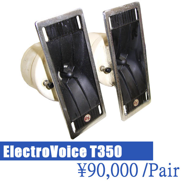

One offer I have found about the ebay USA, item No 200636124805

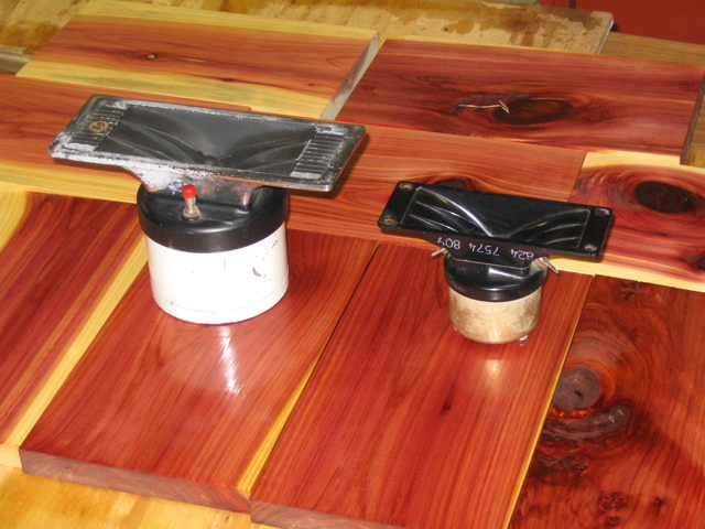

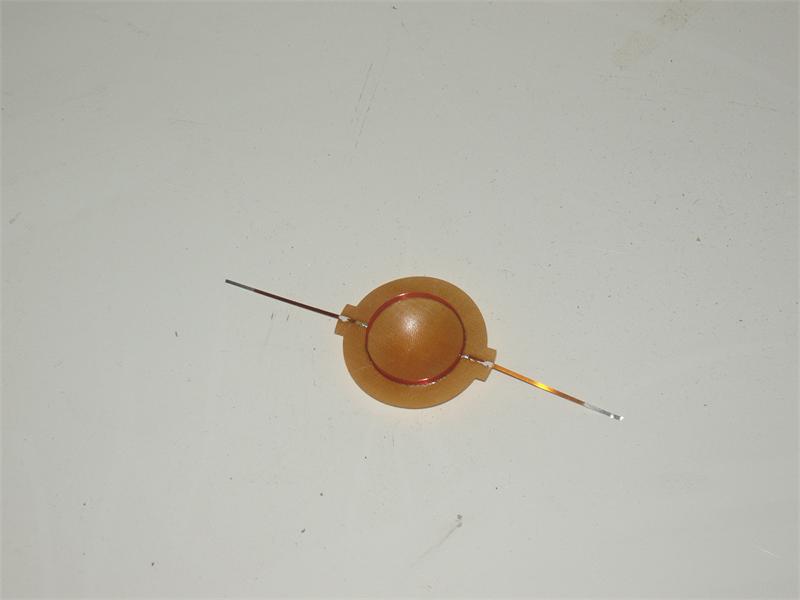

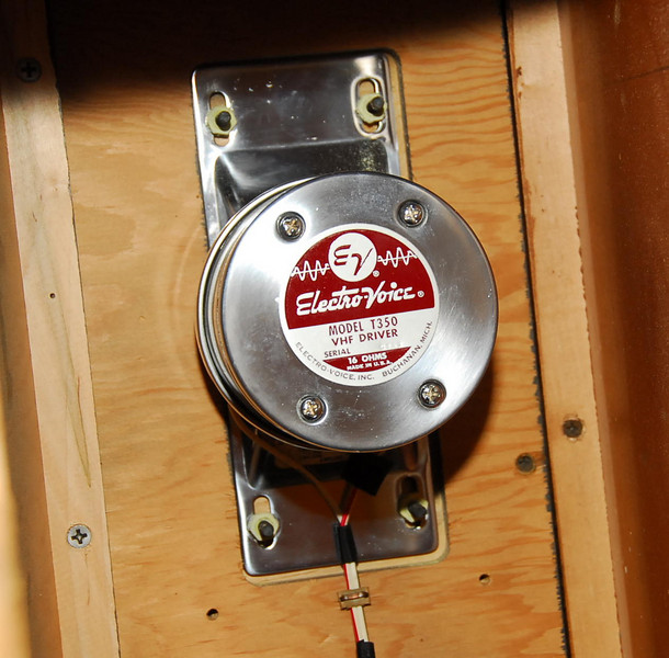

1) The T-350 has a much better horn design than the T-35, it sounds smoother, plays louder (so requires less power) can go lower and has better dispersion characteristics.

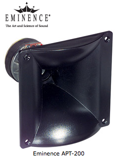

2) The Eminence APT driver is available with several different horns, the APT -200 most similar to the T-350, and has more extended response and far more power handling with similar sensitivity.

Shimming and alignment of the diaphragms in T-35s and T-350s is critical, depending on the care taken, large deviations in sound are possible. If the diaphragm is not perfectly installed, distortion and ragged frequency response result.
The voice coil takes very little power to burn, most T-35s or T-350s used for PA use have been re-diaphragmed, and often proper care was not put into the process. If you are not familiar with diaphragm alignment, I’d suggest steering clear of units that you can’t listen to or measure before purchase.
The photo on the left below is the APT-200, right is an EV ST-350.
