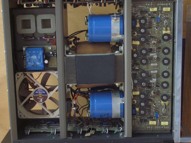

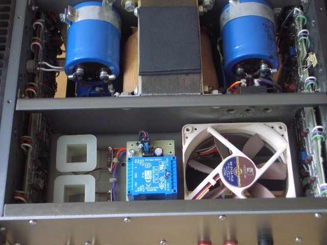

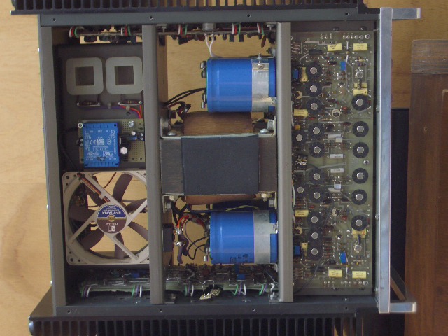

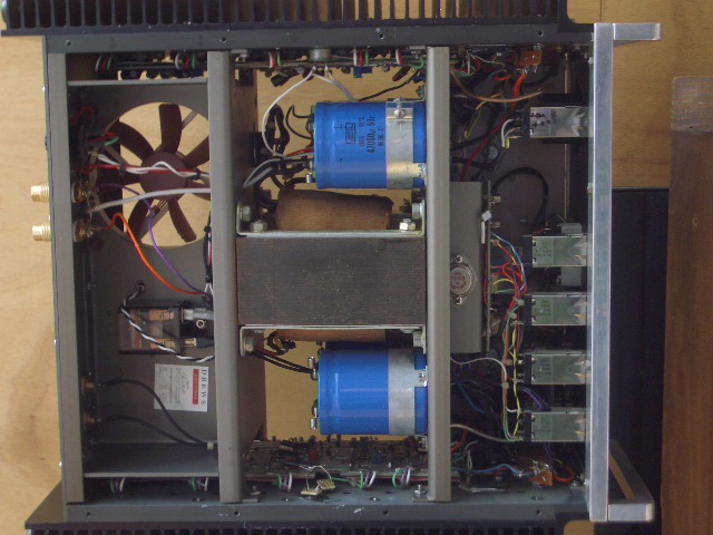

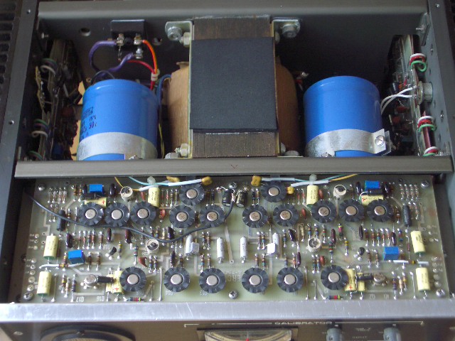

More pictures
Top and bottom cover can be removed for full access to the self supporting chassis.
The main caps are not original. Somebody added a supply and regulator for the fan.
Mains transformer has a primitive EI core. Driver board in front is separated from the
current amps on the heatsinks. The big caps seem to be assigned l and r, but share
the same rectifier.
