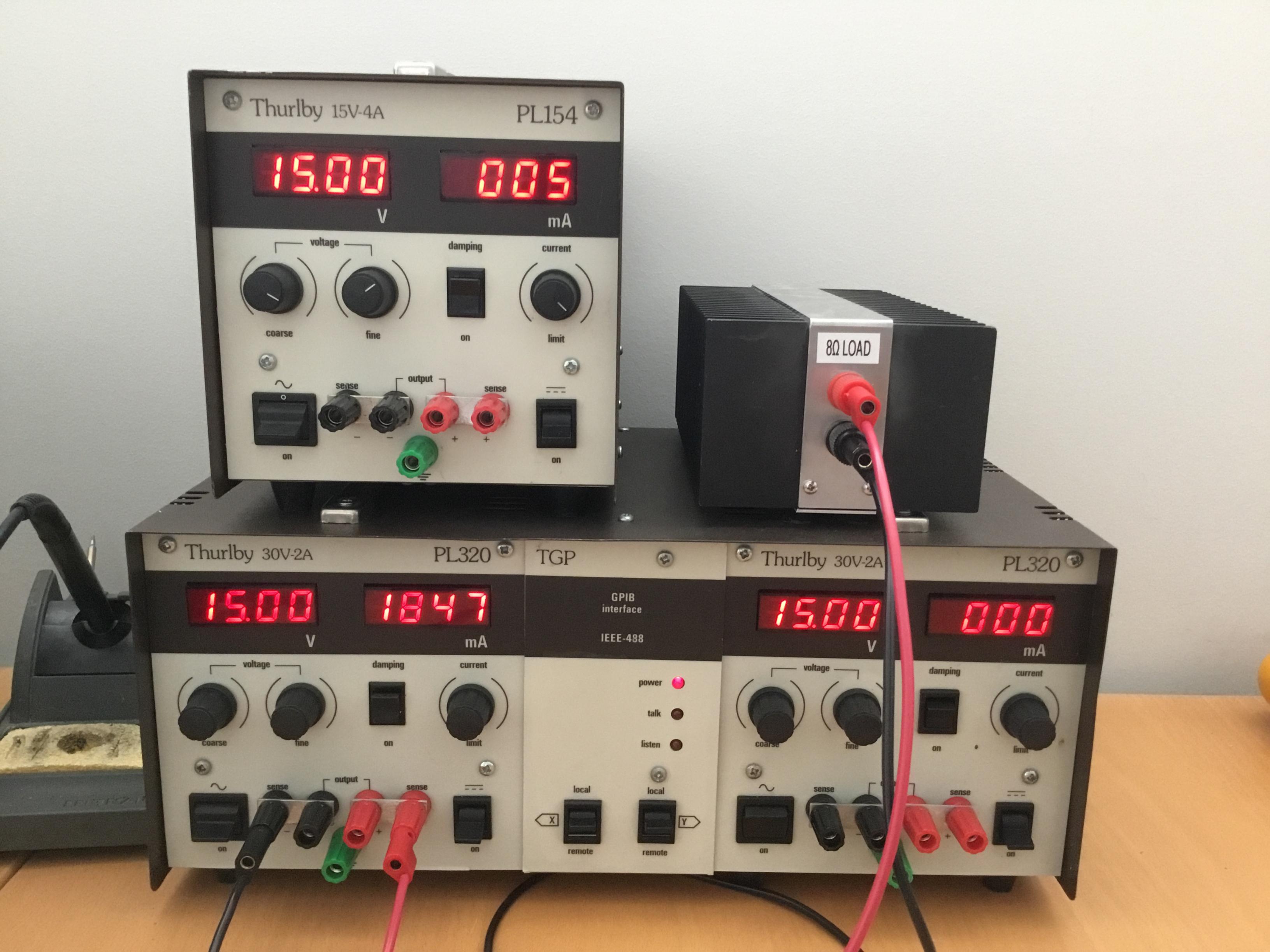

So for home, I've bought a pair of old Thurlby supplies; a dual PL320 with a gpib module in the middle, and a single PL154. They were both quite cheap and well used, so I've given them some TLC.
Date-wise there appear to be four variants:
  • The original two-tone brown/beige mid-'80s design, with LED displays and a rocker switch for display damping.
  • An early '90s version with LED displays and a pushbutton for display damping.
  • Late '90s version with LCD displays.
  • Current TTi version in white plastic box.
Mine are the original. They're a bit clunky to work on because they didn't use connectors, and the display chip is no longer available, so you're stuffed if that goes, but they're very reliable.

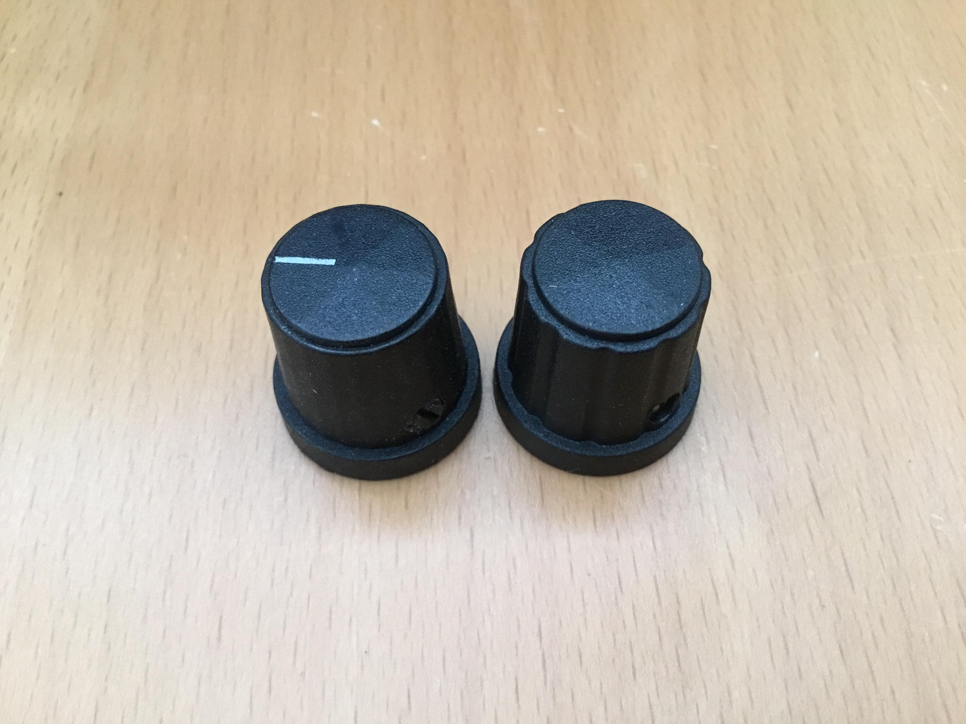

Mine was missing some of the caps from the knobs. A Cliff CL178887 is a very close match, and tops for this (Cliff CL1764) are a perfect fit.

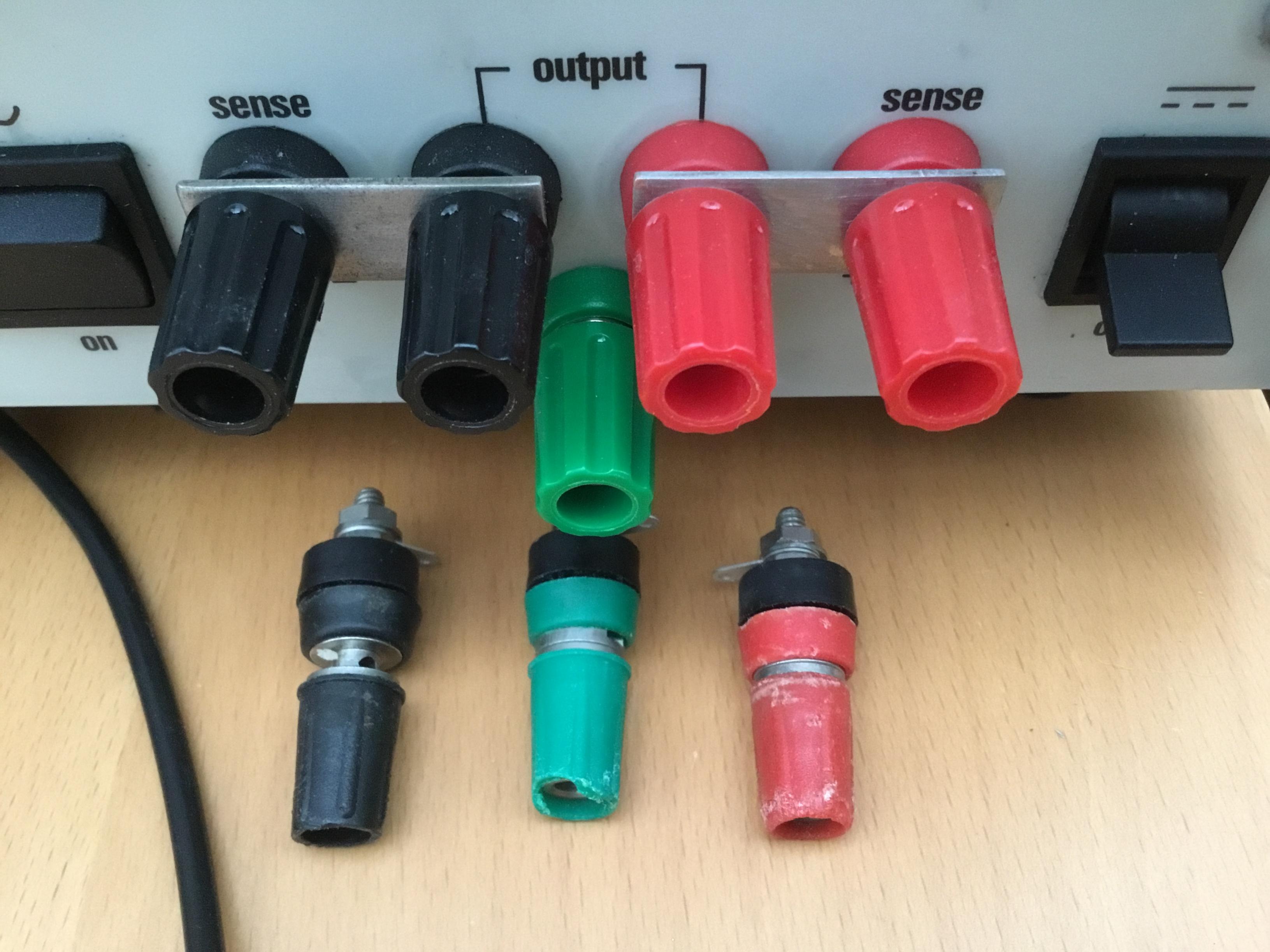

Similarly, the binding posts on mine had deteriorated. They appear to be Cliff TP2 parts (CLIFF Electronic Components - Single Terminal Binding Posts). I substituted Cliff TP1 posts which are very similar but just a tad bigger to allow for easier torquing down on wires.
Knobs, binding posts and caps are readily available from element14 (Farnell), or RS etc.
The only difficult bit to do was the shorting links. The PL supplies have a separate sense binding post for +Ve and -Ve, which is quite cool if you want to deliver exactly +5V at your PCB/battery/whatever with thin wires.
Anyway, most of the time you leave shorting links in place. These are just tin-plated copper bars that slip over the binding posts, and don't get in the way of putting wire in. Alas Mine were missing 3 of 6. I searched high and low for a source of new ones to no avail. Eventually I just hacked up some 1mm thick copper sheet to approximately the right shape and tinned it with solder.
It's good enough that my hubby can't tell which are which, so that's good enough for me.
Next on the agenda is to buy some multi-turn pots for setting voltage (50K) and current (10K), as the current ones are a little approximate, even after a good dose of contact cleaner.
Performance-wise they do what a power supply should. Output is stable within a few millivolts, and reasonably low noise. There's 50Hz harmonics, but I measure them to be suppressed to ~50uV at 16V 2A.
So the pics show the cleaned up supplies, a close up of the replacement knob (no marker line as I plan on swapping to multi-turn pots so the marker isn't that useful) next to the original knob, the process for making shorting bars (copper sheet, tinned, original), and a comparison of binding posts.

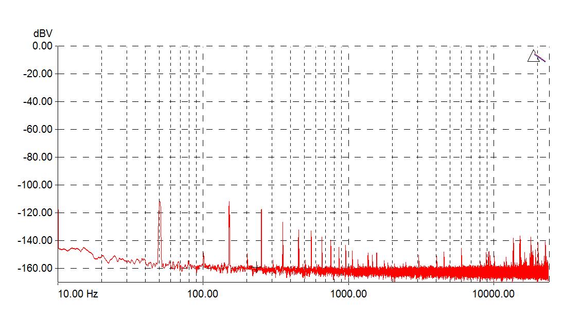

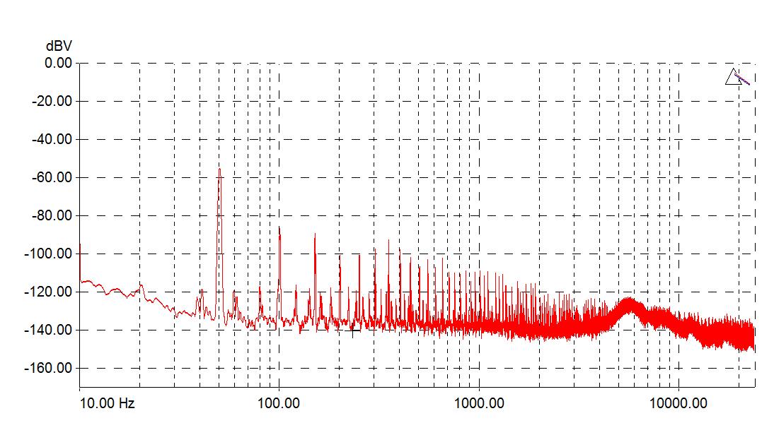

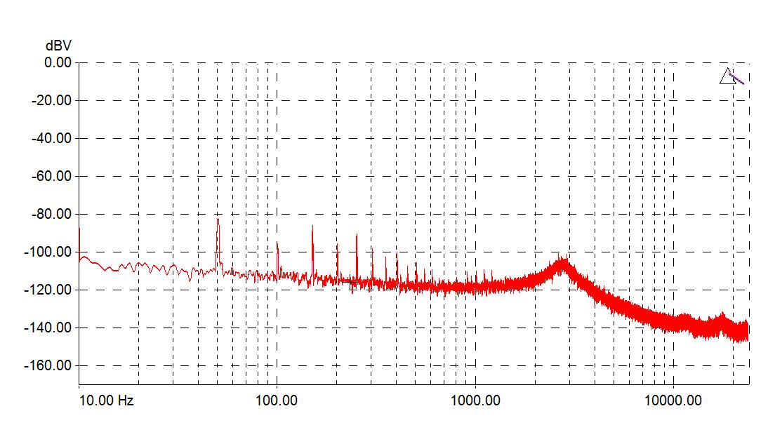

here are the ffts .. first is just PSU test cables with the terminations shorted so u get a sense of the noisy environment; then a kikusui lab-supply that's 20+ yo - and finally a chinese lab supply that just came a few weeks ago...
Oddly enough i like the old one still ...

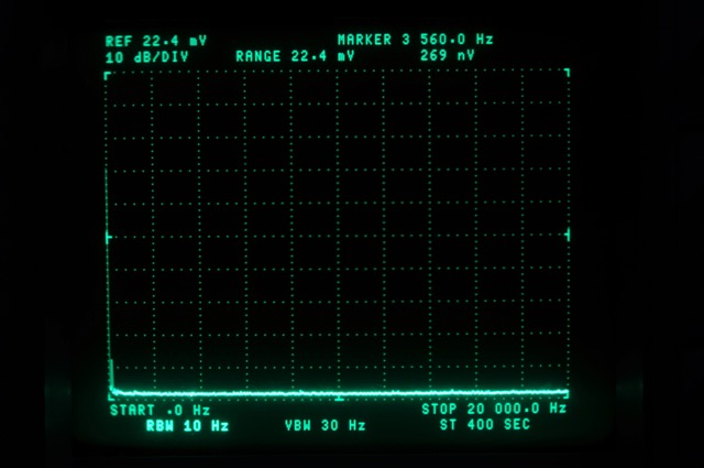

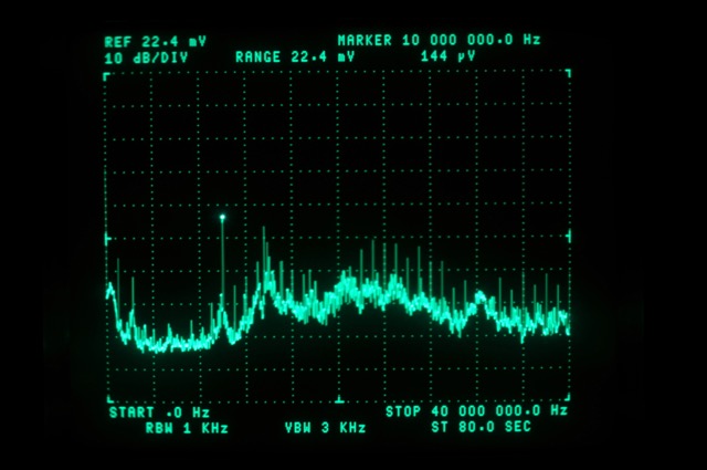

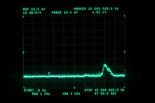

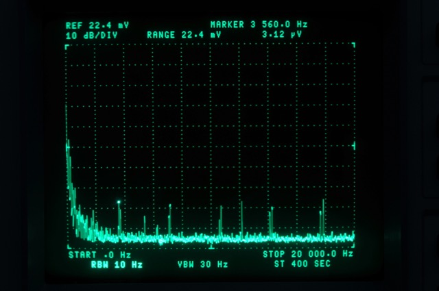

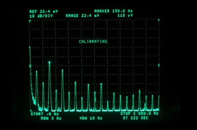

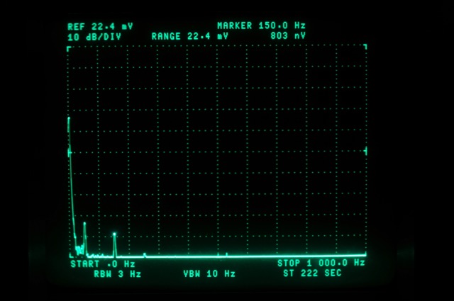

Some spectra, from DC-1KHz, DC-20KHz and DC-40MHz.
I've attached a plot of the spec-an input terminated into my 8 Ohm load with the supply switched off, then a second with the supply on set to 10V across the 8 Ohm load.
There's supply harmonics, with the worst being 150Hz, which is suppressed to 110uV pushing 1200 odd mA into 8 Ohms. Beyond 1KHz there's the odd spurious rubbish at the 3uV level.
Everything turns to custard after 10 MHz or so, with a strong 10 MHz tone at 150uV. I suspect that's coming from the GPIB control card. I imagine it'd benefit from a few strategically placed RFI split ferrites.
Anyway, it's reasonably clean, I think.

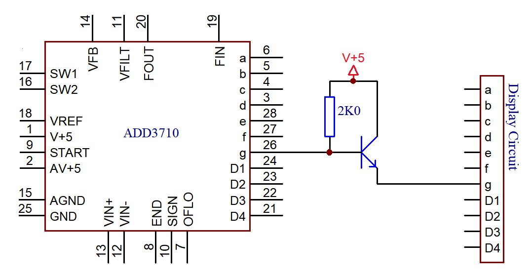

Display segment fault, Thurlby PL320 with ADD3701 display chips.
As mentioned I partially fixed a faulty ADD3701 display chip by a simple pull up resistor.
After a while I realised that the ADD3701 has a broken (open circuit) pull up fet on its segment g output. The pull down fet is working as specified. So I added the attached circuit and it fixes the missing seg g completely (for over a week so far)!
Quite a nice little chip, pity it became obsolete. The Intersil ICL7107 is still produced.
