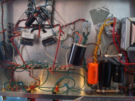

Nice clean build.
Yup, the PS trafo will run warm if not hot in a SE amp, I was concerned too but don't worry.
What rectifier tube are you using? If its not a 5AR4 try one of these (Sovtek ones seen to work well) and you will get some more volts on the B+. Also the lower value cathode resistor may pull some more amps and drop the b+ a little.
Cathode to earth is more like 12v on mine I recall.
B+ and how to
Hi to all!
Actually, I got the notification a little bit late, and I was even later with replying (should invent a time-flow enhancing machine to make 2 hours of free time into 4 hours where everyone else around me is frozen...).
If you are using a 5U4G, the B+ is most probably some 15V lower than it would be with a 5AR4 (GZ34). Therefore, just replacing the rectifier should do the B+ trick -- but the 5U4G sounds better than the 5AR4 (obviously this is an individual taste statement, but most would agree). You can get interesting results as well with a GZ37 (good looking, too).
When it comes to the 270 ohm Rk for the output tube, if you use a 300 ohm resistor, the current draw is lower therefore the B+ which is unregulated will tend to rise. BUT, this is not the correct way as the tube will draw less current and not operate at the "designed" point.
Furhtermore, the warm power tranny could mean that it is not powerful enough for the task (depending on how warm). I personally prefer over-sizing the PS. It is possible that you are not getting the B+ as wished because the circuit draws more current than the power tranny is able to give (thus a reduction of AC output... etc.)
Check all of the above and let us know what does the trick.

Well the transformer is 300-0-300 as the schematic call for, am very new at this 3 moth ago i did not know how to read a schematic but i was determined to learn about tube technology .anyway i try to stay as close as i can to your schematic accept for the choke and the cathode resister which i will get the right one (270ohms5watt) soon .
as for the transformer i do have 375-0-375 that i can use if you think is a good choice.
BTW: MR ALEX thanks for sharing the RH84 as for now i'm very impress with it and because its my first built ever it is extra special .

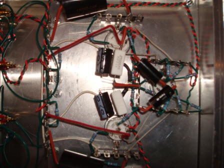

oh and here's another pix please let me know if i need to change things around .

rh84 "hot" transformer
ok guys .
i have come to a conclusion for my low b+ and the hot transformer , after closer inspetion the trans also have some "buzzz" not a good sign, after all it did come from an older amp i have so am going to get a new one (hammond 600vct@250ma--5v@4a sec--6.3v@8ma) i think this should be plenty.
let me know what you guys think.
thanks
Tim
ok guys .
thanks
Tim

low B+ and now highB+
hi guys
after a few days trying to figure out my low B+ (250) i decided to upgrade to a beefier Power transformer 600ct@250ma ,overkill i know.but anyway now B+ is 354, plate@345 and the cathode @11v so after the math im getting (i hope this is right) 11v/300ohms=37ma
plate dissapation@11.99
is this too high?
is this ok?
what my solution?
my buddy sugesst puting 100ohms before the choke to lower the
B+.
Thank

I would not be too concerned with those plate voltages, assuming the overall dissipation is kept within reason and there are no visible signs of overheating (red glow on the plates). I have operated 6p14p (Russian EL84 equivalents) at over 400 volts on the plate, both in fixed bias and cathode biased amplifiers. It might be worthwhile to investigate whether the 12AT7 is still operating at an optimal point with the higher supply voltages.
I would hesitate to drop the B+ by simply burning up the excess volts in a big resistor. You'll make a lot of waste heat and add a lot of unwanted impedance to the power supply. Instead, maybe consider reducing the value of the capacitor between the choke and the rectifier tube.
Lowering the value of the first cap (it is shown as a 47uF, 450V part on A.K.'s schematic) will move the whole power supply closer to operating as a choke input filter. If you are seeing 354V B+ with 47uF, I'm guessing something around 2uF will get you the 300V you want.
Thanks TY
hey thanks for the reply that really make me feel allot better, i was very concern about the high plate voltage but also did read that some do run them pretty high i wasnt sure .
BTW: i also measure the voltage at the anode of the 5u4 and it's @ 390
that seem odd to me because the PTX is 600CT@250MA why am i getting 390V? then again im a newbie .

I expect that transformer manufacturers give the output voltage rating under full load. If you don't pull the full 250 mA out of it, you'll likely get higher than 300-0-300. In your case, you are getting 390-0-390.
Is your PT a Hammond? Hammond transformers have a reputation for putting out way more volts than they are rated. Another issue with the Hammond units is the 200 series power transformers are all designed for 115VAC primaries, but nowhere in the US will you actually find a wall outlet with the voltage that low. My line voltage usually runs upwards of 125VAC or more.
It might be worthwhile to check the 5.0V and 6.3V filament windings while the amp is running and verify they are not running too far above spec. Over volting the tube filaments can substantially shorten the tube's life.
tim614 said:BTW: i also measure the voltage at the anode of the 5u4 and it's @ 390
