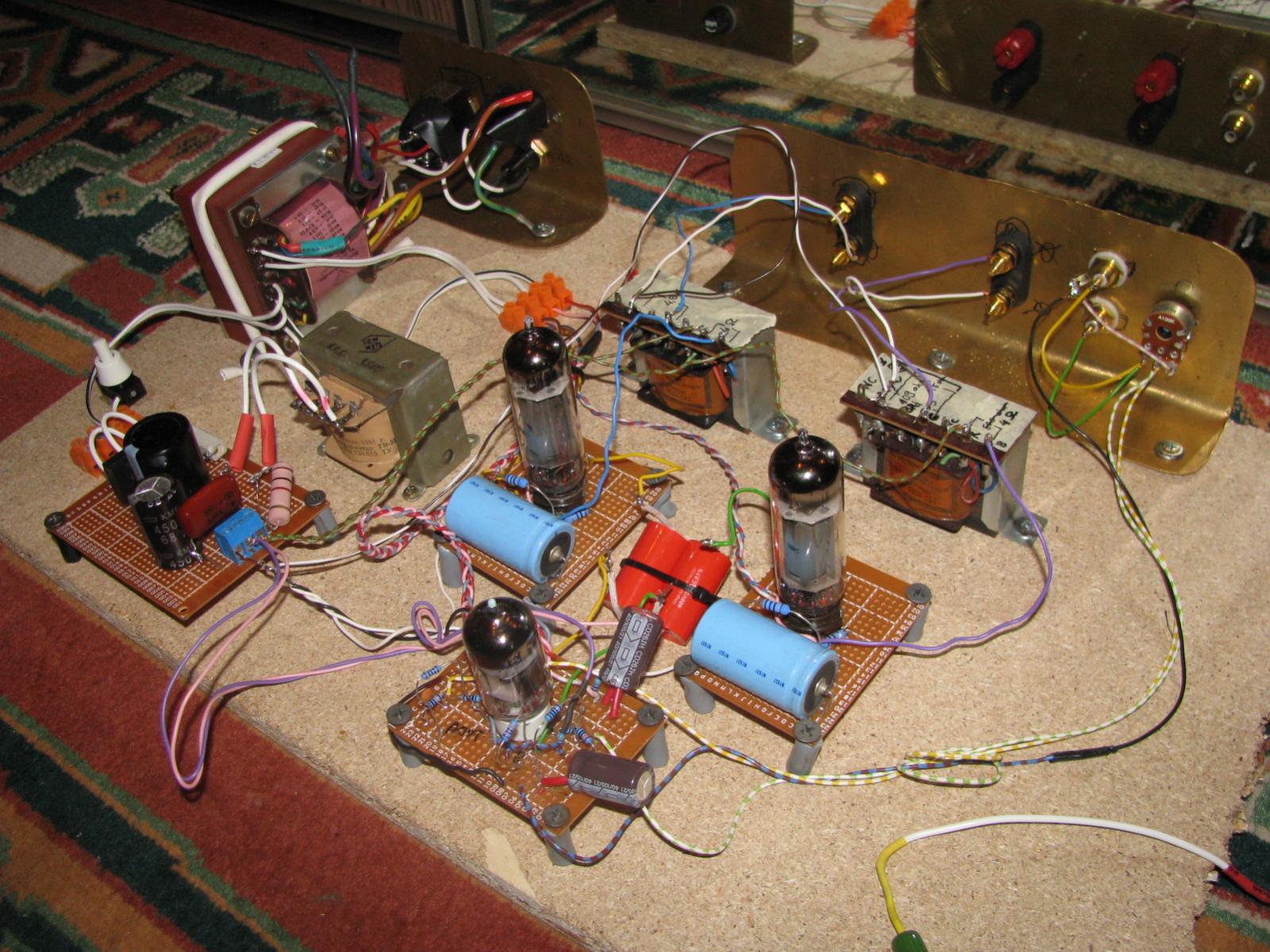

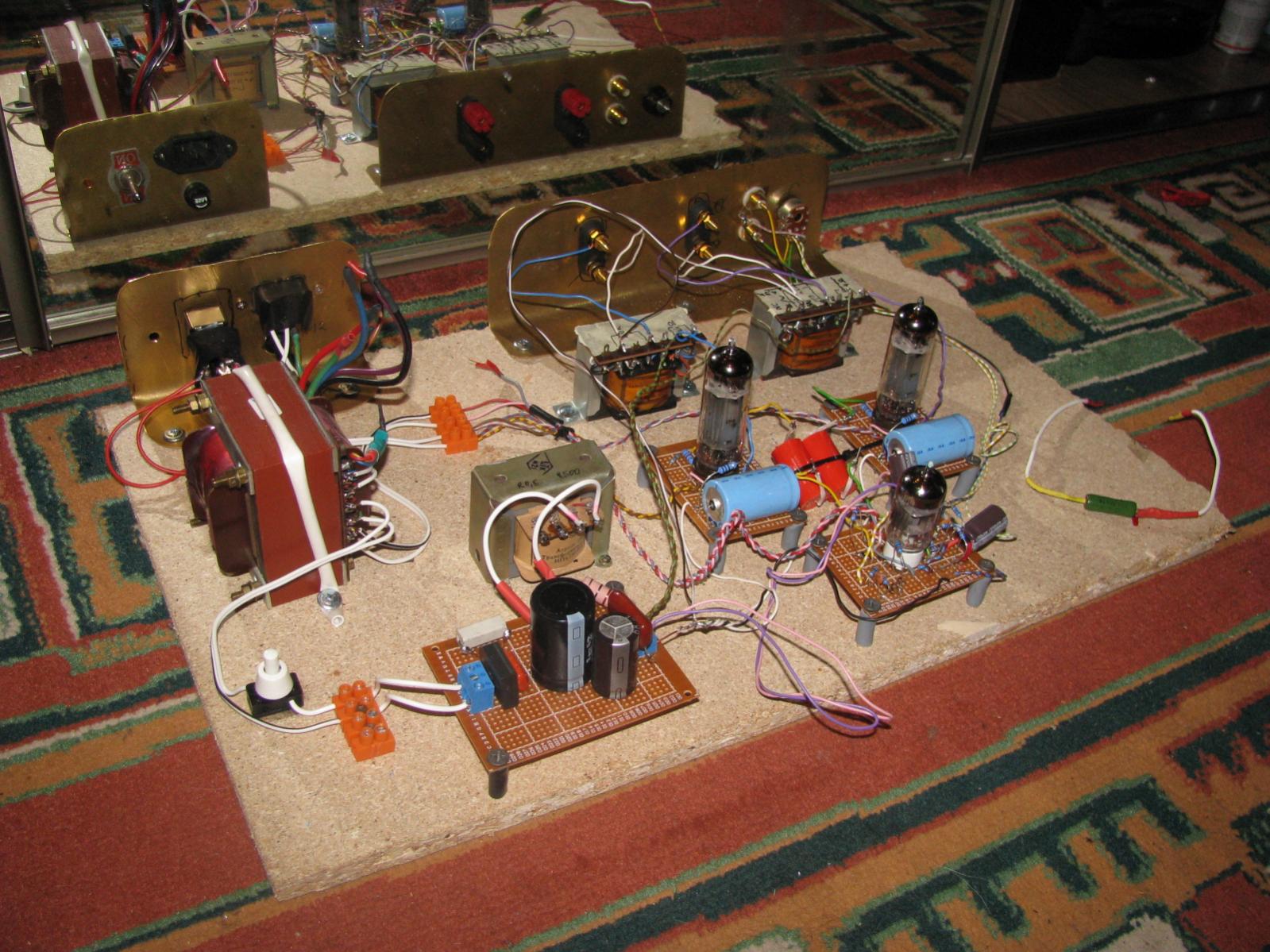

Just for the fun if it, here are some photos of this ugly thing. :)
The right edge of the particleboard was cut to measure by the stongest man in the village using brute force.
The machine is built of electronic waste, except for main power switch, some connectors and a few resistors.
