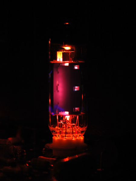

I measured 10.4 Volts across the shared 110 Ohm cathode resistor, which is 47mA per tube. Another volt is lost across each tube's separate current sense resistor (2 Ohms) and trimpot (10 Ohms). The B+ is actually (301 - 12) = 289, so the power is 289 * 0.047 = 13.6W per tube (measured at the cathode). I have 1k resistors on the screens (this was a mistake, I will be changing to 150 Ohms), so the screens aren't contributing much power dissipation.
Pictures attached. Plate seems to be "glowing"? Might have to dial down the current a little bit. With 300V B+, each 10 Ohms of cathode resistance changes each tube's bias current approximately ~2mA. Will change the cathode resistor to 120 (45mA) or 130 (42 mA), and also change those screen resistors while I have the soldering iron hot.

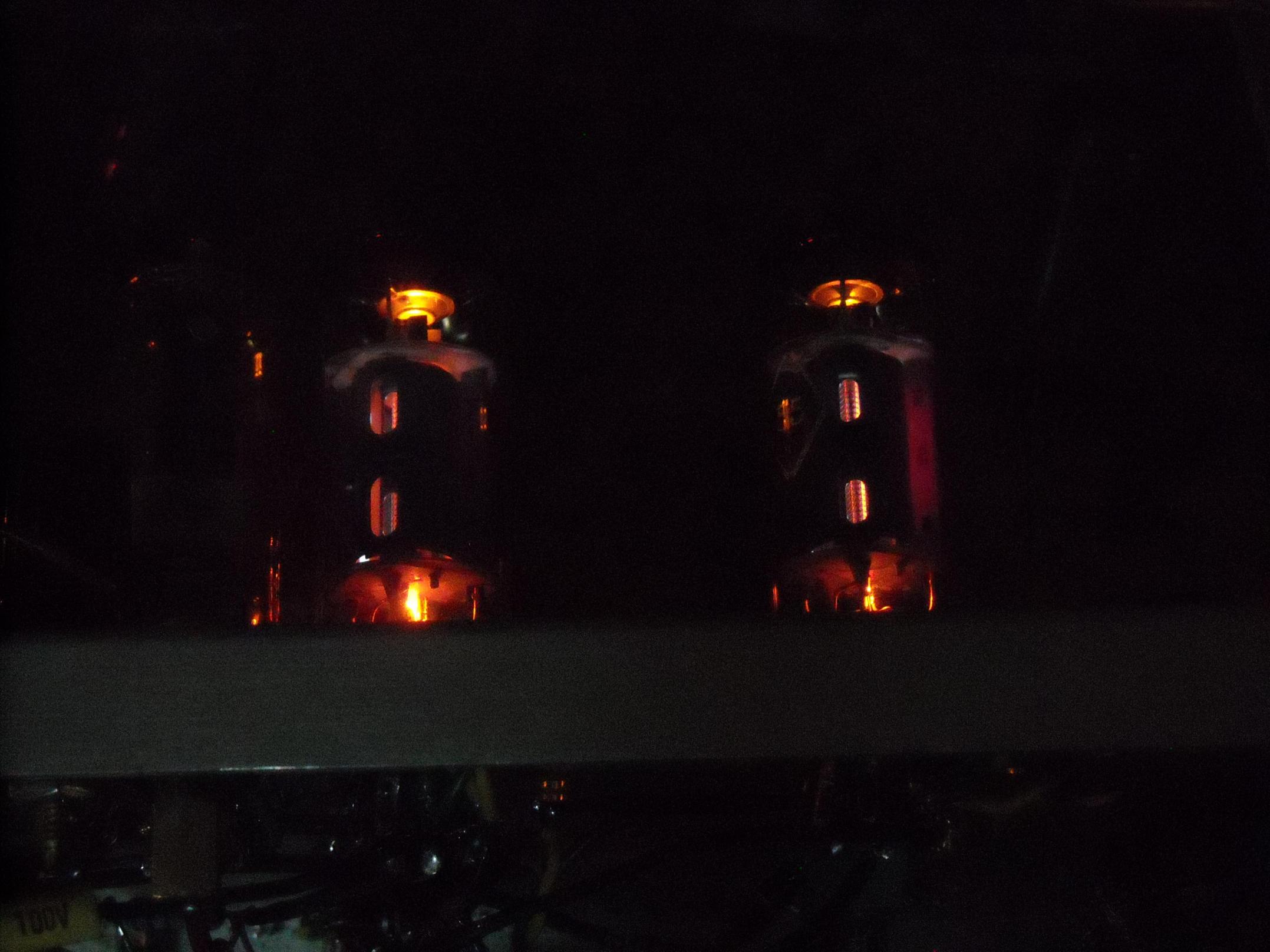

Oooo! That's hot.
I find the 6P1P (similar to EL84/6BQ5/6AQ5, but with slightly lower plate voltage and PD) is slightly red along the plate seam at 13.5W and plan on backing down.
It seems to me that I can see the red out of my peripheral vision better than I can looking at it straight on.
Here is the worst I've driven mine in comparison to yours. Mine is streaking from the center of the fin up and down, but not to the area of the plate that is actively driven.
I'd certainly recommend dropping your cathode current slightly to improve longevity.

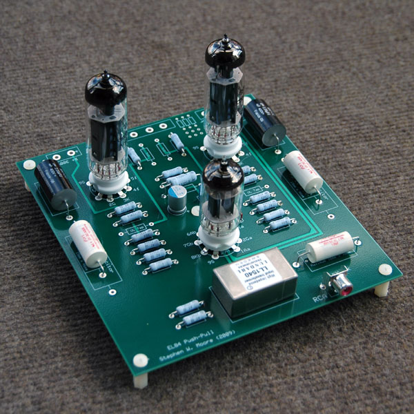

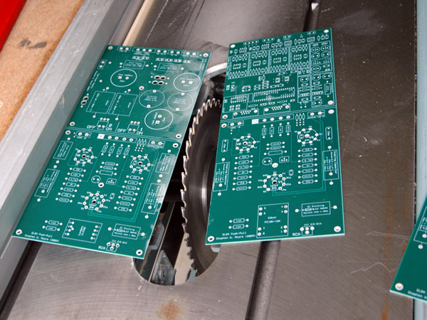

Kashmire - Neat circuit board, by the way. Where did you get it?
Made it with ExpressPCB. I occasionally need to make some circuit boards for work projects. Since ExpressPCB offers a 12"x14" maximum size, I usually make four 6"x7" boards and cut them apart with my table saw.
The bulk of the cost of ExpressPCB is the "setup fee". The incremental cost between a single 6"x7" board and a whole 12"x14" pizza platter is small.
Therefore, in this case, I needed to build a digital sensor board for a work project (upper right board).
So, I threw in a 300V B+ power supply (upper left), EL84 push-pull with LL1540 (bottom left), and EL84 push-pull with Edcor (bottom right).
My next PCB project will include: KT-88 SE, a driver stage for my massive KT-88 push-pull, and a better power supply board (which will also be capable of up to 425V B+).
