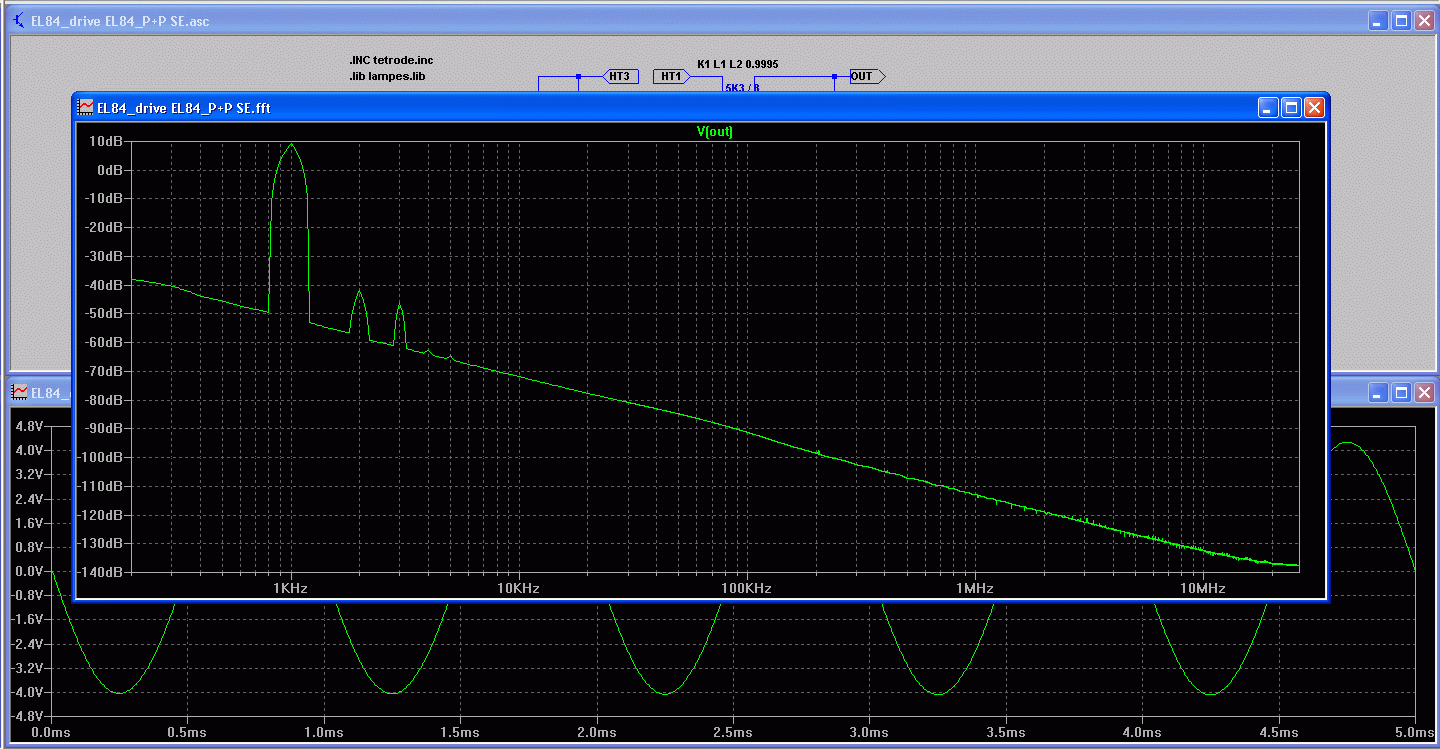

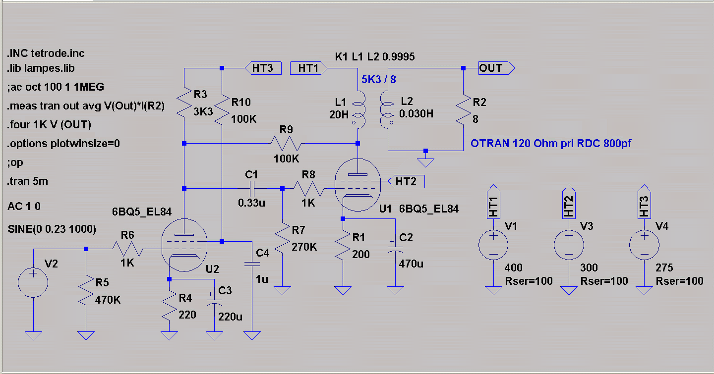

I don't have the knowledge to comment on that but I have seen standard designs where the author has decided that a pentode tube run in pentode mode offered the best sound for that application.
yes, yes, its probably a fine amp, simple and cheap to build
and maybe I have misunderstood what I read about the distortion cancelling of triodes
maybe it meant that the Sakuma principle has more effect on genuine triodes, distortion wise
meaning that pentodes have a more effective principle of their own to lower distortion, UL(ultra linear)
I might suspect that one reason this amp was found to sound better in pentode, could be power related
I dont know if there are any standard SE opt with UL tap, but might have been worth a try
one reason why I suggested to make it pushpull
but as you said, not in the cards
