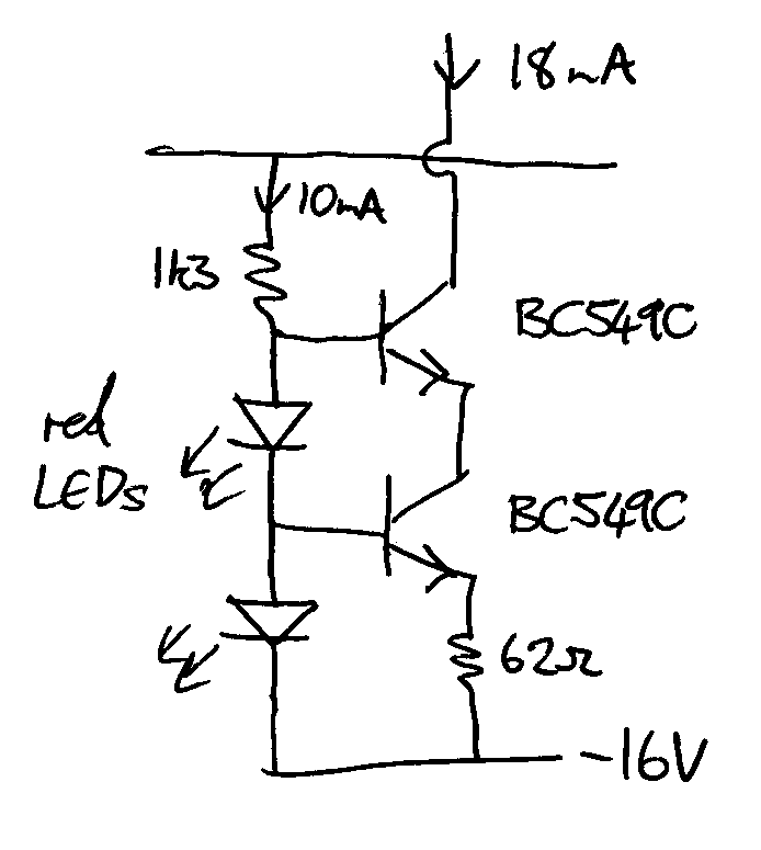

kooltubes said:
I was thinking biasing the ECC99 (differential) at about 18 ma as suggested by JJ, common cathode via LM317T and 68R resistor between Adj and out connected to -16V
You definitely don't want to use 317 in the audio department, it's a voltage reference plus a 741 connected to a sluggish power transistor. If you're only passing 18mA, you can make something much better out of discrete transistors. A cascode would do nicely. Transistor type isn't critical, neither are the LEDs.

The Nardi circuit works in a very similar way to the cascode circuit that I posted, but it's a little easier to understand the cascode first, then look at the Nardi circuit.
Looking at the left hand side of the cascode circuit, there are two LEDs in series with a resistor. There is 16V across the whole chain. A typical red LED drops about 1.65V at 10mA, so let's drive 10mA through them. That means that the LEDs drop 3.3V total, so there must be 16V - 3.3V = 12.7V across the resistor. If there's 12.7V across the resistor and 10mA through it, then its value is 12.7/0.01 = 1270 Ohms. 1k3 is near enough. So far, we've simply lit a couple of LEDs, but the significant thing is that LEDs make quite good voltage references, so in addition to producing some light, we also have a voltage reference at the bottom of 1.65V.
Now let's look at the lower transistor. To make life easier to understand, we'll treat the -16V rail as if it were at 0V. (You'll soon see why.) It takes about 0.65V across the base/emitter junction of a transistor to make the collector/emitter path conduct. Let's assume that the transistor is conducting. If we have 1.65V on the base, and the base/emitter junction is dropping 0.65V, then there must be 1V on the emitter. Neither the base/emitter drop of the transistor or the LED voltage change very much with current, so that 1V is pretty well fixed.
We now add a resistor between the emitter and the -16V rail. It has 1V across it, and we know that we would like our CCS to pass 18mA.
Small transistors like the BC549C have a very large current gain. This current gain is either known as hfe (hybrid model, forward mode, emitter as common terminal), or beta. The current gain is the ratio of collector current to base current. For the BC549C, the manufacturer guarantees that beta > 400. This is very significant. It means that if 18mA is flowing into the collector, only 45uA has to flow into the base. Our reference chain (the LEDs and 1k3 resistor) passes 10mA, so drawing 45uA away from it will not change the voltage across the lower LED.
Take the last two paragraphs together, and we see that if we put a resistor between the emitter and -16V rail, it will have 1V across it., almost no matter what. So let's do that. 1V/0.018A = 55.55 Ohms. So why did I write 62 Ohms? Must have been a mistake!
Now for the clever bit. If we take the collector of the lower transistor to the cathode of a valve, it will force 18mA to flow, and the voltage at the cathode of the valve will adjust itself to accomodate as the valve wears out or if it is swapped for a different valve.
In practice, as the voltage between the collector and emitter of a transistor changes, so does the current. But only slightly. The way we get around this is to observe that looking down into the collector, the current gain of the transistor has a multiplying effect of the emitter resistor. In our case, we used a 56 Ohm resistor, and the current gain is 400, so looking down into the collector, we see 400 x 56 = 22400 Ohms. An ideal CCS would have infinite resistance.
Let's add another transistor on top of the first (making it a cascode). If the upper transistor also has a current gain of 400, and the resistance looking down to the -16V rail is 22400 Ohms, then the resistance looking down into the upper collector is 22400 x 400 = 8960000 Ohms. 9M is a pretty good constant current sink (unless you're Gary Pimm).
Finally, to make the lower transistor work, we need to drop some voltage from the collector to its emitter, and that's why the second LED is there, it forces 1.65V across the lower transistor.

You're welcome. Yes, I expect that is exactly why Nardi recommends that particular LED. In case you're wondering why he should do something less than perfect, the alternative would be to take a resistor down to 0V. The trouble is that it would dissipate a lot of power, making it hot and expensive.

Hi EC8010,
Thanks for the CSS circuit, I've just finished building the amp; it sounds good for a 5 watts'ish (PP EL84 triode connected).
It worked fine, the first time, without any hum and bang.
I had to tweak the current on the ECC99 to get a better sound; I am running the differential driver at about 21 ma pe tube, yielding to an anode voltage of approx 140 volts.
