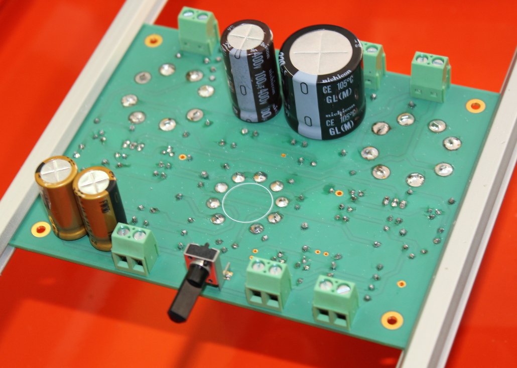

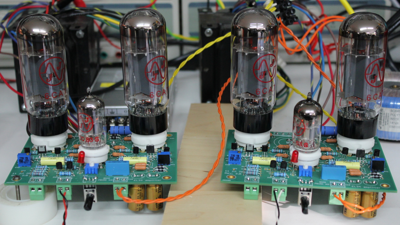

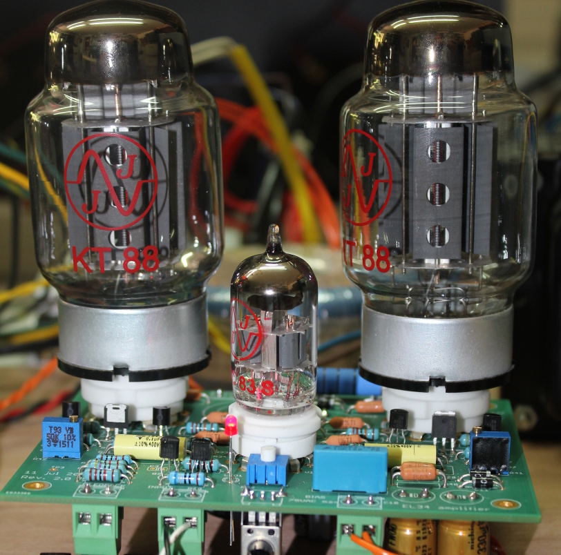

Yes, it is recommended to use bigger capacitor if you can insert them, if you cannot it is possible to keep the lead long enough to solder them without any problem :)
In the BOM I even suggested 330 uF 100 V like Nichicon UFW2A331MHD, I used them they are a little squeezed but can fit :D (see photos)

Hi Marc et all,
I am going through the documentation you posted in your GB thread, and I have few questions regarding the amplifier.
1. How much current = mA will be enough per channel? You mention for stereo is sufficient 300 - 400 mA, I might use 2x 6CA7 tubes and I have to order power transformer and provide details.
2. Bias power, again you mention in documentation that, 50VAC and 50 mA will be enough, but is that current enough for two channels or is required more? In other words, will 10VA will be enough for two boards?
3. Feedback connections - what are these for? Negative feedback? Is it required to connect?
4. What will be power output when use 2x EL34 or 6CA7?
5. Output Transformer - Can I use Ra=4k instead 0f 4.3K suggested, and 40W rated power?
Many thanks,
bekim

Hi bekim,
Several persons already give you good advise about transformers, but I would like to give you more details :
1) The current that you need will in fact be dependent of the output tubes that you are using and of the supply voltage between 350 V and 450 V. By exemple a 6V6 will consume half the current of a 6CA7... With the 6CA7 and the Hammond 4.3k output transformer on my amplifier I use a toroïdal transformer of 250 V AC and 300 mA and it is not very hot :)
2) The 50 V AC transformer will only supply few mA on the negative side for the input differential amplifier and the output bias as well as few mA too on the positive side for the MOSFET driver. With 50 mA you will have more than enough capability, 10 to 20 VA will be perfect, I suggest a 2 x 24 V AC because they are quite common :)
3) Feedback connector is, in principle, not needed in a Ultra Linear or triode version, it can be required in pentode version (I haven't tested that !). I know one case where a builder use it for a differential input---
4) The output power will be dependent of the voltage and of the output transformer, I will say between 30 W to 50 W :eek:
5) Yes, you can use a 4k transformer and 40 W will be enough if you don't push your amplifier with more than 400 V anode voltage ! I recommended a Toroidy 4k 80 W output transformer : TTG-KT88PP TOROIDY - Transformateur: de haut-parleur | TME - Composants electroniques
Marc
