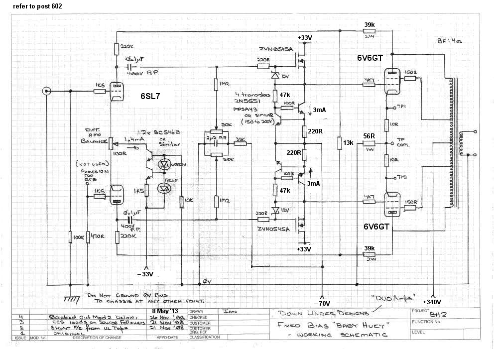

Notes for the 6SL7/6V6 version in the picture back a few posts.
Grab the post #602 schematic.
The common resistor in the 6V6 cathodes is 56R in lieu of the 10R shown for EL84.
The 390R in the current source loads on in the mosfet source followers is 220R to increase the current in the source followers to 3mA.
The 220K in these current sources reduces to 47K .
The 47K + 16K + 47K between the output tube anodes is 39K + 13K + 39K instead. 6SL7 anode loads are still 220K as shown for the ECC803S
There is a 10R + 2u2 zobel added across the 4 Ohm speaker output.
The +56 Volt rail is now +33V
The -48V rail is now -70V
The -45V for the diffamp CCS is now -33V
B+ is +340V

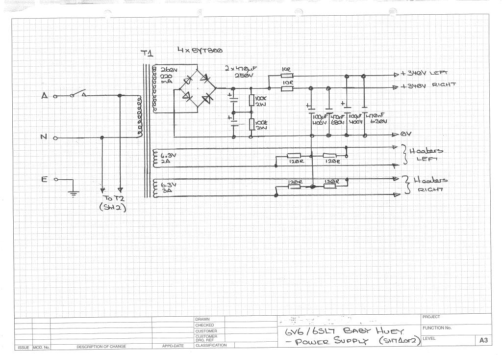

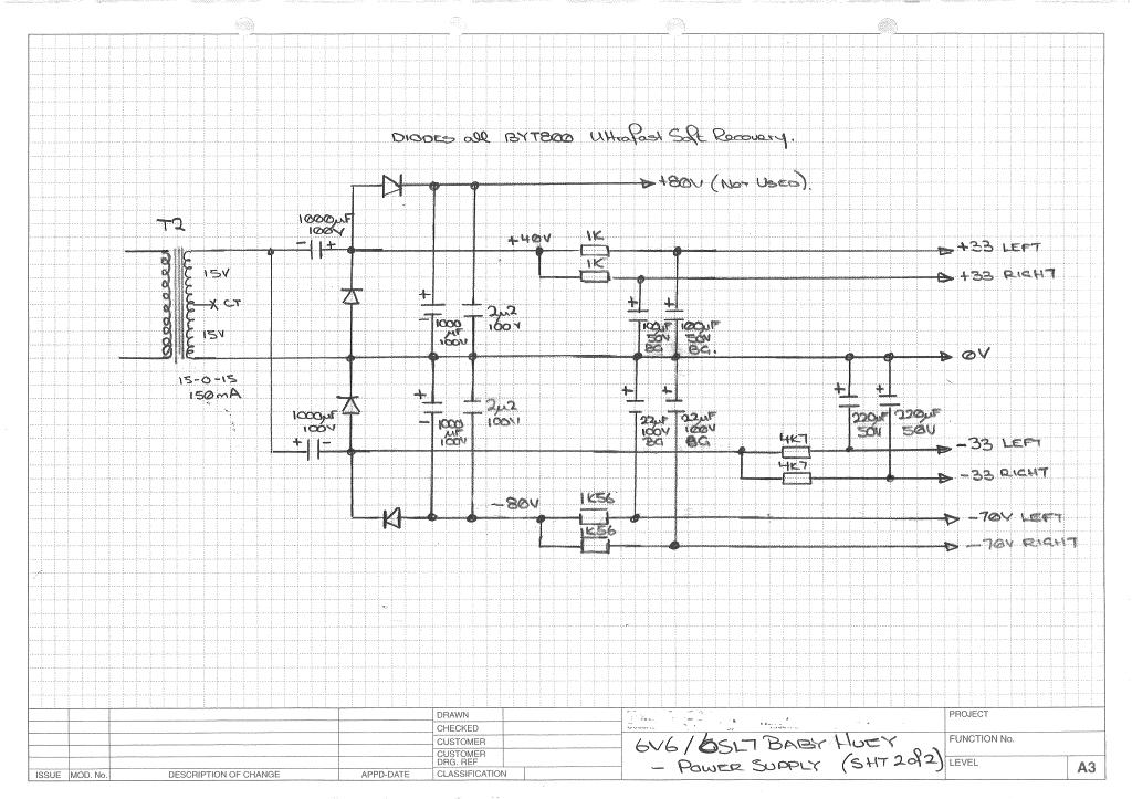

Here are the power supply schematics, Note I used a second small tranny (4.5VA) to generate the low voltage supplies.
In post #1349, Ian was kind enough to post the various changes made to the 6SL7-6V6 version of the Baby Huey. I took that info and added it to the older 6SL7-6V6 version from post #602.
So here, for the record (and given a check by Ian), is the compleat collection of schematics for the current-issue 6SL7-6V6 Baby Huey.
(I want to build this one with smooth plate Telefunken ECC83 and Russian 6P1P-EV)

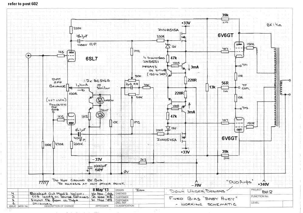

I have a question about the -33V supply and how it is connected to the 6SL7 tails.
Looking at the schematic, I see it bypassed to ground by a 1000uF 50V capacitor. Then it goes from there to the junction of a 2k2 resistor and a 33k resistor, which connects to the -70V supply.
I have to admit that I'm baffled by this. I guess I'm showing my lack of understanding of voltage dividers, etc.
I see how the -70V feeds the bias network (ganged 50k pot and 1M2 resistors to the gates of the ZVN0545A's), but that shouldn't be drawing appreciable current.
I assume the -33V rail connects at the junction of the cathode of the blue LED, 1k5 resistor and 1000uF cap, which connects to the BC546B ccs.
So, what is that 2k2 resistor doing there, connecting the -33V rail to the -70V rail? I don't get it...
Drewaudio,
negative rail for the source follower needs to be approximately 3 times the bias voltage such that the signal to the output tube grid can pull down far enough to definitely cut off the output tube. For 6V6 that requires around -60V minimum whereas for EL84 -35V would probably do.
rogon,
A bit confusing, sorry. The new power supply drawings show the " local for each channel" power supply decoupling components, ignore the duplicates on your markup. That is,
the 2K2 and 1000uF from the -70V are deleted and the point you have marked -33V comes direct from the power supply where you will see that this supply has 4K7 + 220uF decoupling instead. Hope that clears this up.

The 12AX7/EL84 fixed bias version is the post #602 schematic which rogon has marked up for 6V6. The change to the source follower current (increased to 3mA, see the 220R and 47K markups) are recommended for this version too. You could also use just the +/-33V part of the power supply schemtic above, reduce the 4K7 resistors to say 1K to give a few more volts.
The "simple" CCS biased version schematic is way back on page 1
