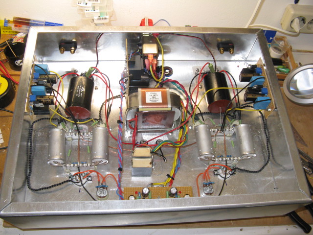

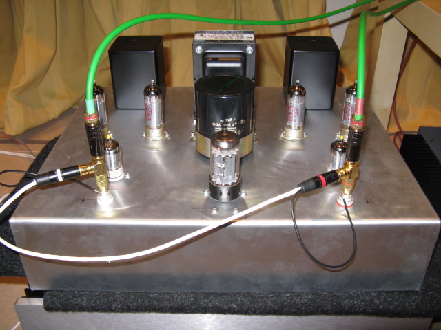

Just finished building my Baby Huey.
Very happy with the sound right now, and the build was not so difficult with all the information inside this thread.
I use a Hammond 370HX mains transformer and Hashimoto output ones.
All plastic caps for the HV and tube rectification. HV now is at 290V, I will increase the first capacitor later to go a little bit higher. Also will add a balance input.
Interstage caps are FT3 100n, as the amp will be used from 80Hz up.
The big choke is a Lundhal 1673.
El84 bias is with dn2540 current sources a la Bas, and here I have one question how to adjust them in the circuit. Should I balance the voltages on the cathodes of the El84 exactly or should I leave them as I tested outside of the amp for 38mA? Right now they are around 9V.

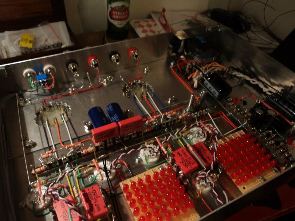

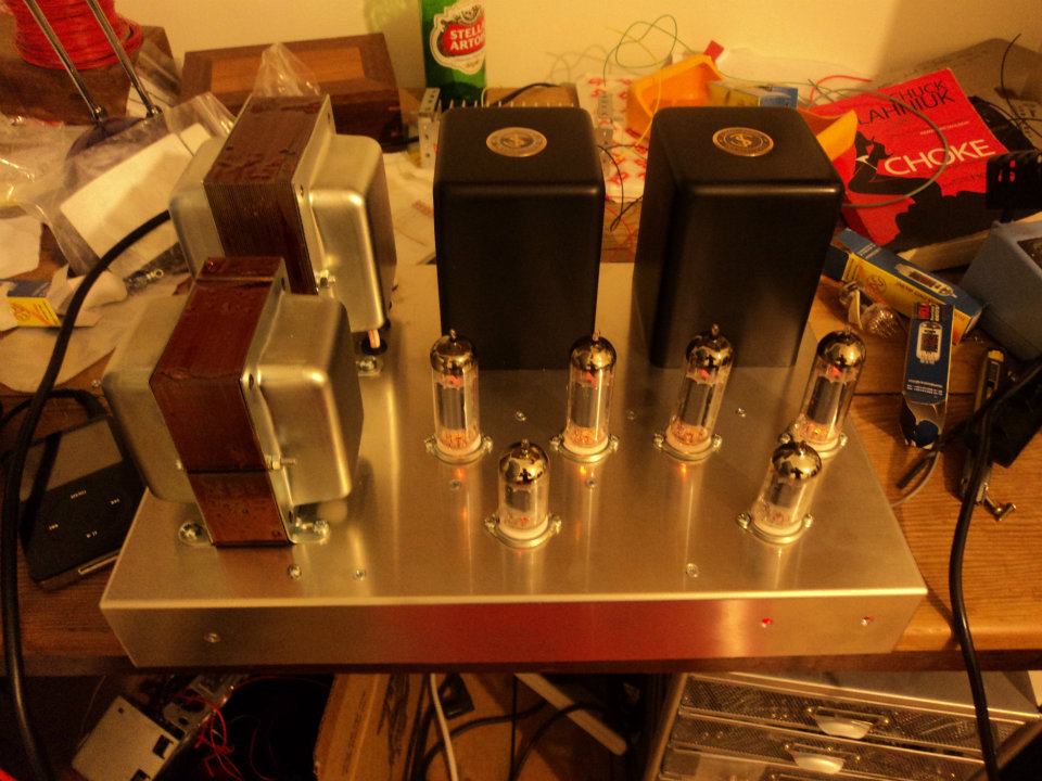

Some pics.
A friend is building a nice wooden case for it, so I am looking forward to that, but not looking forward to the extra weight!
I call it Soho because of the tall buildings and the sleezy RLD :)
Thanks to all for your help
