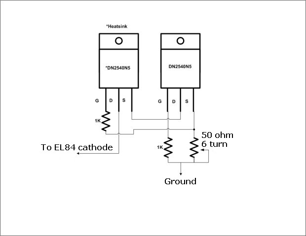

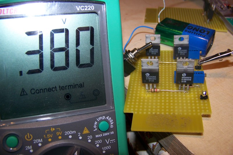

Ian,
I've been meaning to ask for a while what the 470ohm resistors are for in the driver stage? Since the CCS determines the current through them.
Also. I've built the bias blocks as shown in the attachments. Just to be sure. They should work right? (Just have to bypass them still).
Kind regards,
Bas
Bas,
The 1K pot is to set balance in the diff amp. The resistance in the triode cathode degenerates the tube gm (Ia/Vgk). Sweeping the pot wiper from side to side varies the amount of degeneration on each of the 2 triodes until they match. This is the minimum distortion condition for the diff amp. As we don't want to throw away gm un-necessarily we don't want those resistance values too high - just high enough to be able to adjust for matching behavior.
For a random sampling of 12AX7 and ECC803S that I had, 1K was too much, 100R was'nt quite enough so I dropped the 470R on each side of the 1K pot which effectively makes that pot about 600 Ohms (about 300 Ohms each side of the wiper when set to the middle). If you can find a 500 Ohm pot then you can use that, in fact if you select a tube with matching triodes then you can get away with a 100 Ohm pot.
Hope this explains what those 470 Ohm resistors are doing.
Ian
