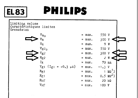

If 6P15P = EL83, then...?
I believe the Russian 6P15P is pretty much the same thing as an EL83.
If that's correct, then the max Va and Vg2 voltages should be 300V, as seen on the Philips EL83 data sheet.
Or, it might be more like the PL83 (except with a 6.3V heater), which states the max Va and Vg2 are both 250V.
No?

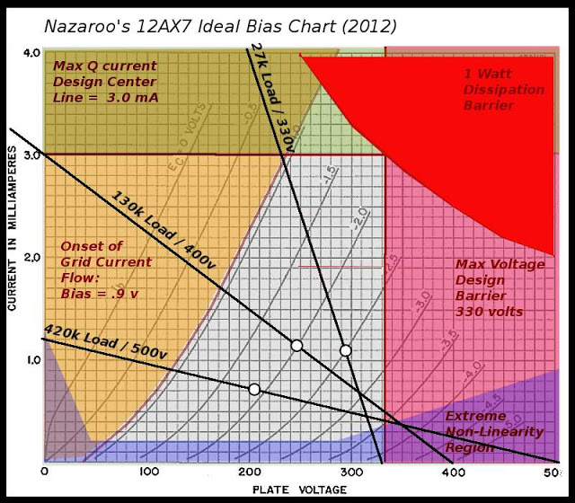

Operating conditions for the BH 12ax7
I’m trying to understand the operating conditions of the 12ax7 for the BHEL84. This started with Bas Horneman’s thread on the topic of the CCS that sets some of the conditions, and specifically the CCS current.
Could you check the values for this current source?
Based on that and his review of this long thread he concluded the CCS should run 1 ma, i.e. 0.5 ma for each triode. That in his builders thread here:
https://www.diyaudio.com/forums/tubes-valves/351919-oh-baby-huey-el84-build-6.html#post6167748
Since this is a design rather than builders issue I would like to bring the topic up here.
I looked at the 12ax7 loadlines at 0.5 ma fixed by the CCS. I expect ~130v on the plates (310/440*189) based on gabo‘s post in the BHEL34 thread. He measured 189v on the 12ax7 plates for his EL34 build with 440v B+, and with his R18 at 680k. That means 1.6 ma; 0.8 per triode. That seems to be a better operating region in the loadlines, than the one for BHEL84 under the conditions mentioned.
Since gingertube designed the BHEL84 to run 0.5 ma on the 12ax7 triodes (based on Bas’s review of the thread) something could be wrong in my analysis. Something probably is, since a lot of BHEL84 had made a lot of people happy. I hope someone more knowledgeable could help to explain the apparent discrepancy wrt. the best operating regions of the loadlines.
It would be very helpful if someone with a completed BHEL84 could measure your plate voltage (since 130v is a guesstimate of it), cathode voltage and voltage across R18 (assuming 1k, or mention what was used). Please also state your B+ at the OT centertap.

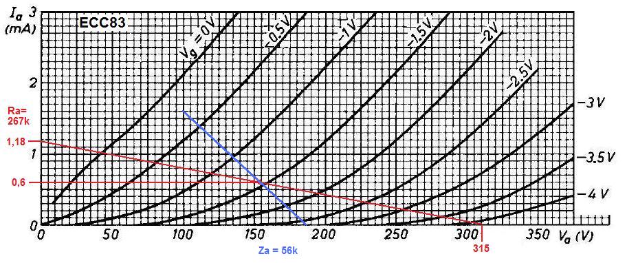

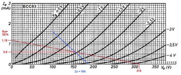

Let me try to dig into the working condition of the ECC83.
Presume Va (of the EL84) = 315V and Ia = 35mA (somewhat less then CCS , minus screen current !).Gives -Vg1=12V and ΔVa=215V (UL down to 100V) resulting in a gain of 215/12=~17x (will be used later on).
Now DC conition of the triode.Since the voltage on both sides of the 16k are the same we can forget that for now.So Ra = 220+47=267k and Vb=315V, and we can draw a load line.With the Ia=0,6mA we get a working point at Va=155V.
On with the dynamic load line.
The center of the 16k doesn't move, if one side goes up the other side goes down the same amount, and we get a voltage divider from the EL84 anode 47k to 8k = division 1/7.On the end of the 220k there is 47k//8k and a voltage 17x/7 = ~2,5 x signal on g1(EL84)=a(ECC83).
The anode ECC83 sees (220k+47k//8k)/(2,5+1)=64k and the 470k (grid leak EL84) in parallel.Makes a total dynamic load of 56k.
Looking at the curves the current could go up to 0,7mA but not more to stay out of the grid current region.

1. I follow up to “somewhat less then CCS , minus screen current”. CCS=? Constant current source? It appears you mean cathode current.
Constant current is the cathode current.I want the anode current to find out from the curves (pentode) what the resulting -Vg1 is.So I take a couple of mA off for the screen current.Nowing bias -Vg1 gives the max swing the input to the output tubes makes to get to max Ia at Vg1=0.
2. Please explain “UL down to 100V).
As Vg1 goes up to zero the anode current goes up too and the anode voltage drops.At Vg1=0 the voltage on the anode is minimal, pulling the load down, how much depends on the load.
As a pentode the tube can go as low as <50V and still pulling much current.But with UL the screen voltage goes down with the anode and the anode needs more voltage to pass so much current.
With Raa=8k it goes not down more then ~110V and with Raa=10k (less current) to ~90V.
I asumed 100V.Comming from 315V give an output (anode) swing of 215V as a result of 12V on the input (grid).
3. For the record, which schematic are you using to develop your explanation?
It's the schematic from 07-2011.The mosfet in between doesn't change much, the gain being ~1x.
By the way, the loadline is more complicated then what I have showed.The gain of the final stage isn't constant and consequently the effective resistance of the 220k is not constant resulting in a curved loadline.

4. Why do you choose Ia=0,6mA? Is this a guesstimate of where we might end up at? I’m not sure why you draw this load line. Is this a static loadline, followed by the dynamic load line next?
Bas had 0,6mA in his amp, so I used that to determine the operating point on the static loadline.
The static line is simply the DC condition of the tube, only to find the witch anode voltage you get with 0,6mA.It's the only point of interest on that line.From there draw a line with the slope of the dynamic load to check if the biggest signal doesn't drive the tube in onwanted regions (grid current, no anode voltage left)
5. I’m a little lost here with “ ~2,5 x signal on g1(EL84)=a(ECC83).” This is the feedback applied to the ECC83 anode from the output transformer, right?
signal on the grid EL84 and anode ECC83 is the same (coupling-C = short).Gain EL84 minus loss voltage divider (47k-8k) gives 2,5x anode signal ECC83 at the junction 47k-16k, the other side of the 220k.
6. Could you explain the equation “anode ECC83 sees (220k+47k//8k)/(2,5+1)=64k”. I understand the parts of the equation and where you got them, except I don’t understand “+1” , but what are you calculating and how? Were did the grid leak resistance appear here?
The effective anode resistor of the ECC83 is 220k plus 47k//(16k/2).At one end of that resistor we got 2,5x signal anode ECC83 (=grid EL84), at the other end 1x the same signal (the anode).Total 2,5+1 times so 3,5x more current with the 1x anode signal, for the ECC83 it looks like the load is 3,5x more heavy.
The grid leak doesn't have the 2,5x signal at the other side, it remains 470k (or 1M).
7. Do you consider this operating condition a good one? If not what could be done to improve?
Yes, the 0,7mA was to say 0,6mA may deviate a little without harm.
Mona
