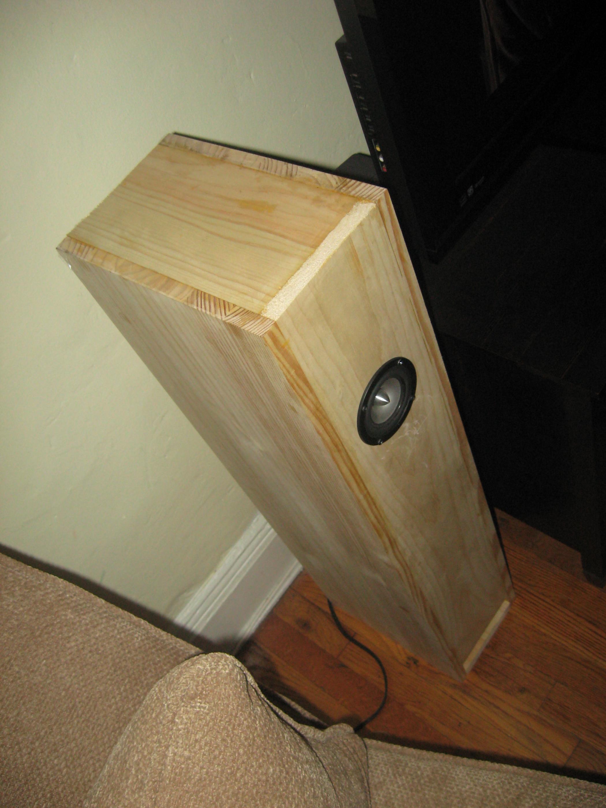

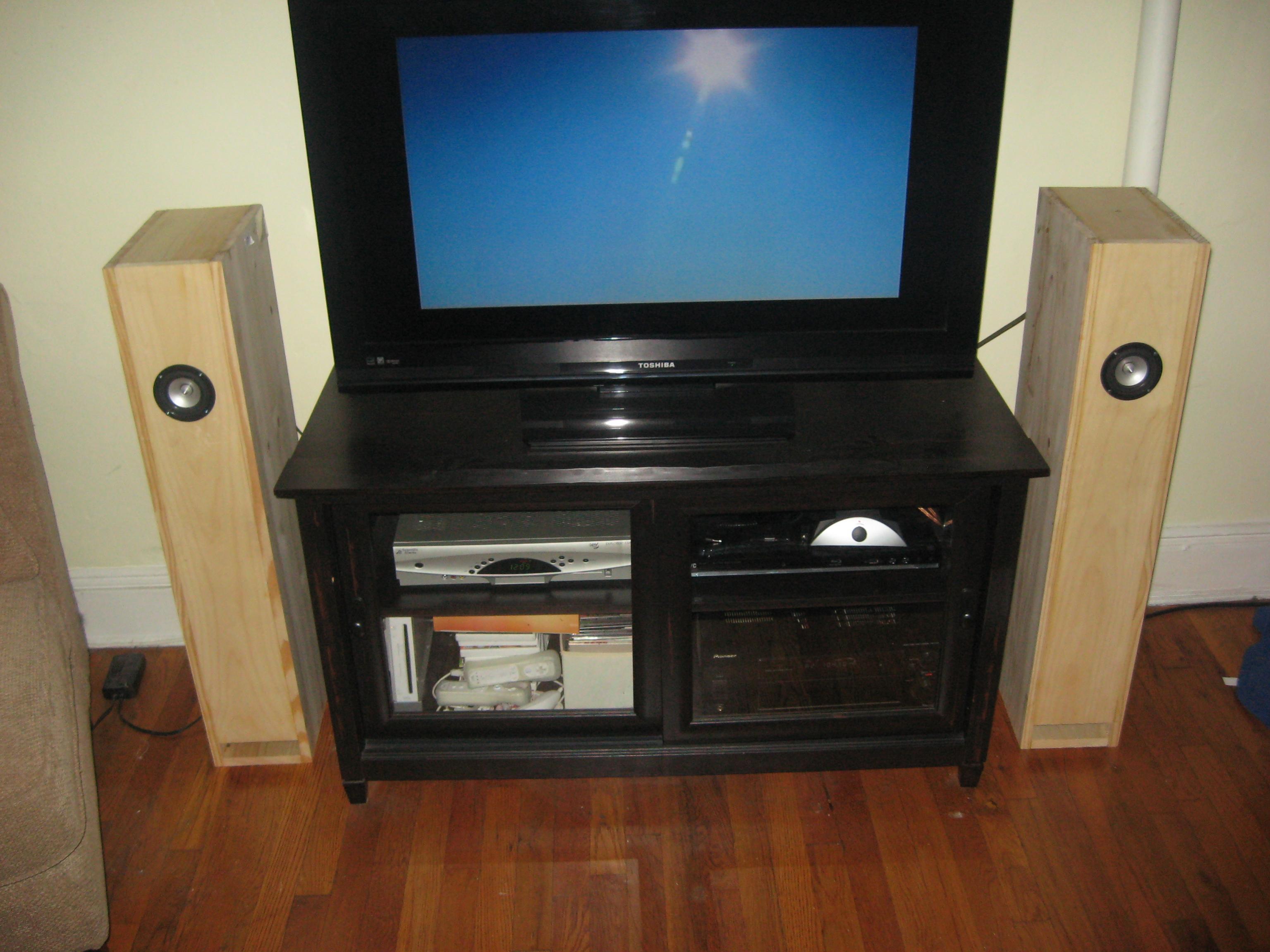

My goal was to try to salvage the Pencil cabinets that I started for the CHR-70. I was not crazy about this driver even after the recommended 100+ hours so I sold them. Was hoping to try the EL in these boxes but now I'm not sure.
Either way, I just finished the cabinets and for now I cut the holes smaller and put in my trusty pair of 871s and they sound pretty damn good - better in fact than in the Needles.
......how severely that'll mass load the diaphram though I'm not sure.

Here they are (not perfect & unfinished):
