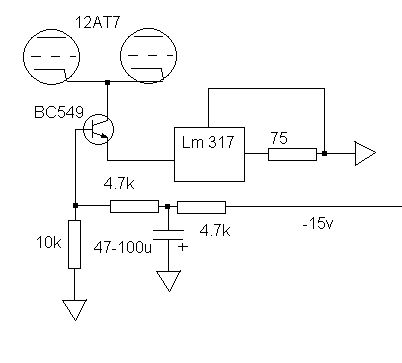

My problem with his design is his use of an LM317 as a CCS. I don't think it has good enough frequency response for this job.
do you have any ideas as to a better CCS?
This schematic seems to be the frontrunner at the moment, however will it operate outside of Class A, despite the name? and Also, should I find the means, would it be too hard to adjust this design (changes to the bias circuitry, and to the B+ Voltage) to run the Design with the EL34?
-Moose
I agree with Ray. But you can still use the LM317 to set the current. Just cascode the LM317 with a transistor like a BC549 above it (between it and the cathodes). That will extend its CCS-like behavior to higher frequencies. Bias the upper transistor with a two-resistor voltage divider. Easy and cheap.

This will be a cascode with an “o”, not a cascade with an “a” – big difference. Try this: Connect a 10K resistor to ground. Tie the other end to two 4.7 K resistors in series and tie the outer end of the second 4.7 K to the negative supply. So you have three resistors in series between ground and the negative supply (roughly -15 volts, I’m guessing). Now connect the transistor’s base to the junction of the 10K and the middle 4.7K. This sets the base at roughly 1/2 of the negative supply (roughly -7.5V). Now put a 47uF or 100uF cap from the junction of the two 4.7K resistors to ground to filter noise. Place the positive terminal of the cap to ground. The cap’s voltage rating should be 25 volts or so. Now break the connection between the LM317 and the cathodes. Connect the NPN transistor’s emitter to the input terminal of the LM317. Connect the collector to the joined cathodes. Almost any high-hfe NPN small-signal transistor should work. The reason that I don’t put a filter cap right on the base is that I want a large resistive path to ground for the nasty collector-to-base capacitance, to keep the cathodes from “feeling” it so much.

Alright, here is a schematic based on what your extreemly helpful description.
