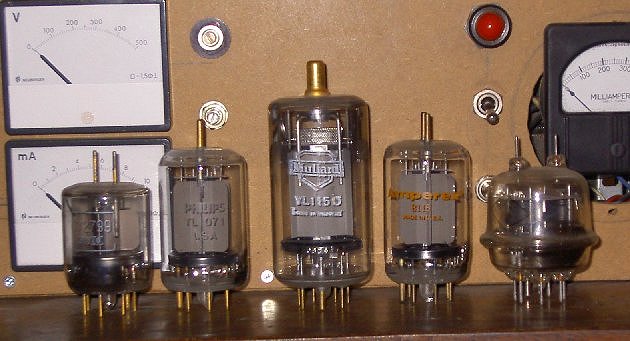

Here are my late '90's Chinese KT-valves.
From left to right:
1. Original Chinese KT88, short bulb, triple getter, big black grid fins, round holes in anode (nicknamed firecracker)
2. Unmarked, sold as KT94, bigger rounder bulb, single getter, big black grid fins, round holes in anode
3. Valve Art KT88, bigger rounder bulb, dual getter, small black grid fins, oval holes in anode
4. Valve Art KT100, large bulb, large base, dual getter, medium grey grid fins, large black anode with big rectangular holes: EL156
There was another KT100 at the time, looking like valve 1, with the short bulb and round anode holes.
The short stubby ones on the left. These will red plate at 25 watts of dissipation. Some will live in a 35 watt amp running on 400 volts, and some won't. The only tube I have ever seen spark out so violently that it shattered the glass in "normal operation." None of them will live at 500 volts!
