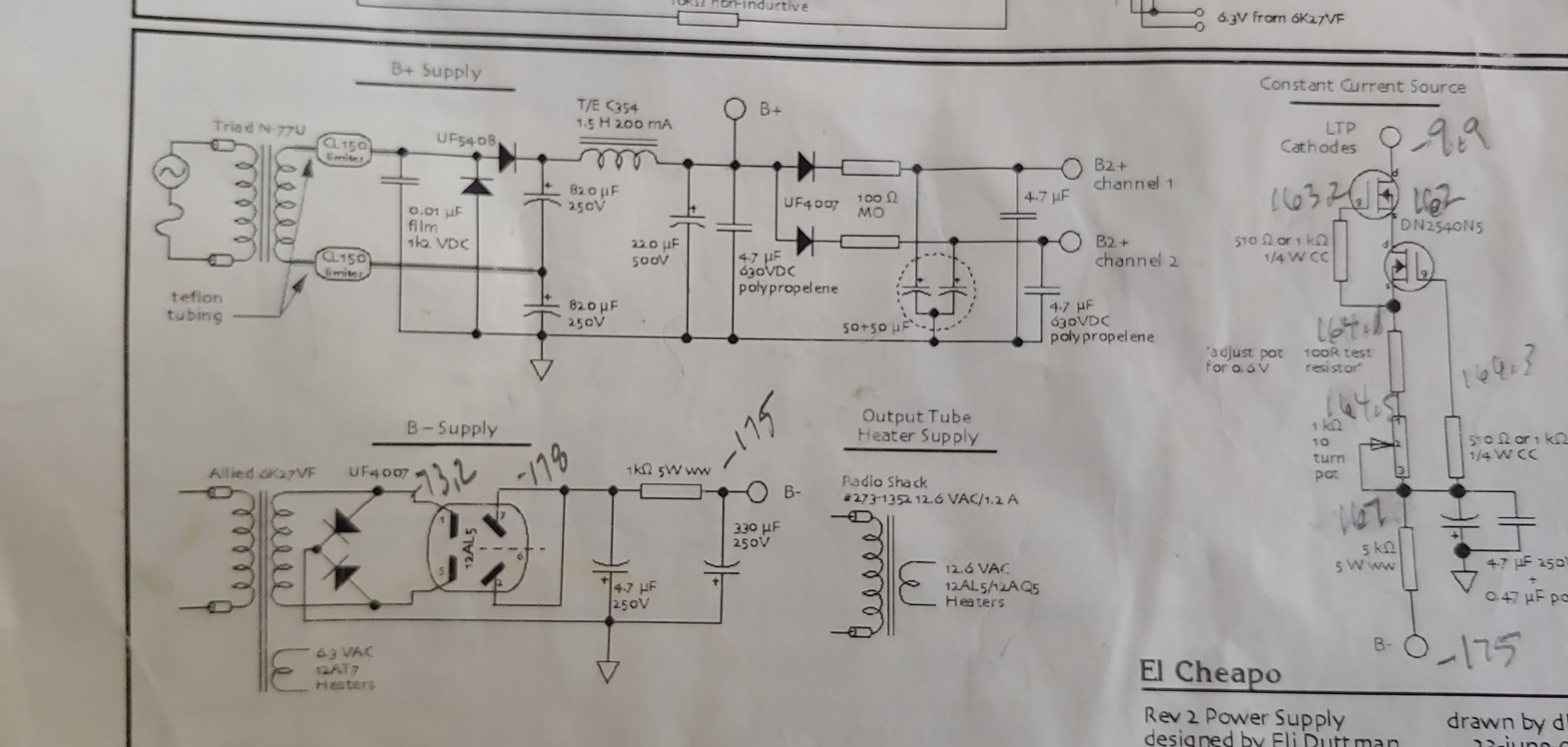

Hello Diyurselfers,
I just built the el cheapo exactly as the schematic was presented. I can't get to 6 ma on the 12at7. I triple checked everything including swapping valves etc. I have not boosted the b+ voltage yet as I want to get the t7 under control before I do. I'm posting some voltage numbers for anyone willing to help me trouble shoot.
Thanks OB

Hello Diyurselfers,
Thanks OB

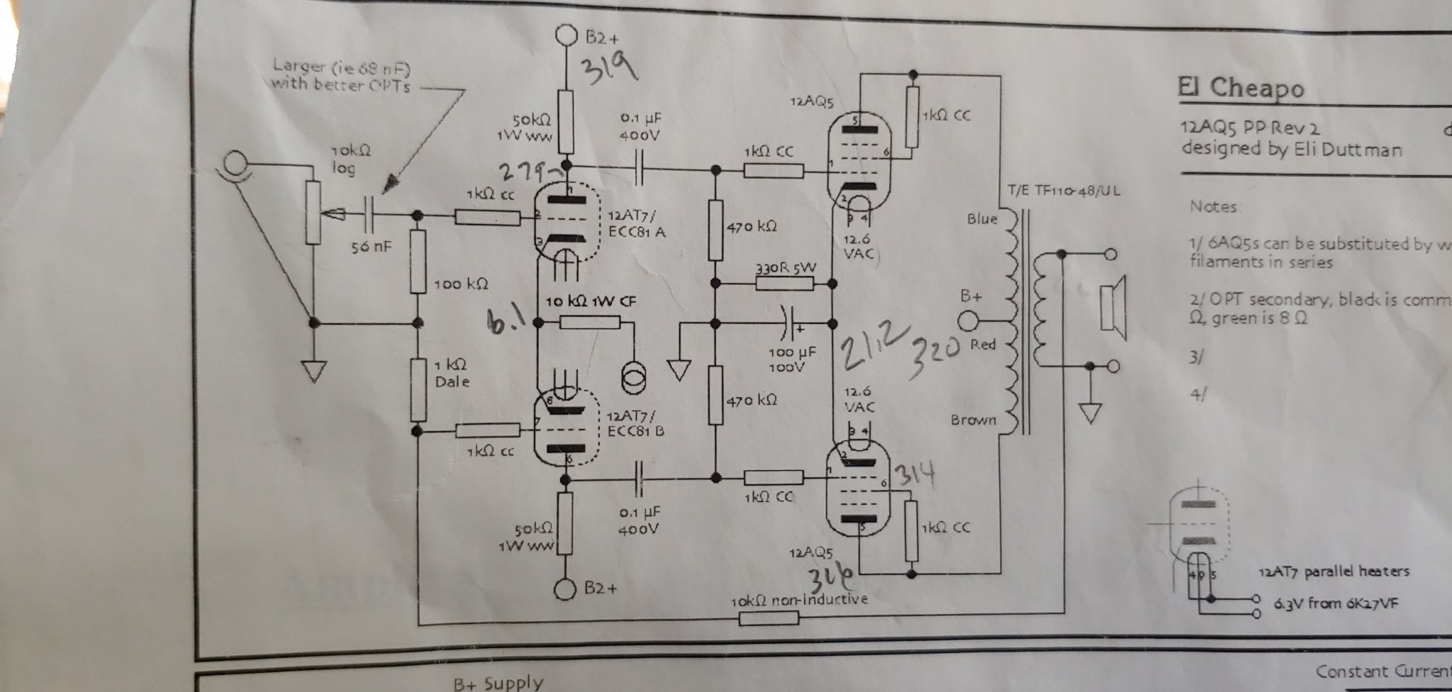

Are you trying to get 6mA per plate on the 12AT7?
You have 6.1V in the cathodes, that's too big. Something is wrong with the CCS I guess.
My bad! I'm looking for 30 volts which would be 3 ma per tube. 1.5 ma per plate. Yes I was thinking the ccs as well. I wonder if one (as I have two one per each channel) is not working will that prevent the other from working properly?
Each channel's CCS is an independent circuit, well, apart from the B- supply.

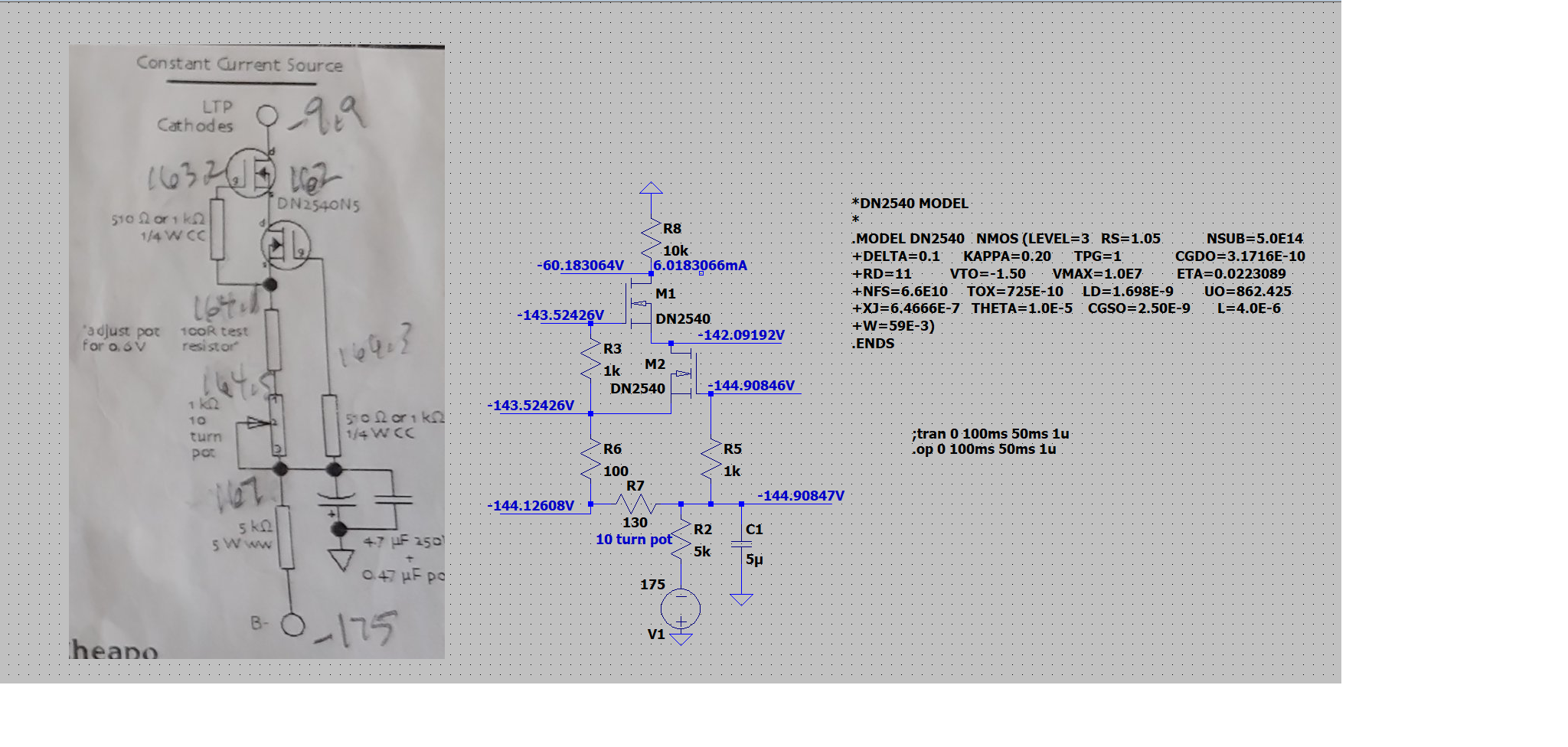

Here is a simulation that matches the real values (6mA across R8, i.e. 3mA for each plate) :

I had to order the Fets from China (ebay). I wonder if I got a bad batch?
Hmmm, it could be, these are fairly specialised high voltage depletion mosfets, I would get them from a very reputable source. I typically use DigiKey. For the record, I order a lot from e-bay/Aliexpress, but not specialised components. Digikey has very decent prices for the DN2540, I just bought 10 last week. If you spend more than £33 (UK) you get free delivery.
