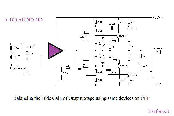

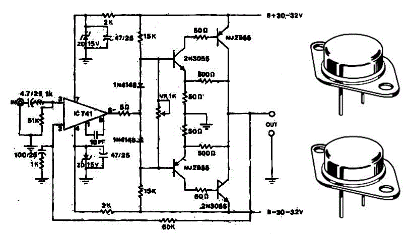

but what do you think about this news
(same driver as final on CFP)?
BV said:
Opamp at input with +-35V supply?? Wake up, Stee....
And "current limiter" with showed values is nonsens. Try some simulator before posting those "schematics".:whazzat:
Output devices are rated up to 16A. Current limiter will protect them until fuses blow. However, 1 Ohm resistors need to be rated correspondingly (I had bad experience with wirewound resistors that burst in flame recently).
It seems as if you could omit the BC546B/BC556B with their diodes and resistors in the center of your schematics in posts #47 and #50. The two diodes that are in parallel to them will always pull the bias to ~1,3 V, whatever those transistors try to achieve.
How do you compensate for the ~500 mV DC offset at the output? You should really not recommend building this thing, before it is safe to use. There are many beginners in the forum, who cannot judge the possible consequences.
