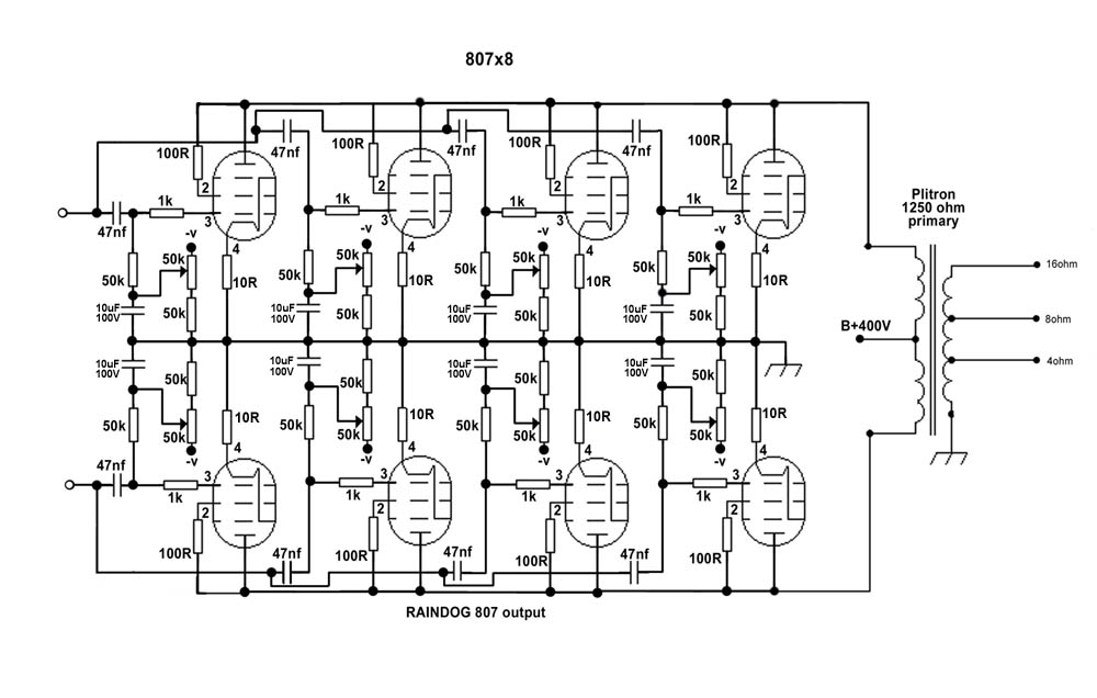

I thought about this while I was outside mowing my lawn, and then looked up a few things when I got back inside. It has been discussed a bit already and a new thread has been spun debating the advantages of the 814 VS the 828. I have a bunch of 828's so I thought about these and came to the conclusion that neither of these tubes would be good with these transformers. Both tubes have a maximum plate current of 150 mA. Both seem to like highish plate voltages and large (10 to 16K ohm) load impedances. The Plitron transformers have a 1250 ohm impedance and the maximum working voltage is not specified, but I wouldn't try to run them at 1KV+. I am sure that a load line could be plotted with a 500 to 600 volt B+ and a 1250 ohm load, but the 150 mA maximum will be the limiting factor. I even thought of bringing out the big boys, a pair of 813's, but these have the same issues. I am not familiar with the GU-50.
It was stated that these transformers were intended for a 400 watt Marshall bass guitar amp. If that is true, then they were probably intended for use with 6 or 8 KT88's at 500 to 600 volts. Therefore this would be the easiest path to that monster amp. If 400 watts are not needed, and HiFi operation is more important than sheer power, 8X 807's doesn't sound too far fetched. Yes there will be some setup / matching / aging issues, but once they are overcome, the amp should work well and last forever. There are plenty of guitar amps out there that use 6 X KT88 to make 300 to 400 watts per channel. Other than the exploding early vintage Ampeg SVT's (6 X 6146's) they are pretty reliable.
I think that the setup / matching / aging issues would be worse in class A due to the higher dissipation. The imbalance problem associated with toroidal OPT's would be worse in class A. Some type of auto bias circuit might be a good idea.
The more I think about this, the more I think my first attempt will be screen driven class B sweep tubes. I'm thinking 4 X 6LW6's per channel. Plenty of reserve current handling capability, a good match for the 1250 ohm transformer, and the B+ voltage would be in the 500 to 600 volt range.
Now I suppose I could just wire up 6 X Electro Harmonix KT88's per channel, but I have done that before (about 15 years ago). I was intrigued by the results I got when I tried a pair of 6AV5's in screen drive about a year ago. The 6AV5's, which are smaller than a 6L6GC, were happy cranking out 80 watts which was limited by the OPT that I was using. The distortion was low without any feedback. I just got to try this again with a decent OPT.

That should work well. Its double what I've done with 2 pairs of EL34s in triode mode into a 1885 ohm Raa PAT4006 (VDV2100).
Driving them is going to be a real issue. Might I suggest cascode diff amp (6DJ8) ala Allen Wright PPC1 but at about 4 to 5mS per side (to get enough gain) buffered by White Cathode Followers to drive the estimated 800pF of Miller capacitance of 4 807s in parallel on each side.
Thats what I use as a front end on my amp (except Series Regulated HV using a Maida Reg in lieu of a shunt "Super Reg" and MOSFET Source Follower in lieu of White Cathode Follower) to drive the 500pF of 2 EL34 per side.
I recently repaired am AMPEG bass amp (SVT3 PRO) which used a white cathode follower to drive the input capacitance of 8 high power output MOSFETs - that would be a similar load (or worse). That amp had a -3dB point of > 50kHz at full power (450W into 4 Ohms).
Ian
P.S. Don't forget the bleeder resistors on the power supply caps when you get that far. Head shaped "dings" in the ceiling are considered "uncool".

A caution: sometimes large parallel arrays like this have stability issues because of the necessities of physical wiring. To overcome this, sometimes some extra resistance is inserted into the plate leads, sometimes some inductance. If you look at the schematic for the classic Marantz 9, you can see that the tubes farther away from the OPT are connected directly, whereas the closer tubes have small inductors in the plate leads.
To be safe, you might want to add a 47-100R 2W carbon comp resistor at each plate.
Miles Prower said:Also, 807s require plate stoppers. These can sometimes be simply 100R resistors connected to the plate connectors. For that, I prefer the RF-style plate stoppers that consist of 10 (space wound) turns of #18 wire, D= 7/16ths inch, with the 100R/2W de-Q-ing resistor mounted inside the coils. That way, the coils represent a significant impedance at RF, but have no effect on AF operation.
SY said:A caution: sometimes large parallel arrays like this have stability issues because of the necessities of physical wiring. To overcome this, sometimes some extra resistance is inserted into the plate leads, sometimes some inductance. If you look at the schematic for the classic Marantz 9, you can see that the tubes farther away from the OPT are connected directly, whereas the closer tubes have small inductors in the plate leads. To be safe, you might want to add a 47-100R 2W carbon comp resistor at each plate.

Correct me if I am wrong, but I believe that your design intention is to use fixed bias and as such the 680 unbypassed cathode resistors are not required, and have some undesirable effects. By themselves they would provide cathode bias, unbypassed however they increase the Rp by ~ Rc *(mu+1) - not what you want here I suspect.
Some combination of fixed and cathode bias is sometimes done, but good large value bypass caps aren't that cheap. Were it me I would go with pure fixed bias and replace the 680 ohm cathode resistors with 10 ohm resistors to permit measurement of the individual cathode currents. (Bring them out to the top of the chassis using pin jacks or similar, mount the pots through the top plate as well to make bias adjustment easy.)
Cmiller will be large, and each half of the driver stage must comfortably drive the combined (thevenin) resistance of the bias circuitry which at ~ 12K is quite low.

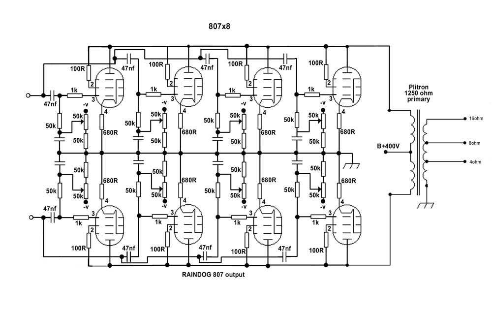

kevinkr said:Correct me if I am wrong, but I believe that your design intention is to use fixed bias and as such the 680 unbypassed cathode resistors are not required, and have some undesirable effects. By themselves they would provide cathode bias, unbypassed however they increase the Rp by ~ Rc *(mu+1) - not what you want here I suspect.
Yes, I was wrong. Thank you for pointing it out. I have made note of your comments regarding the 680 ohm resistor and made adjustment to 10ohm. Please review and advise? I'm not so clear on your other comments.

You are driving 8 triodes instead of the usual two pentodes. Triodes (and triode wired pentodes) have a larger input capacitance than a pentode. You have 4 in parallel on each side. The customary phase splitter as a driver design will not work here. You will need to add a cathode (or mosfet) follower between the phase splitter and the output stage.
I included the schematic of the power amp section of a 300 watt bass guitar amp. Note the two stage amplifier between the phase splitter and the output tubes. This amp uses 6X 6550's in pentode mode. You will be driving even more capacitance than this design.
jane said:Shawn,
The 50k/47n RC will give you a roll off frequency at 68Hz, isn't that a bit high?
Jan E
Quite so, I thought for some reason they were 470nF - I'd recommend 220nF and I would probably change those 50K resistors to 100K which will help with the loading issue on the driver stage, and push the -3dB corner down to about 8Hz. Note this will not help with cmiller so a fairly robust driver stage is still required for good HF response.

I generally do not use nanofarad caps in my tube amps. Microfarad caps sound reliably better (because for this old fart the chance of putting in the wrong value is 1000% less).
