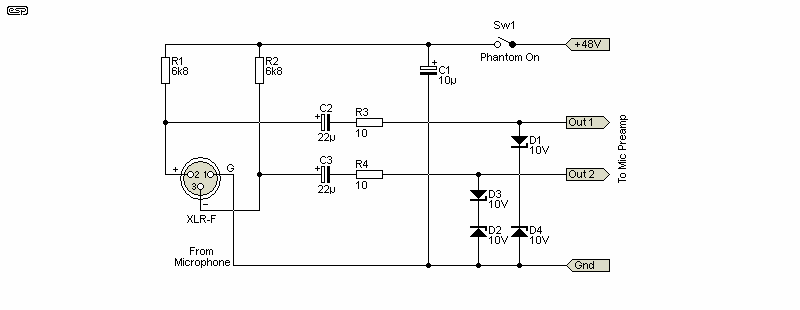

Have a look at rod elliott's article regarding phantom power:
https://sound-au.com/articles/p-48.htm

That is helpful, thank you very much. EU and USA standard differ in the "hot" and "cold" connection. Since I have a balanced input that does not matter in the least for audio or AC. Except for the phase but that is not relevant.
But I wanted to be sure how to connect the phantom power. According to this schematic both signal wires receive positive DC voltage.
Which was not obvious to me at all.

pin 2 hot and pin 3 cold is the standard everywhere now...
Not having the phantom-power symmetrical would cause speakers and amplifiers to literally blow up whenever mics were switched on and off!! As it is you get pretty loud thumps due to imperfect symmetry.
