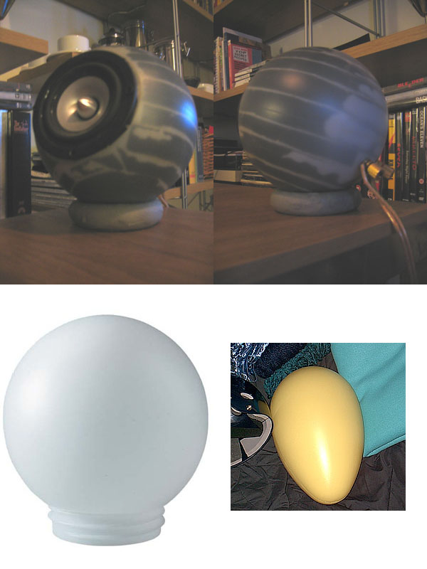

I've done something similar once for the enclosure for mine tb 871s. They're not quite finished yet, but sounds pretty nice for their size. I used some lamp things (dont know the english word for these, but the picture explains it). The inside is covered with the thick and dead dampening material used to dampen cars, bitumen/asphalt mats (http://www.noisetek.fi/barriers.htm). You can seem them through the clear palstic enclosure. The lamp enclosure is 1.65 litres without the dampening material.
Maybe you can try to use those giant plastic easter eggs (couple of dollars propably) and cover the insides with bitumen?
