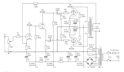

Try the Stoetkit
I heard good stories about it. Perhaps you can use that ECL82 schematic (or change tubes, ecl82/6bm8 is not so expensive).
The Stoetkit is a push pull design, which means you would need different output transformers and power transformer (one pair of extra ECL86 tubes), which are quite expensive.

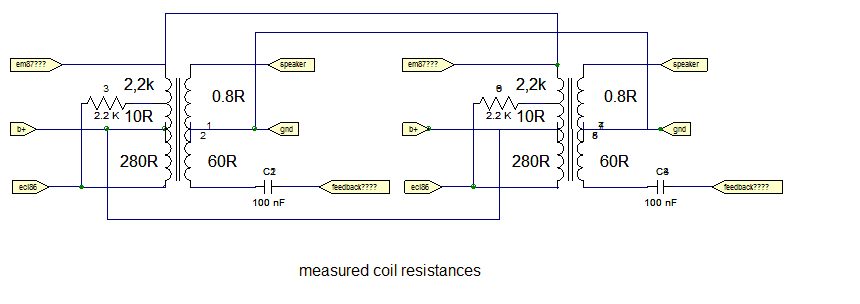

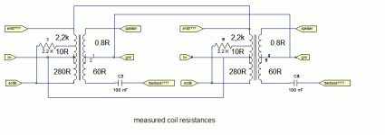

wanted to salvage the tranny's
so i measured them to see the connections..
got some results that seem awkward to me. on the tranny there are a resistor and a capacitor
i made a quick pic of the results. any thoughts? especially the 2.2k measure seems really odd (it had an em87 output indicator! the leads seem to go to that part of the radio)
