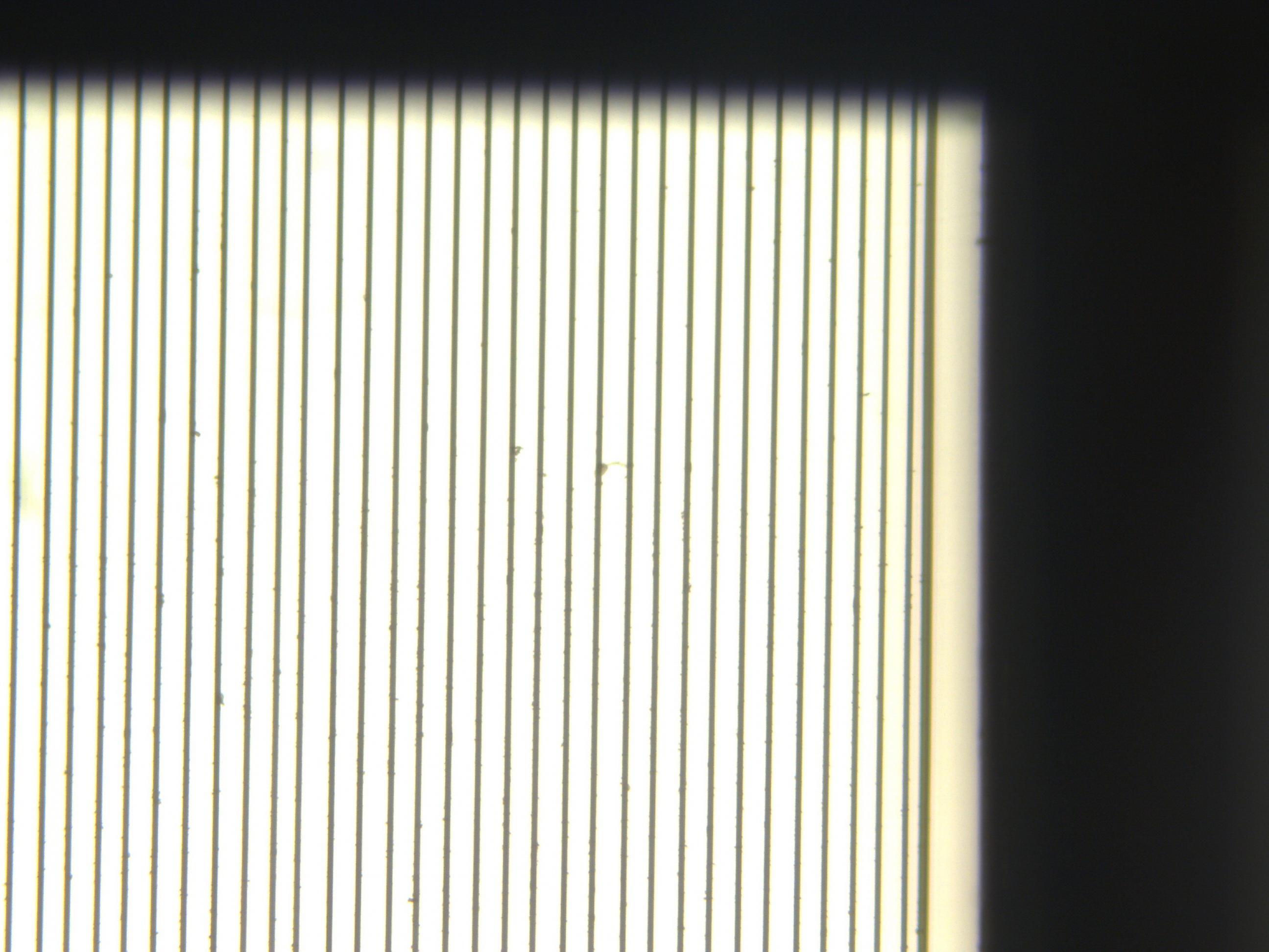

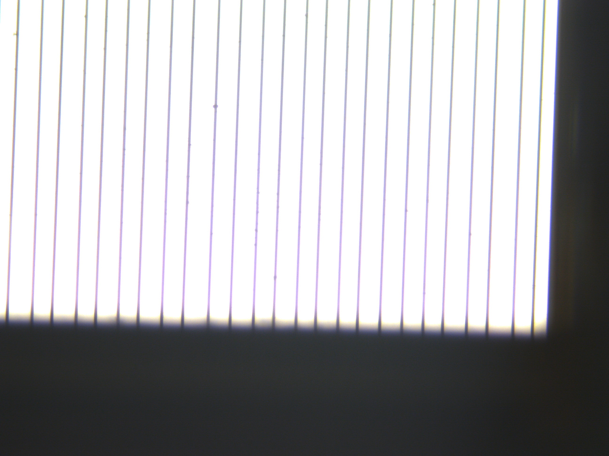

Maybe these pictures of ecc88 and ecc89 grids could be interesting to see.
I ve made it on Leica microscope magnification 40X.
ECC189 have closer spaced grid wire winding ,i guess for amplification
of weaker signals .Removing frame grids without damage from tubes was
very tricky.
The photos do not show more than a small slice. I can assure you that I have used both types for about 40 years and in fairly large quantities. The PCC or ECC189 vari mu I use in my compressors and I use both sections as they are identical. The grid wind varies at about every couple of mm. Such that at bias volts of about minus 1 volt the gain is nearly that of the 88 version but by the time you have minus 8 volts the mu has droped to about a hundredth. As a cathode follower it is not quite as linear as the 88. However, for many audio purposes with low grid cathode volts it will work adequately. I have had some batches in the past that were incorrectly labeled. That is they were 88 in disguise.
A transfer curve vs neg grid volts shows that quickly. The grid spacing will vary about 2:1. On the machines I saw at EI the winder did about 4 turns then pitch changed and another 4 turns and more pitch changes with a stepped cam. Not perfect hence variations in individual valves. I have to go through lots to get several pairs.
So please get more photos to cover the whole length.
