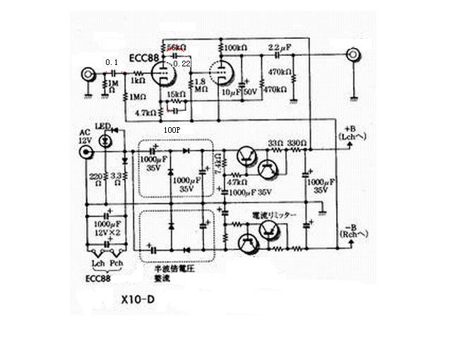

MF-X10-D schem.
Hi!
I know only this schem of MF-X10-D, but I am not sure is it real...
Check it.
Greets:
Tyimo

Hey Tyimo,
Yes, I have that schematic too. It's good. A few of the values are different. But not much.
The 12V does come from outside, I just used a 12V 1A transfo that was handy. There is no transformer onboard, it is all stepped up via doubling (guess).
The big caps are at only rated at 35V, not much margin there. I'll try to get a value on all the componants and some voltages around the board.

Hi
There are two voltage doublers on the output from the wal wart.
One gives approx +24 volts, and the other -24 volts, so the tube has 48 volts to play with effectively.
The 35 volt caps are ok, as this gives a margin of nearly 50%, which is pretty good.
Hope that this helps.

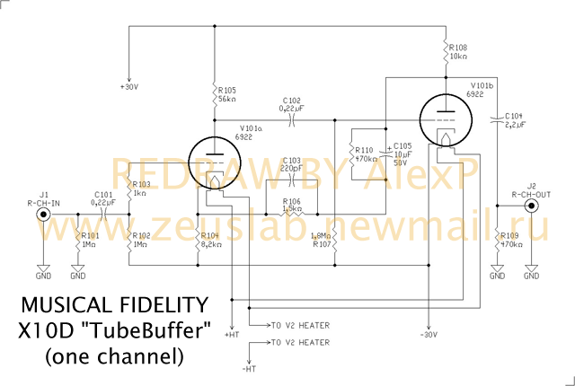

Here is another version of the schematics (signal section only). It gives the same values as the previous one, except for C101, C103, R104 and R108. I guess someone will have to check on the actual PCB which is very readable.
I can't comment on the quality of this design but I must say that the quality of the parts leaves to desire... you find in there cheap caps, resistors and rectifiers and with a little work you replace these (as well as the wall plug) and enjoy a much more define and dynamic sound. At least, it's what I've done with the MF XPRE which is an equivallent in terms of design and now it sings!
