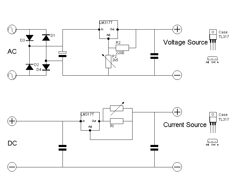

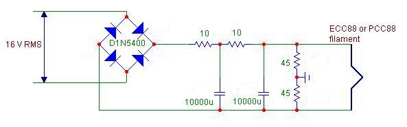

Hi
I utilize the following simple circuit to provide the correct
DC voltage to the filament of both ECC88 and
PCC88. In this way I can exchange the tube and they
will always receive the appropriate voltage.
Federico
