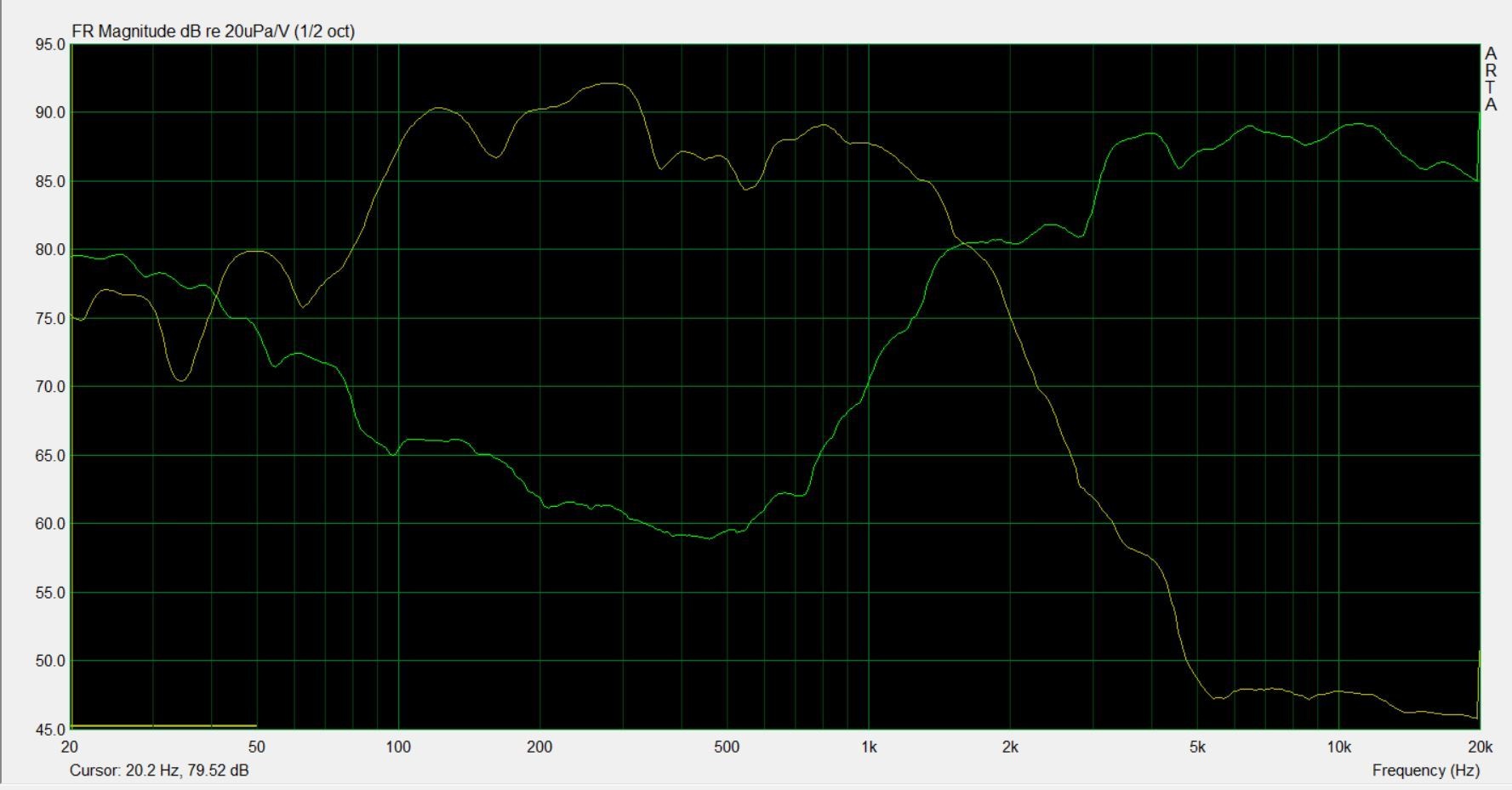

This is the result of my first measurement using the dsp. Its based on the
following commands
Filters are:
Example copied from Richard Taylors tutorial
I test this by offering a testsignal generated by Arta on a separate PC via an additional Tascam soundcard to the Line in. The filtered output of the woofer and the tweater are send to an amplifier and a broadband speaker. The measurement microphone is connected to the Tascam that is read by Arta. This gives the picture below.
The result is as expected. 4th order filters at 1500 hz. I wil do some more experiments and see if I can improve the respons of this broadband speaker.
following commands
