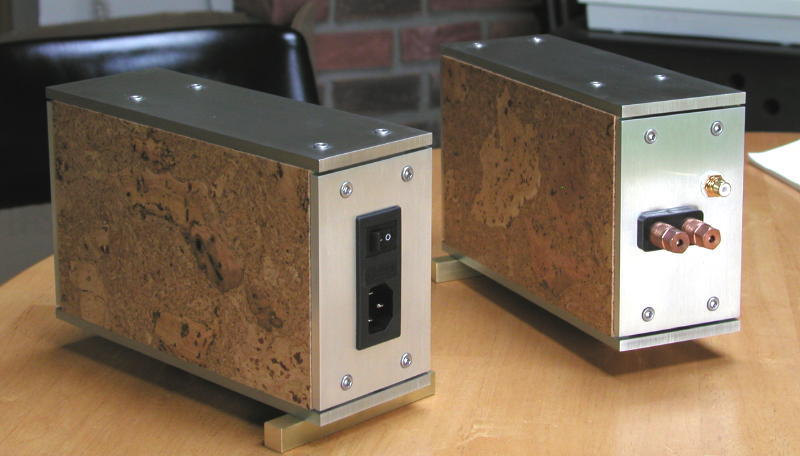

When done properly, alodine is not really gold. It has goldish shine, but it's very subtle and is more like currently popular champaine finish on some Japanese high end equipment, which can be really appealing.
Also, the surface of the metal doesn't show the additional protective layer (like anodizing). It can be good and bad. It's nice, because metal is still in it's natural state (sort of like using sealer on wood, but not laquer), but it's completely not resistant to scratches.
I like it on my monoblocks, and whoever saw it, likes it too, but I guess it's a matter of taste as well.
If you want less of gold finish, after alodining you can brush it again (with Scotch Brite pads) and virtualy remove all gold residue, but still leaving the protective finish. It almost looks like matte finish, but slightly warmer than raw aluminum.

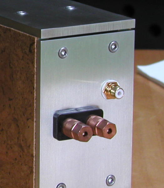

Here's one more close up of how gold compares to pale alodine finish. By brushing it off you will achieve even lighter color. It all also depends on the solution and how strong it's made.
Recently, we orderd powder alodine from this place http://www.airtechcoatings.com/index.html and you could ask them about safety issues. So far I didn't dispose any of it as it's in constant use.
If you never alodined anything, use a scrap piece before. One local forum member was alodining last week, but it seem like his liquid solution was too strong and he was not that happy with the finish (too dark and not uniform). But he managed to brush it off almost completely. Still, you can tell the metal is protected somehow.
