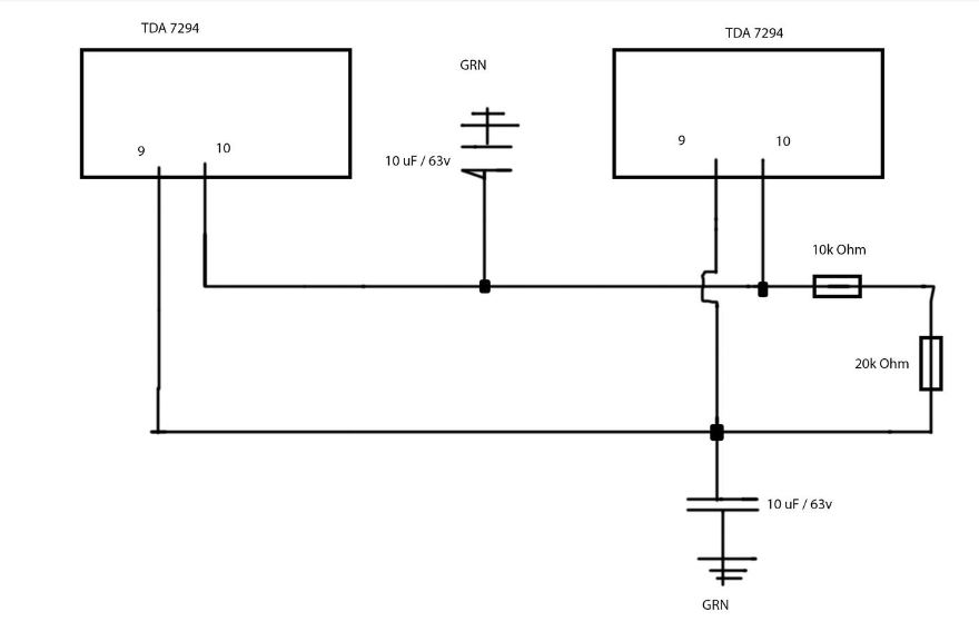

Hey guys,
After some diagnostics with my friend, he concluded that one of regulators that is providing Vcc +/- 18v on board is dead, (-18v works fine, positive is broken) and he told me to wire two bridge TDA7294 chips to "manually" activate them. He drew me a little schematic, but im not sure if its right, maybe i miss draw something.
If you could guys check it out and provide some feedback, that would be awesome, and i can start with soldering
P.S. shematic is super bad, i dont have any drawing software, used photoshop

So, those two resistors shouldn't be connected at all ? If you could please elaborate on my schematic ? I fairly new to this and its bit hard to follow what goes whereIt should look like this. Look at pins 9 and 10.
Yes, i looked at data sheet, but to be honest, it is only confusing me more.

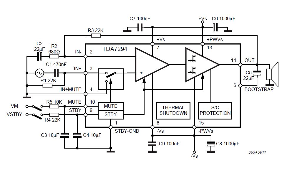

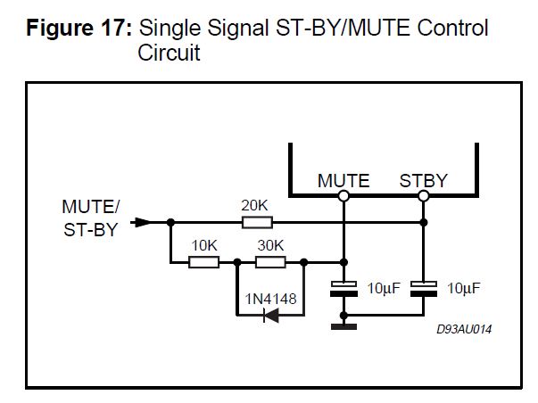

Your schematic is incomplete. For the chip to operate both pins need to be taken to the positive supply voltage via the resistors shown. A 10k for pin 10 and a 20k for pin 9. So the junction of the two resistors in your diagram should go to the positive rail. That turns both mute and standby functions on and off together (not ideal).
The best solution is in the data sheet as shown here. This gives much better sequencing of the two signals during power on and off.

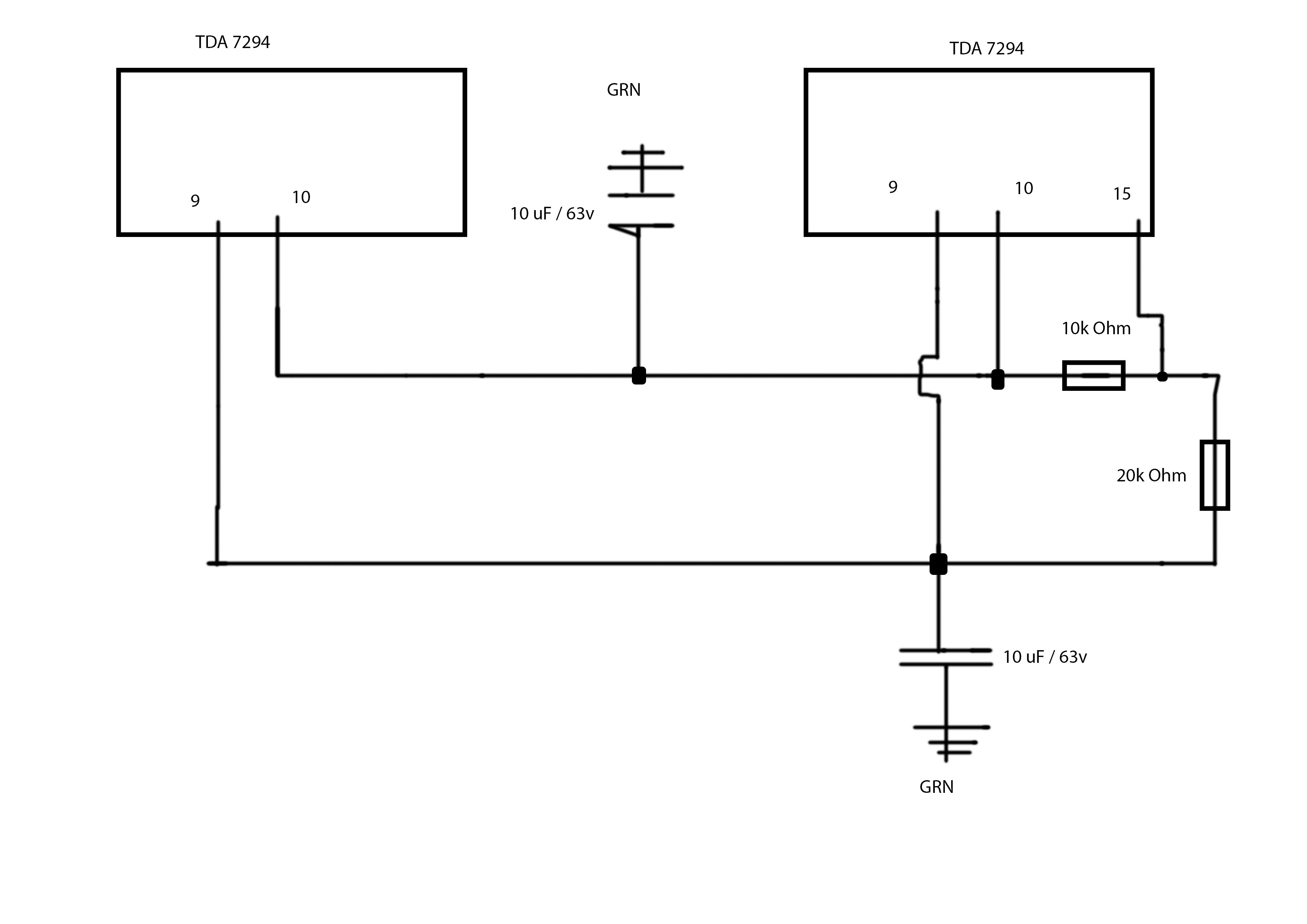

Pin 15 is the negative supply (or ground in a single rail application). That's no good.

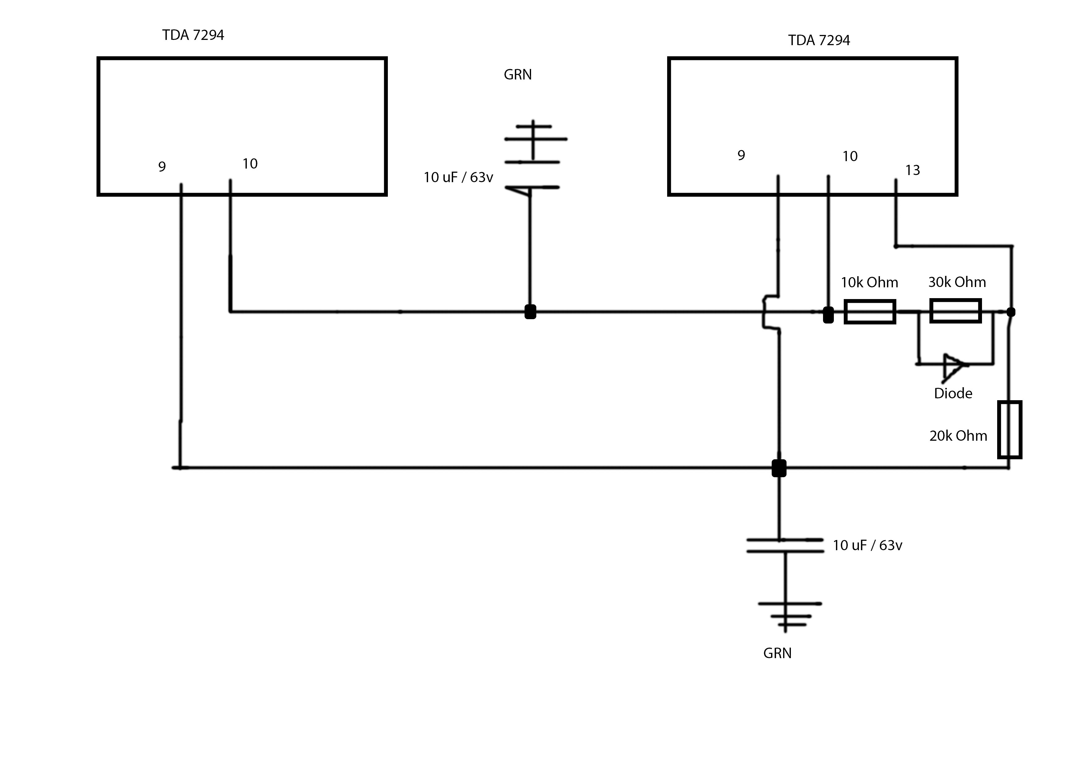

It needs to go to pins 7 and/or 13 which are the positive supply pins but remember this is not ideal and not the recommended way to do it. For the sake of one extra resistor and one extra diode you should do as the manufacturer recommends.
That looks OK. The data sheet recommends 22uF caps which will give a little longer delay.
